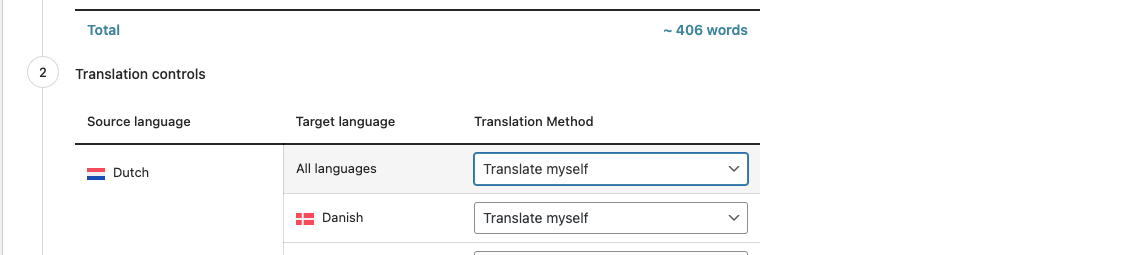

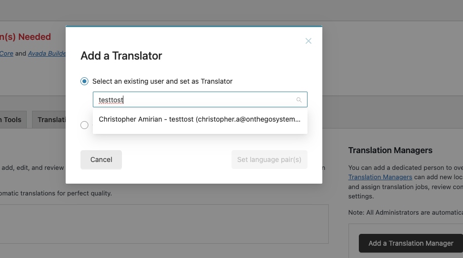

Thank you for the login information. I checked and it seems that your user has a specific kind of permissions or capabilities that are not WordPress default.I tested by adding a new user with my email and selected Administrator as the role.
I managed to add myself with no issues as a Danish translator and while checking the translation management it allowed me to translate Danish.
This shows that there is some sort of manipulation happening for your user which I am not sure what it is that causes WPML not to detect that specific user.
