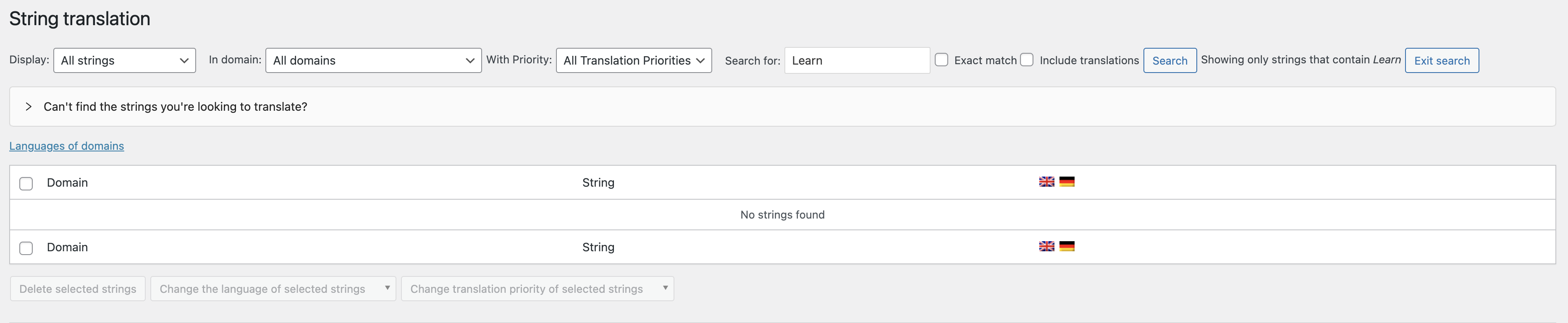

Hello Mohamed and thanks for getting back to me. The text is in the parent theme, but I could not find it there after scanning the strings in the theme. Is there any way I can simply add code to the php file?
I used to use this code:
<?php _e ('English'?>
<?php _de ('German'?>
but that breaks my site...?
Thanks!

September 20, 2023 at 6:39 pm #14432981
Mohamed Sayed
Please note that debugging the custom code is out of the scope of our support, but I will try to point you in the right direction.
In order to output different code based on the language, using the "wpml_current_language" hook might help. Please check the following links for more details:
- https://wpml.org/wpml-hook/wpml_current_language/
- hidden link
So you can try something like the following:
$my_current_lang = apply_filters( 'wpml_current_language', NULL );
if($my_current_lang=='en'){
 // Add the code outputs the English text
	} else {
  // Add the code outputs the German text

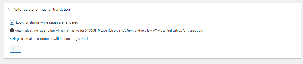

I would also suggest trying the following steps to translate the text with String Translation:
- Go to WPML String Translation
- Scroll down to the "Auto register strings for translation" section and enable that option
- Visit the page where the string is added on the front end
- Go back to String translation and disable the auto register option
- Search again for the string and translate it

September 21, 2023 at 6:04 am #14434597
Elisabeth
Hi Mohamed, I solved it by using the auto register strings for translation, thank you again for your support and have a great day 🙂
