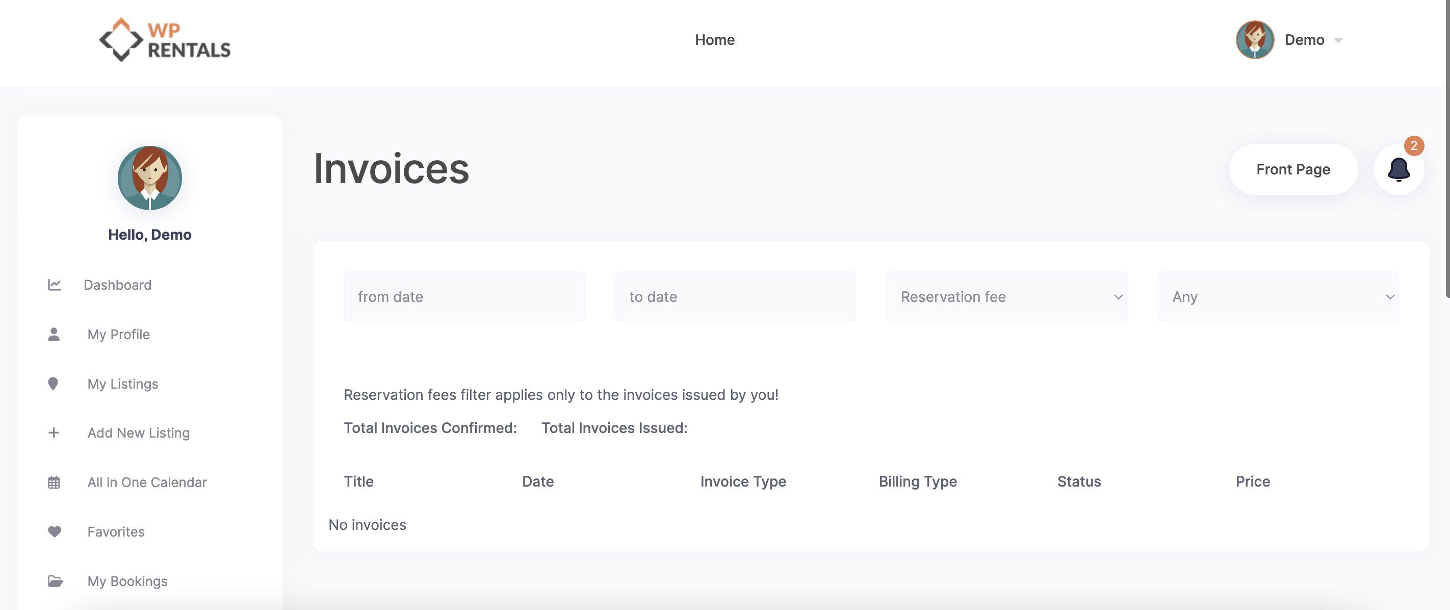

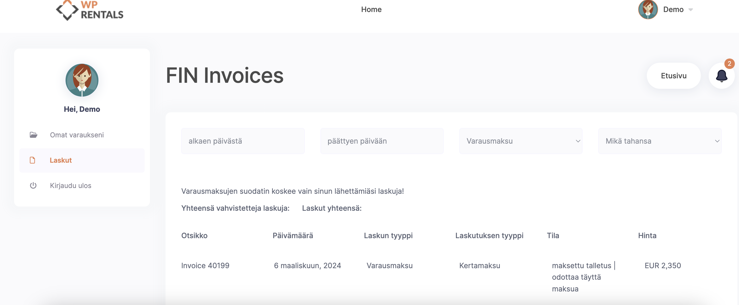

I am developing and setting up WP Rentals theme with WPML.
I ran into issues for the invoices. If i switch the language on frontend then I dont see the invoice in one language, if i switch back then i will see it.

March 6, 2024 at 11:15 pm #15381752
aimarL
I set up wp rentlals and configured wpml accrdingly to their documentation wpml team gave at hidden link
I was able to recreate the same issue on the WPML test site.
Please log in with the user and navigate to invoices page. If you switch to english language, then you dont see the invoice. Other pages worked in both language, for example: /my-bookings/
The "My Bookings" and "Invoices" page was translated to Finnish with DUPLICATE option.
finnish: hidden link
english: hidden link (ISSUE)
username: newuser
password: Newpassword123
