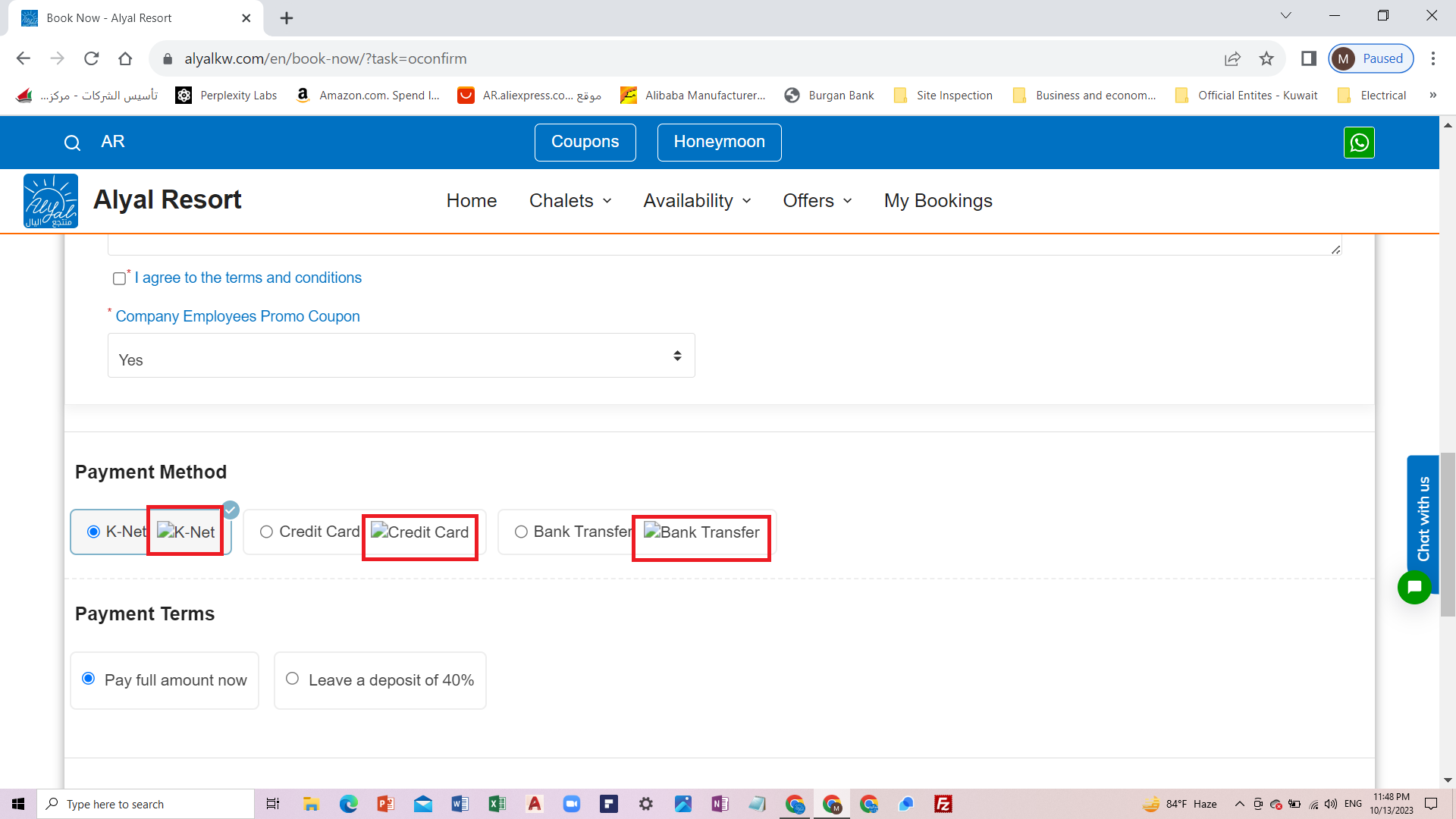

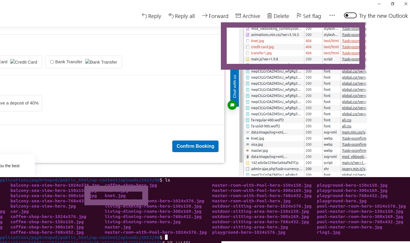

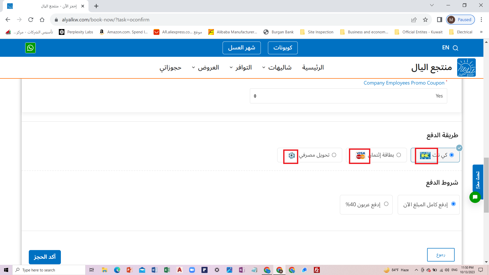

THere is one page with Payment Options, these options have images. The Images show in default language Arabic page but do not show in English page.
Contacted both Plugin author and the host and both identified the issue is due to WPML. It seems prefix "e" is added in the images path.
Plugin Response:
"the routing functions since when relative paths are used the /en/ (for the English language) is prefixed. This means that the base path is being overridden. Your base path should be your domain name (www.example.com), without any adding (in your case /en/ is being added for the English language, so your base path is hidden link)."
See Attachments
Regards
