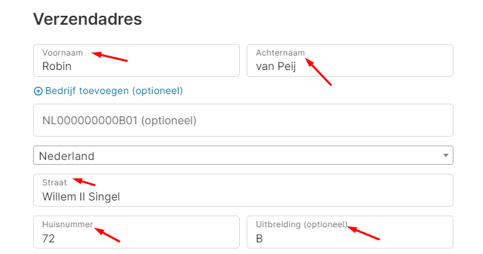

On the checkout page fields are not translated like First name, Last name, etc.
we need to translate this automatically. I tried various settings on the plugin but not work.
Please do the needful on this and fix the issue

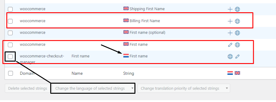

Here as per your info, i have tried but still it does not work and in checkout, the first name, last name, and other fields is not translated yet
April 22, 2024 at 7:46 am #15548418
Noman
WPML Supporter since 06/2016
Thanks for trying the above steps and sharing the screenshot. In your screenshot, It seems the wrong source language is assigned to the string that is coming from WooCommerce Checkout Manager.
You can easily change the source language of the strings that you see in the string translation by following the below steps:
1. Please go to WPML >> String Translation page.
2. Select all strings that have wrong language assigned.
3. Choose the English language from the “Change the language of selected strings” dropdown as you can see in the attached screenshot.
Here is a doc for more details:
https://wpml.org/documentation/getting-started-guide/string-translation/how-to-change-the-source-language-of-strings/

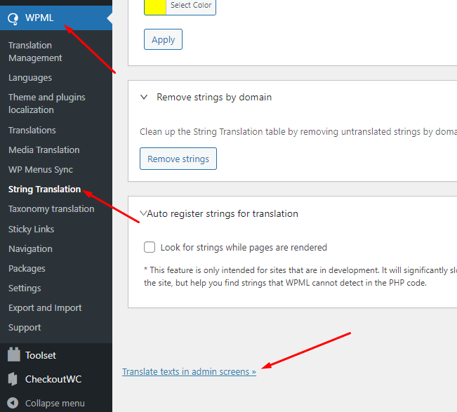

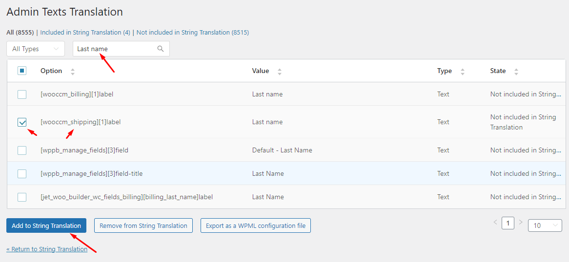

Thanks for sharing the login details. I’ve noticed that these labels were the admin strings that is added from WooCommerce >> Settings > Checkout > Shipping page. To translate the admin strings we first need to enable it’s translation from WPML >> String Translation > Translate texts in admin screens » link at the bottom of the page as you can see in the attached screenshot.
Or we can use the XML code in WPML >> Settings > Custom XML Configuration to enable it’s translation directly without enabling it from Admin Texts Translation page: hidden link page. So, I’ve followed the below steps:
1. Added the below XML code in WPML >> Settings > Custom XML Configuration section:
<wpml-config>
  <admin-texts>
    <key name="wooccm_shipping">
      <key name="*">
        <key name="label"/>
      </key>
    </key>
  </admin-texts>
</wpml-config>
2. Went to WPML >> String Translation assigned the English language to those strings.
3. Added the translation and now it seems to be working correctly. Could you please check and confirm?
You can update the translation from here if needed: hidden link
Thank you for your cooperation and patience
