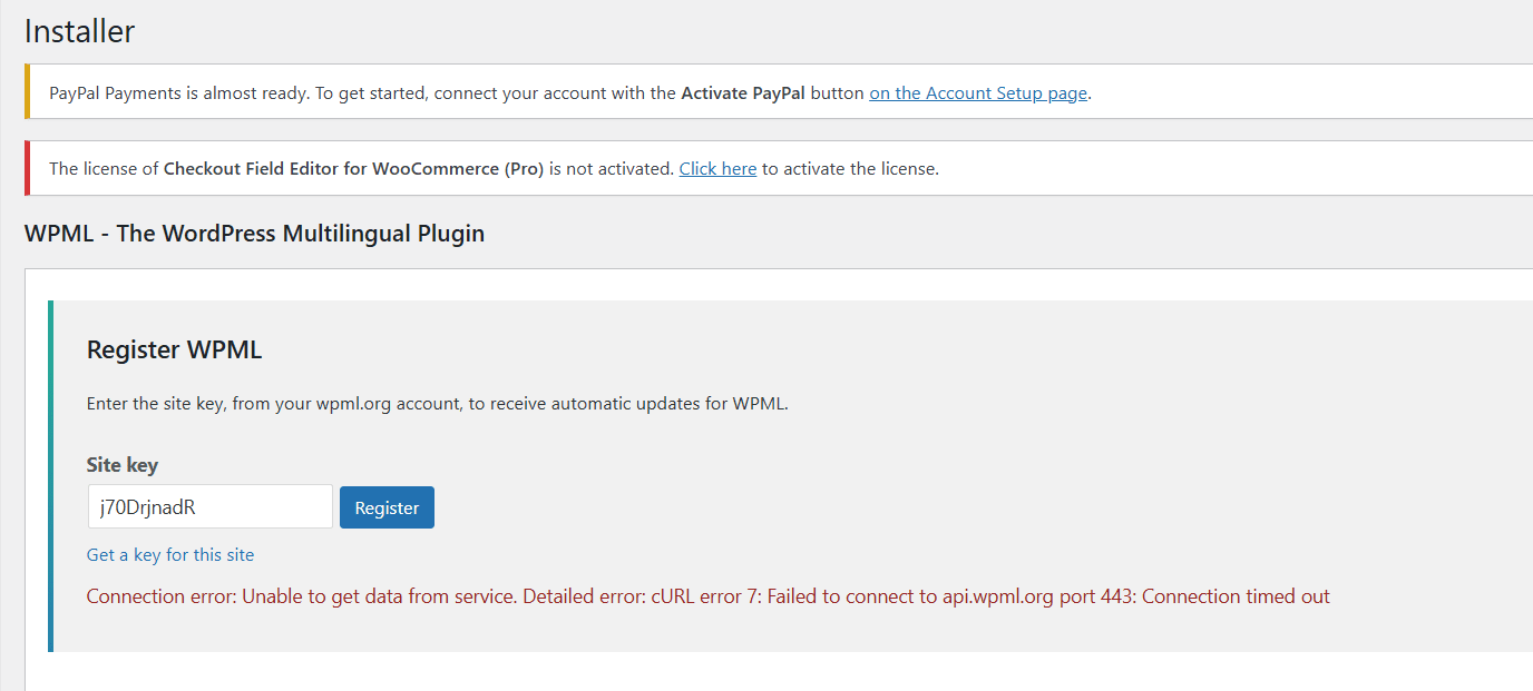

plugins were installed manually and we get the output in the image

I've reviewed the installer log, and it shows the following error:
wpml: Connection error: Unable to get data from service. Detailed error: cURL error 7: Failed to connect to api.wpml.org port 443: Connection timed out
This indicates WPML is unable to connect to its API server. Our documentation suggests this is often caused by a firewall blocking the connection.

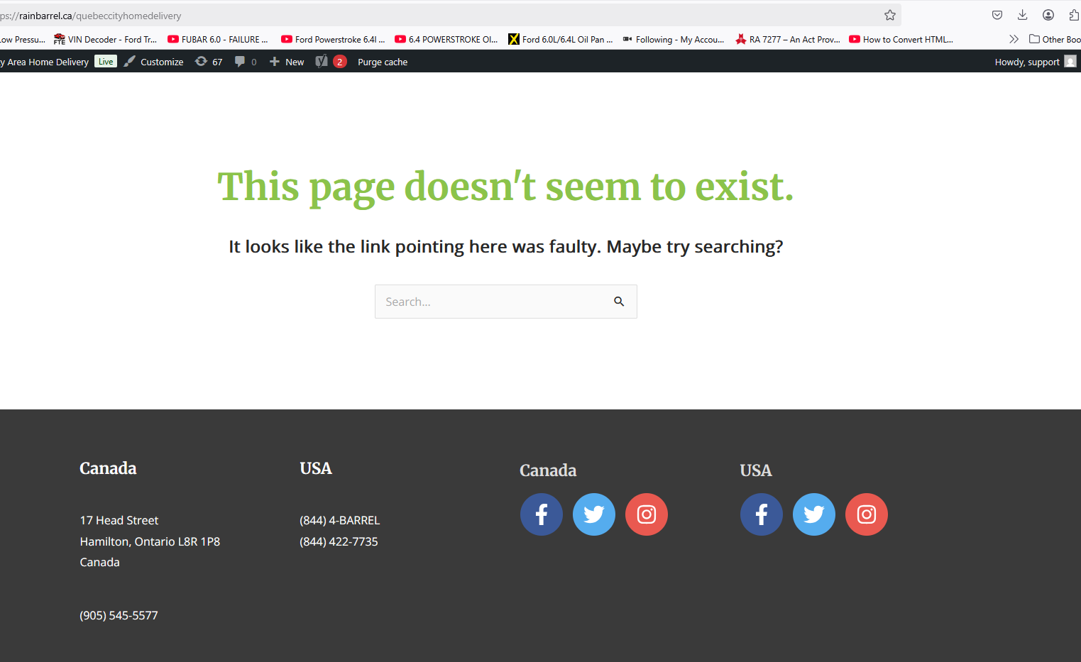

Regarding this URL:
hidden link – it returns a 404 even when WPML is not active, so it doesn’t appear to be related to WPML.

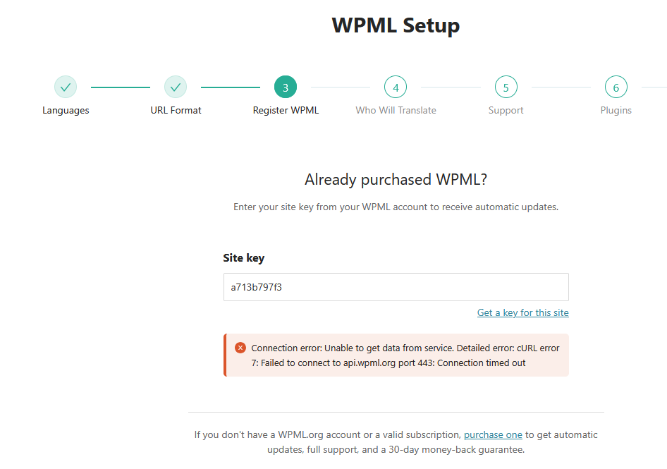

We are still having issues registering as is shown in the attached file.
your API server refuses to connect to our server and we get the CURL error displayed

I manually installed the plugins and registered a subdomain as follows:
whenever I try to register the curl error is displayed. It indicates the api server is rejecting requests.
I have had 4 support professionals look at this and they all conclude that the api server is denying access. We cannot get past registration.

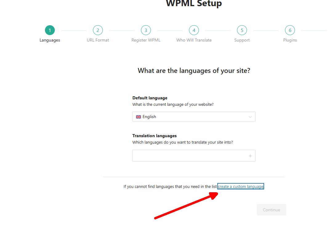

Also I did note that when setting up the French language, there was no choice for French Canadian. I would hope that we can select this once we get past the registration process

As for the French Canadian, you can add it later but also during the wizard itself, in the first step.
https://wpml.org/documentation/getting-started-guide/language-setup/editing-wpmls-languages-table/#add-custom-languages
