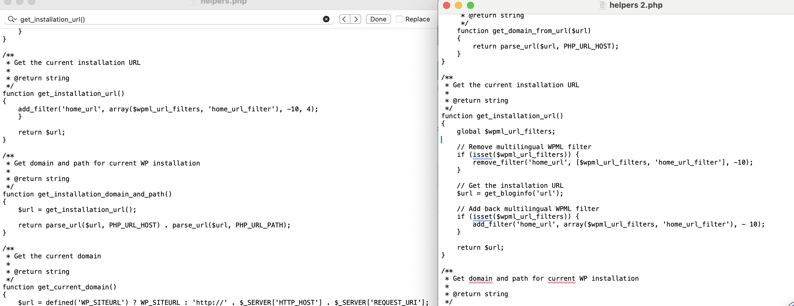

Hi, Thanks for this.
I replaced the code (see left side version on the screenshot)
This caused fatal error on frontend and backend of site.
Either this was not how it is supposed to be replaced, or it didn't work. Please let me know.
The sales support before I purchased said they didn't know if it worked with OP or not but that it can work with any/all builders in some way. If it is just not compatible, I may need to try a different plugin, support at OP is quite slow, i don't know if they will implement this fix quickly or not.
December 6, 2024 at 10:30 am #16485413
Bruno Kos
I added
add_filter('home_url', array($wpml_url_filters, 'home_url_filter'), - 10, 4);
to both filters but I don't see the fatal error even after browsing for a while.
If it shows up for you again, can you send a error log again? If it shows it should say something different, another error message.
