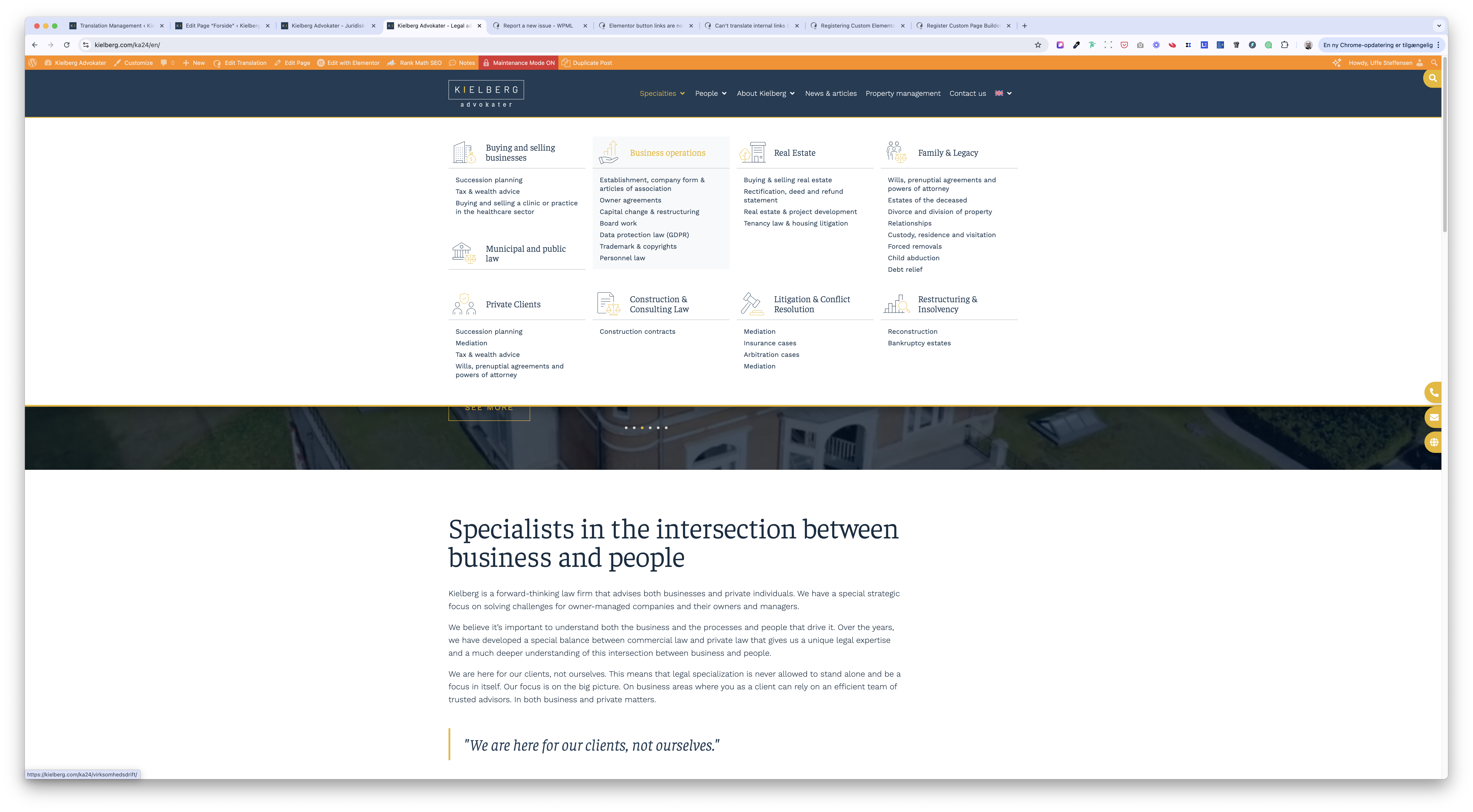

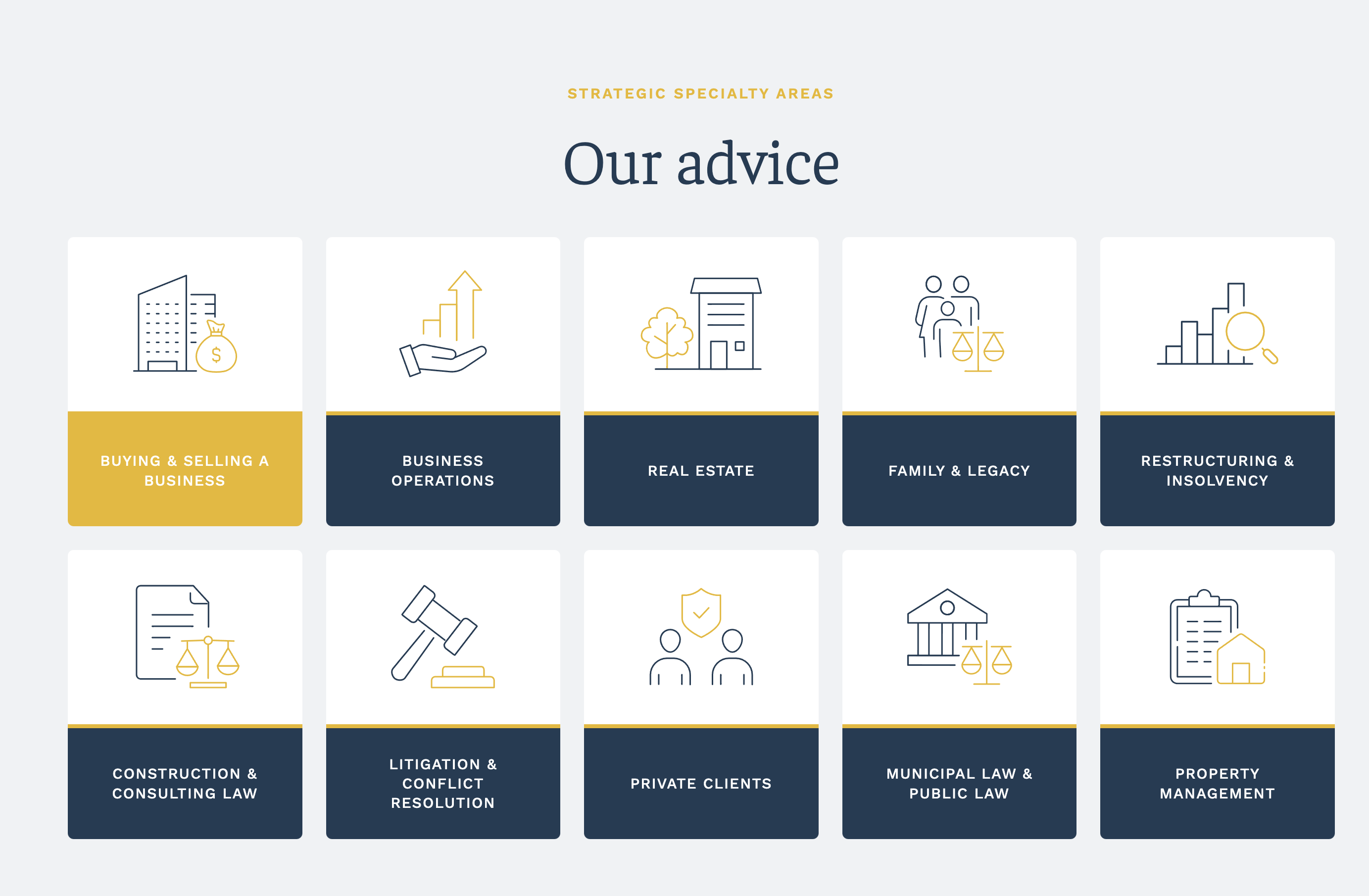

I am trying to translate a website from Danish to English using the 'Translate Everything Automatically' settings on the whole website. The issue can be seen on this page: hidden link
Internal Elementor links/URLs have not been translated to the English page and still link to the original Danish page. The text has been translated correctly, but the elements from Elementor are not translated. Additionally, there is an issue with some text that I can't find how to change. On some pages, there is a back link that says 'Back to top' instead of just 'Back'.
Why are the internal Elementor links/URLs not translated to the English page?
How can I change the text of the back link from 'Back to top' to 'Back'?
