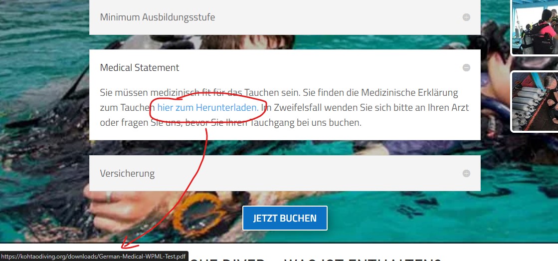

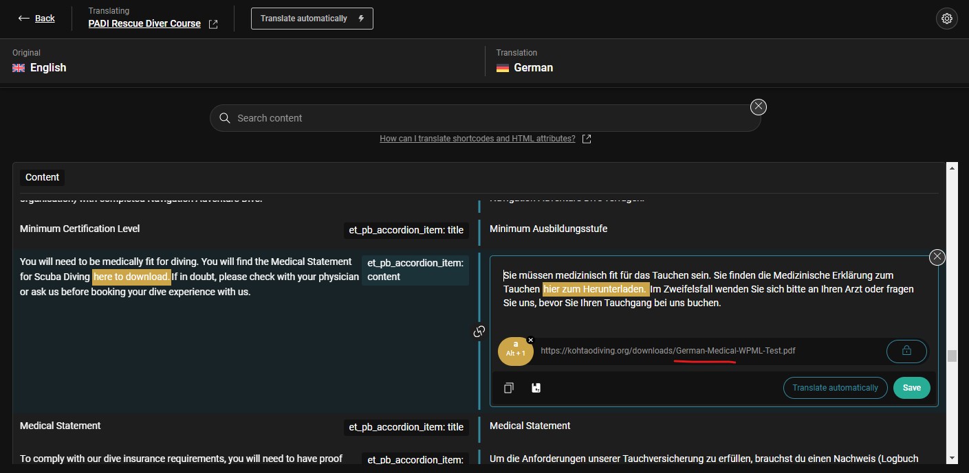

At first, I noticed that the link to PDF in "Medical Statement" in Pedi Rescue Diver page in German (hidden link) was pointing to the English version. So I just clicked "Edit Translation" and in ATE it was showing the correct German PDF links (see attached).
After only clicking, "Save" for that part of translation, I clicked complete translation and then checked the German page again. It is referring to the German PDF (see the other screenshot attached).
I then tried to observe more about the issue but apparently it seems to work fine. I also checked and discussed in lines of "deleting the section and rebuilding". But unfortunately there's no apparent way of preventing it and fixing it, other than to rebuild it.
