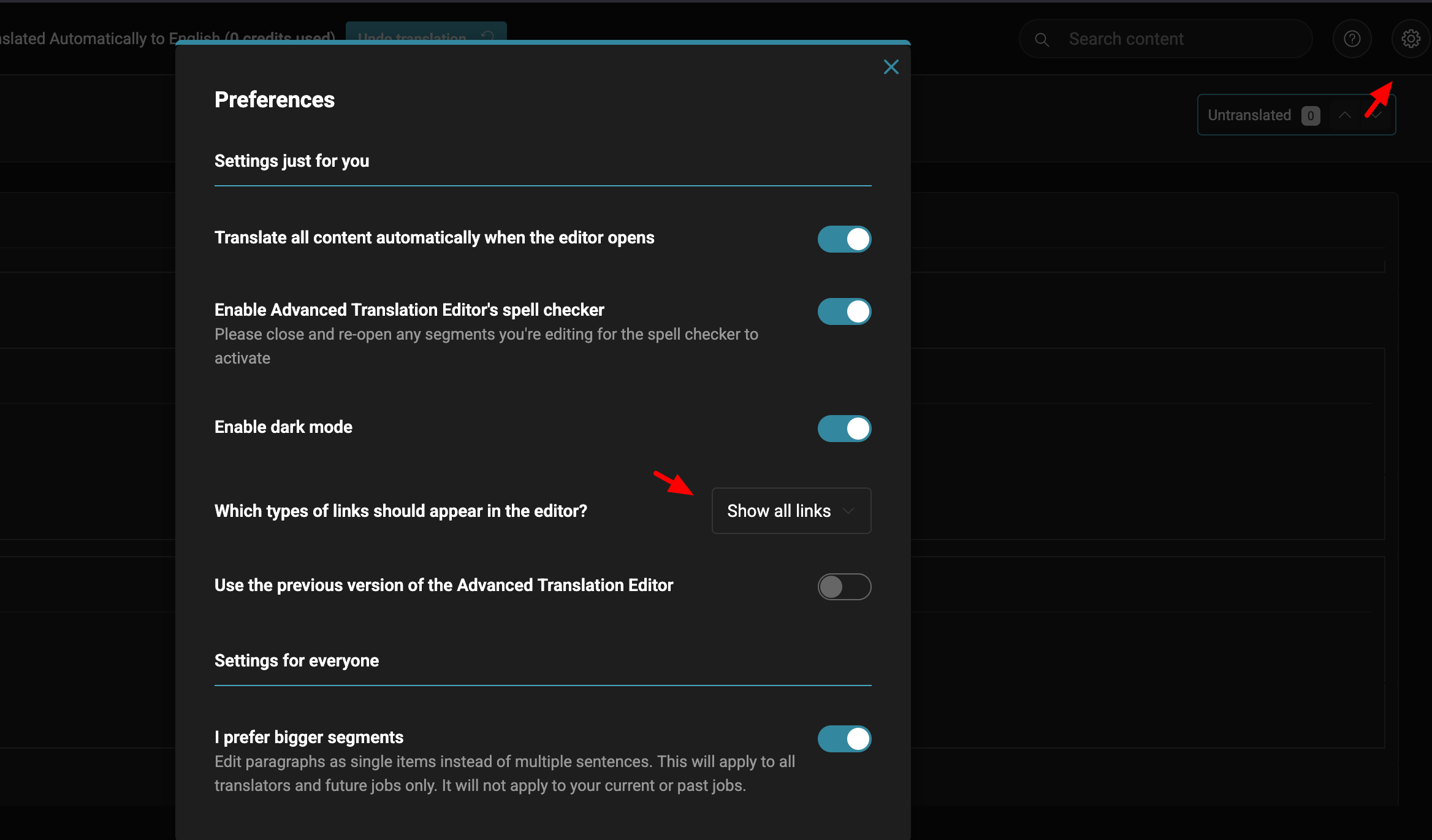

Here’s what I did:
1. Opened the page in the Advanced Translation Editor, clicked on Settings, and enabled the option to show all links.
2. Made a small change to the original page and saved it (then reverted the change). This action triggered an update in the translation editor.
3. Returned to the translation editor, where the changes were now visible.
I have attached the screenshots for your review.

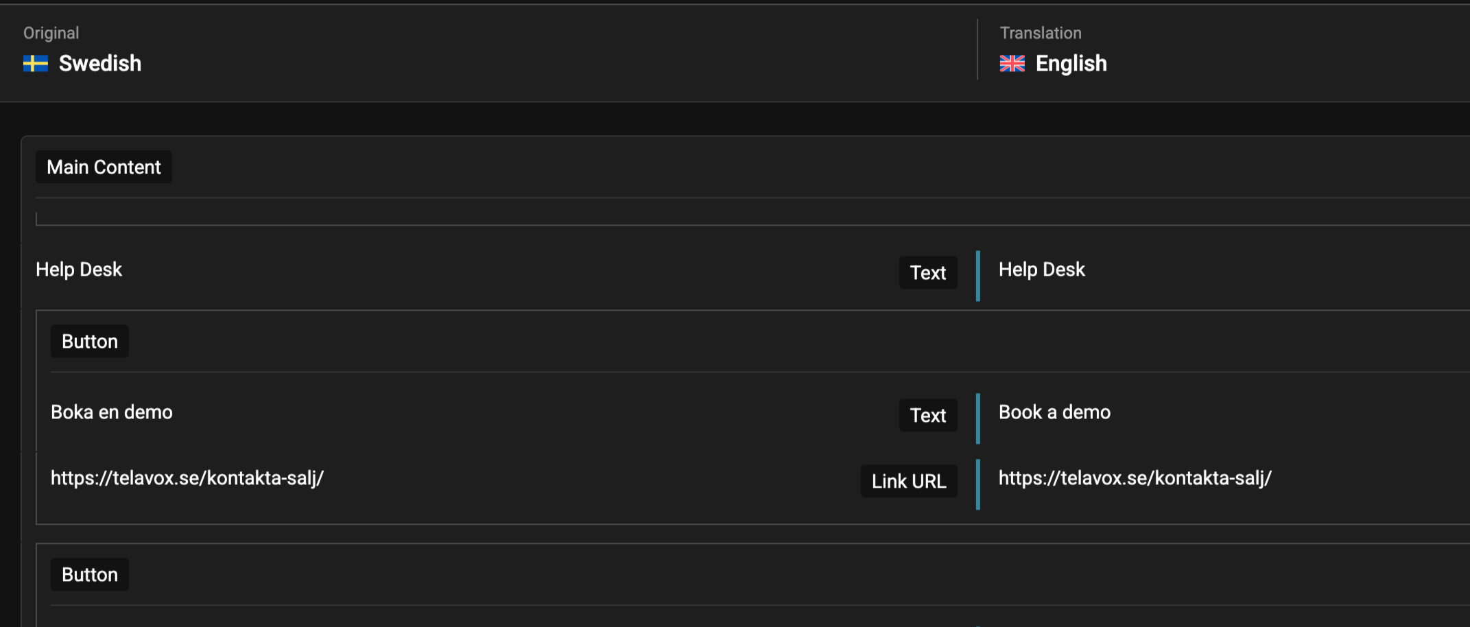

June 5, 2025 at 7:12 am #17108736
alexanderB-133
I can see that the links are visible there now. But shouldnt the links be automatically updated? Or do I manually have to find, copy & paste the translated links in tho the Advanced Translation Editor?

We're checking this and will handle it in future releases for some Elementor widgets to convert the links automatically. In the meantime, you can translate them manually in the Advanced Translation Editor.
I am not able to directly access the link you provided, but you can try the following steps from this reply: https://wpml.org/forums/topic/internal-links-not-translated-2/#post-17107969
