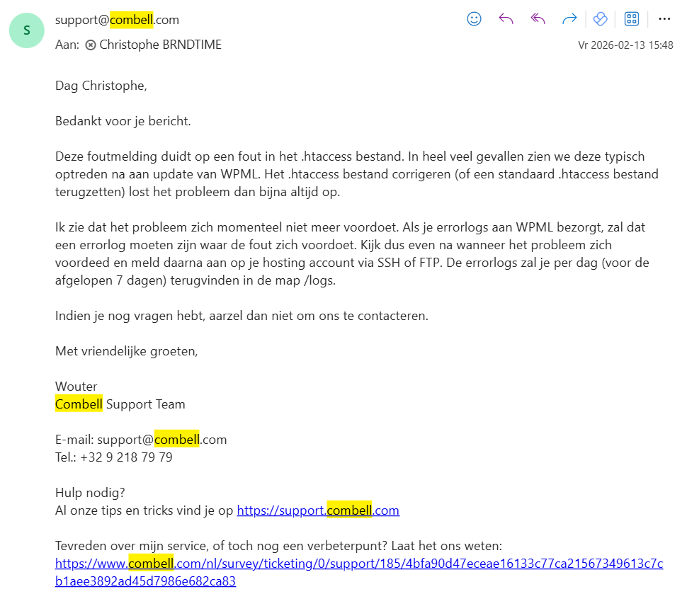

Hi
This is what combell says.
its disapointed dat its not working i have now desactivate the plugin en set a new plugin from google to helpe the cliant .
what can we do ? because if its not working i can not go further with wpml en have to search someting else ?

February 16, 2026 at 10:32 am #17825210
Łukasz Rydygel
Hi Cristophe,
as far as I understand the message from your provider, he has fixed the problem by resetting the .htaccess file. I tried this before, but without any success. As far as I understand you, this also did not helped and that is why you deactivated WPML? It would be very helpful for us, if you could provide us with the error logs from the website.
Looking forward to your feedback.
February 16, 2026 at 10:56 am #17825357
christophet-11
They thinbk its working because i desactivate the plugin
and they say that i need to know witch day the problems begin for te error logs bu i dont now when.
