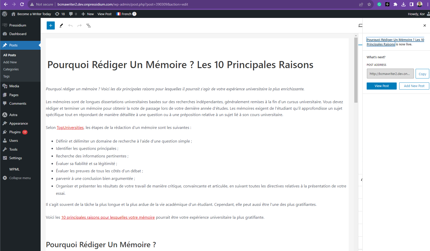

When I deactivated most of the plugins except WPML plugin and it worked fine. I'm able to publish this post without issues hidden link
So, it seems there is a 3rd party plugin preventing you from publishing a post.
Since I've already deactivated the plugins, could you reactivate each plugin one at a time here hidden link to see which one is causing the issue you had there?

Apologies, for the delayed update on this one. I tried the suggestion you mentioned. I deactivated all plug-ins except the WMPL SEO and WPML Multilingual CMS. And below are my testing results.
1. I created/edited/published/updated/republished a test page.
2. No internal server error while editing and publishing
3. Publishing pushed thru, but when the live/preview URL is accessed it goes to a page not found post.
Live URL: hidden link
Preview URL: hidden link
Did you encounter the same thing during your testing? Please advise. Thanks!
October 24, 2023 at 6:10 pm #14650369
WPML Supporter since 08/2022
Thanks for your reply.
I resaved the permalinks here hidden link and it's fixed hidden link . Could you check?
