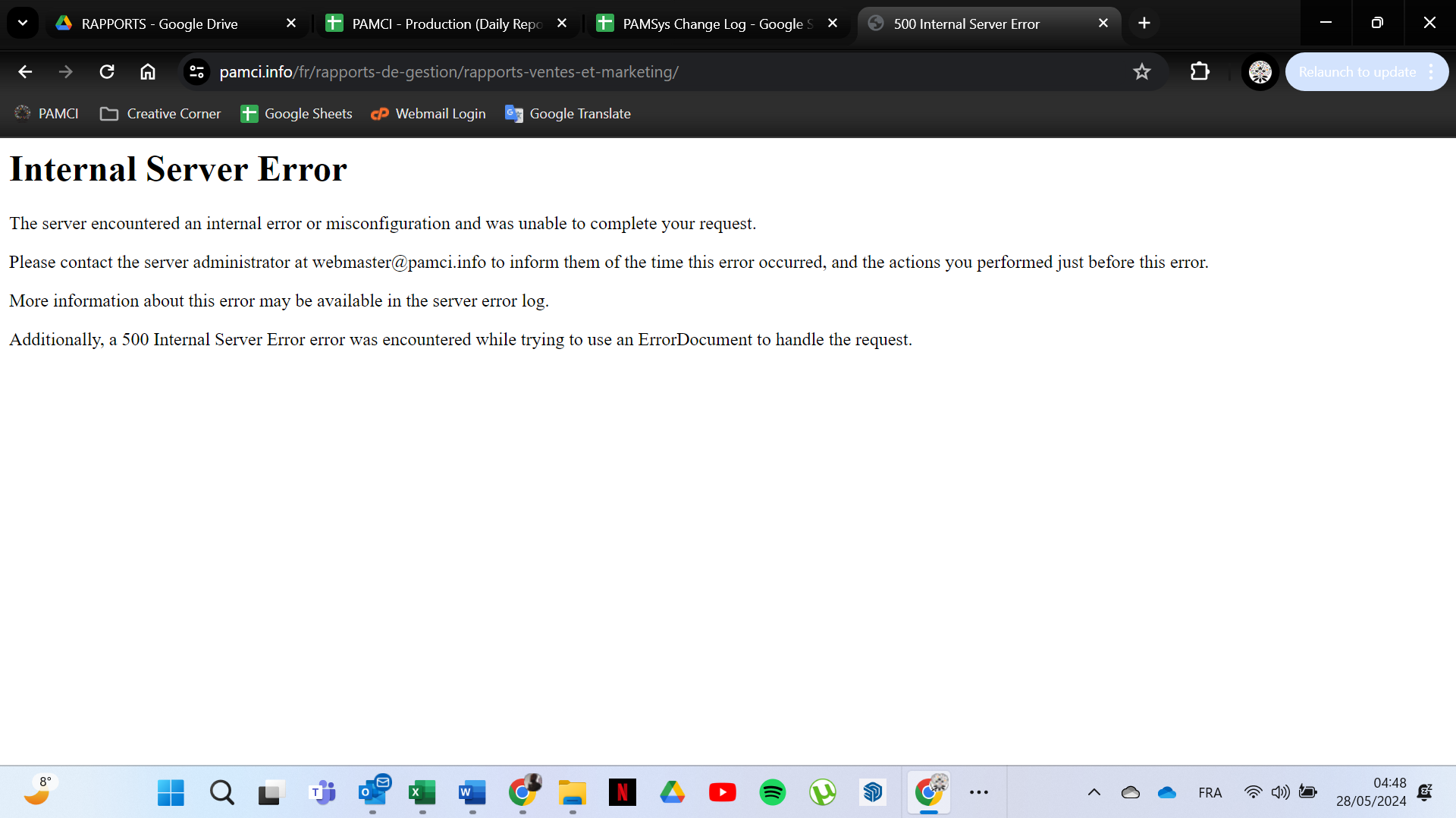

Sorry, we are not out of the woods: THe problem has resurfaced. I logged into the site as different google user and different wordpress account the same thing is happening. Only when I refresh, it does not clear the issue this time... I will try disactivating all the plugins and changing the theme, as suggested, as a next step.
May 28, 2024 at 4:48 am #15676131
chipegoH
I have deactivated all plugins reactivated them one by one and activated the standard Twenty Twenty WordPress theme with intermittent results. The site will work for a while (without producing the error) but then will crash again intermittently (producing the same internal error). I am truly at my wits end, because I have been on this issue for almost 24 hours straight and can't seem to get to the bottom of the issue...

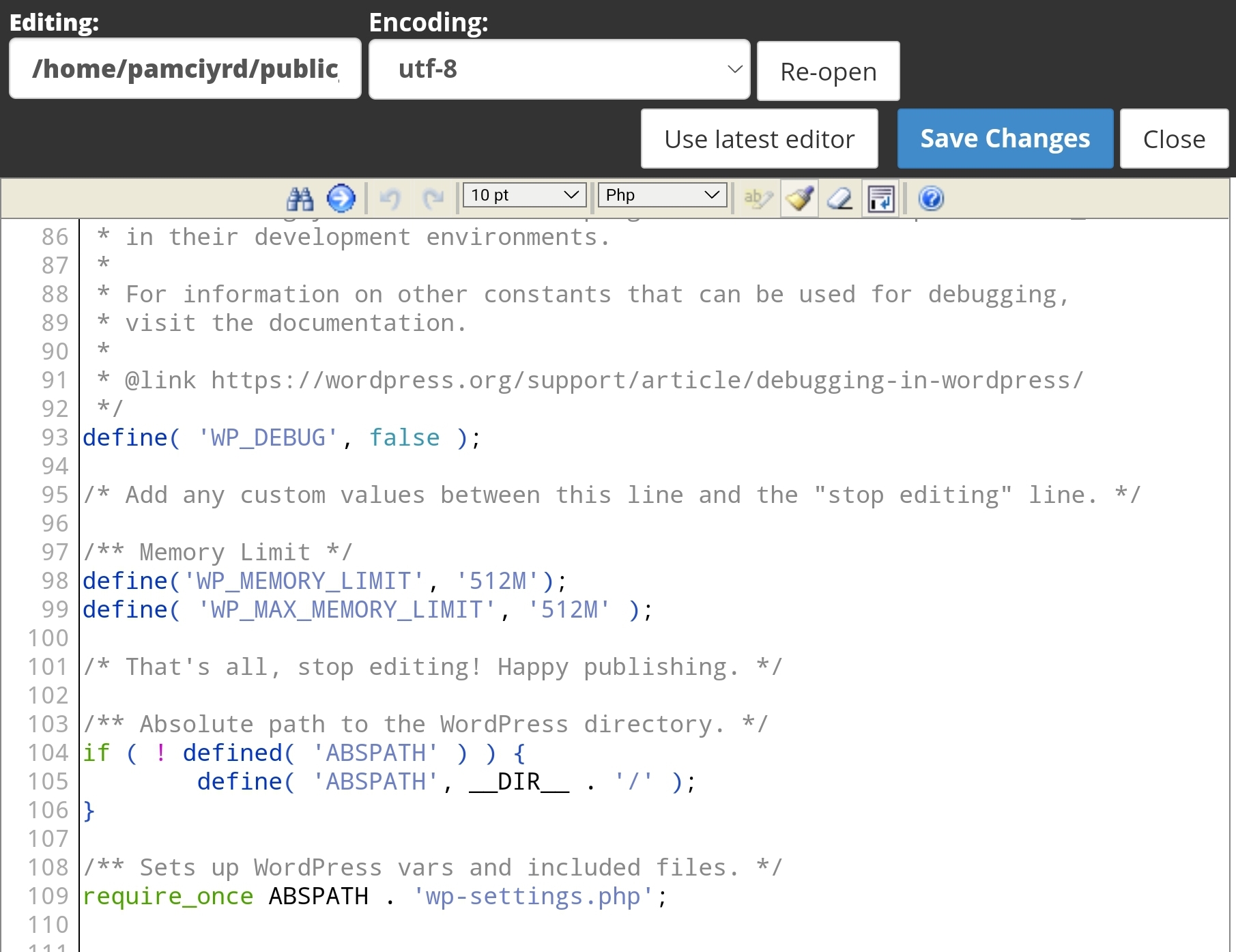

Would you please do as follows?
The minimum requirement is 128M but I suggest that you increase it to 512M: https://wpml.org/home/minimum-requirements/
You can add this by adding the code below to "wp-config.php" file of your WordPress installation root folder:
/** Memory Limit */
define('WP_MEMORY_LIMIT', '512M');
define( 'WP_MAX_MEMORY_LIMIT', '512M' );
Please add the code above the line below:
Please follow the steps and get back to us with the result. If it works, great, if not, the login info works and I will start the copying process.

June 2, 2024 at 7:32 pm #15695898
chipegoH
Hi Christopher,
In fact you did not forget this step. This was the first thing you had me do in the support chat (See reply #15675085) which I did on 27/05/2024.
