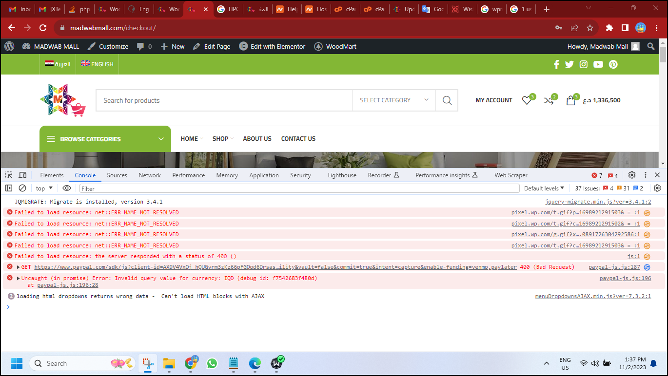

In multicurrency plugin I set Arabic Currency to be IRAQI Dinar, and set PayPal gateway to be USD and enter paypal data.
Still when checkout it sends quiry to paypal as IRAQI Dinar.

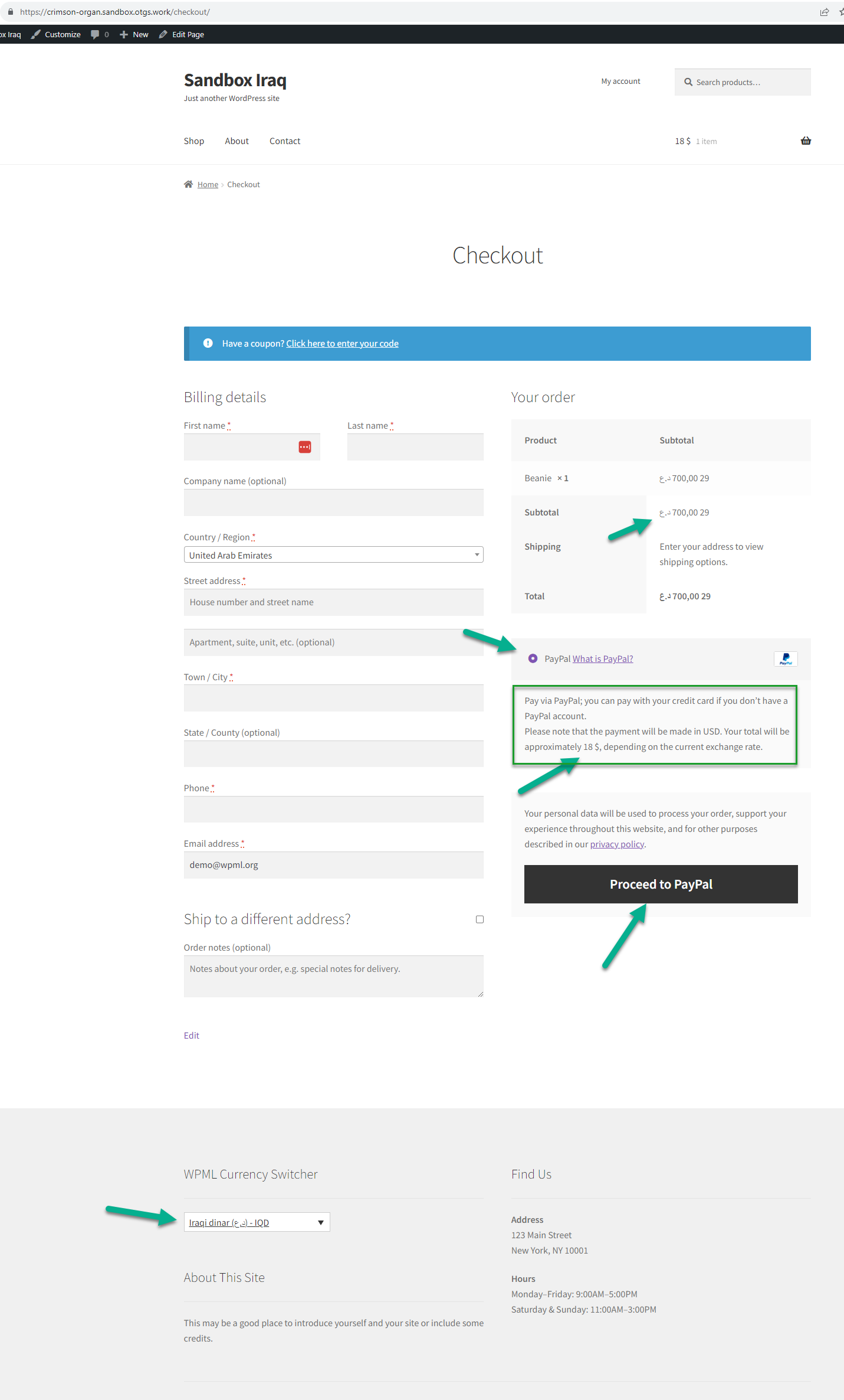

Currently, I don't see the problem that it is not possible to pay with Iraqi Dinar. Please see the attached screenshot.
Have you solved this problem already?

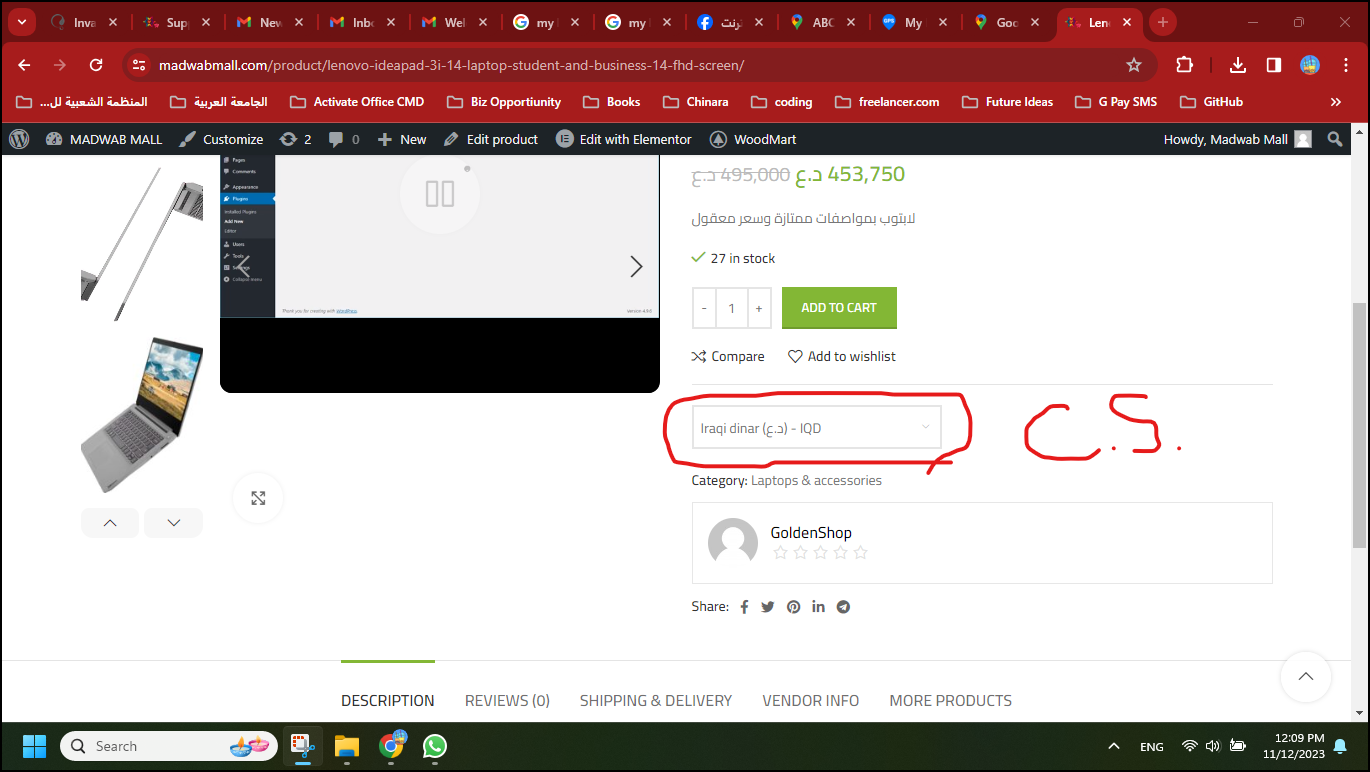

Please go to this product:
Chose IRQ Dinar from currencty switcher then try to checkout with paypal
Its not working, Please also read the ticket chat history, it expalin everything

This is not a WPML issue because Iraq and IRQ Dinar are not supported by PayPal. You can check it here on PayPal's website.
You can check this by temporarily deactivating WPML and setting IRQ Dinar as the currency of your site. Then you will most probably get the same problem.

To be sure of my conclusion, I went ahead and tested this scenario. I created two test sites on a fresh WordPress installation with only WooCommerce and the PayPal Payments add-on. WPML and its add-ons are not configured or installed on my test sites. One site I configured to be in Iraq and use the IQD currency. The second site I configured to be in the United Arab Emirates and have the AED currency. On the IQD site and checkout page, I get the same problem you get on your site, and I cannot proceed with checking out with PayPal. Whereas on the AED site, I don't get this problem. While testing this, I recorded a video for you so you can see my tests. Please watch the video here.

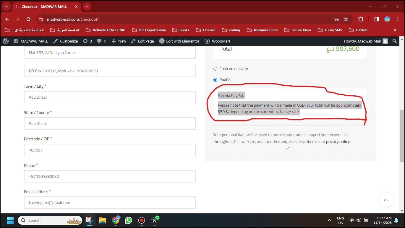

In this official paypal link:hidden link
AED is not supported, yet my WooCommerce is working fine for AED because MultiCurrency Plugin convert it to USD first.
Please see attached image
And see the attached video:
For AED which is not supported by Paypal, the MultiCurrency Plugin convert it first to USD then pass the amount to Paypal and it work like charm
But for IQD it fail to convert it to USD thats why the error comes
