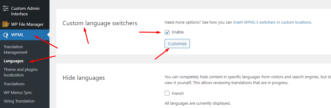

And customize it from WPML >> Languages > Custom language switchers as you can see in the attached screenshot.
Here is the doc for the custom language switcher:
https://wpml.org/documentation/getting-started-guide/language-setup/language-switcher-options/adding-language-switchers-using-php-and-shortcodes/

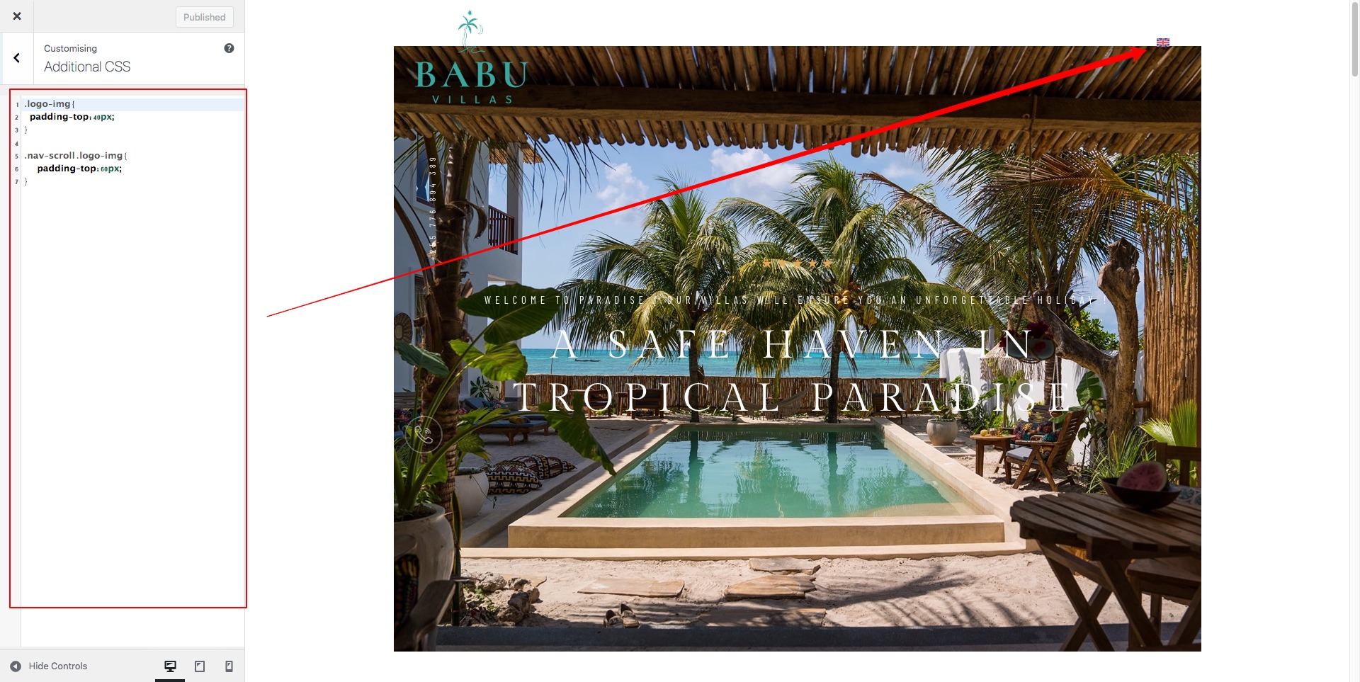

I don't think tis is possible with a shortcode as im struggling to find how to edit the header.
Your colleague helped me out with something similar a while back on another site. He added some custom code to the header. i tried copy this across but it didn't work. Please see the code in the screen of how it was used. The code is also below.

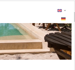

I’ll try my best to help you in this case, Can you please let me know a bit more details to better understand the issue:
1. In which place in your site header you want to display the language switcher?
2. Do you want to keep the same language switcher style as you have currently on your site as you can see in the attached screenshot?

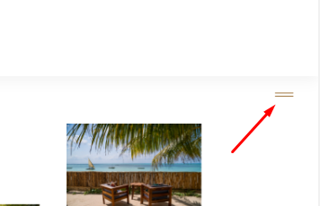

3. At the moment, in mobile view, the language switcher shows by clicking the hamburger menu, is that fine or you want to display language switcher without clicking it as in the desktop view?
April 17, 2024 at 5:36 am #15529047
our-zanzibarG
Hey Noman,
1. I would like it in the exact same place it is, in the top right please.
2. Yes to the same style as it currently is.
3. I would like to have it WITHOUT the hamburger menu so like it is in the desktop.

Thanks for sharing the login details. I’ve copied the desktop CSS in WPML >> Languages > Additional CSS section and removed the media query part so that it will not change the layout on mobile view. Now it should display like the desktop view. Could you please take a look and confirm if it's working?
Thank you

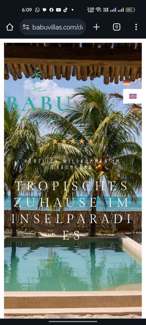

Thanks for making the change. This is looking great. The only issue i have is that when on mobile I cannot select the other language in the drop down menu. When you tap the flag it just loads the same page. Please try changing the language yourself on mobile to see the issue.
If we can solve this then we are done :).
Many thanks
Jack
April 18, 2024 at 1:23 pm #15539026
Noman
WPML Supporter since 06/2016
I’ve updated the CSS and now it works correctly for me on mobile as you can see in the attached screenshots. Could you please try to clear your browser cache and take another look at it and let me know if this resolves the issue.
Please understand that I'm helping you here with an issue that is out of the scope of our support forum and we will not be able to support this particular fix in the future. Because the theme or our code might have changed, so please always be aware of this. Right now it's working without any issue.
Thank you
