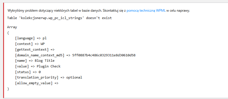

I have installed the WPML Multilingual CMS plugin (version 4.7.4) on WordPress 6.7.1. I am working on a local development environment on my computer at hidden link. I am trying to access the Translation Management section.
When accessing the Translation Management section, I receive the message: 'We have detected a problem with some database tables. Please contact WPML support to fix it. Table 'kolekcjonerwp.wp_pc_icl_strings' doesn't exist'.
How can I resolve the issue with the missing database table 'kolekcjonerwp.wp_pc_icl_strings'?

Please try the workaround suggested in the following errata after taking a full backup of your site:
https://wpml.org/errata/missing-_icl_strings-_icl_string_translations-data-tables/

Hi Andrey,
Thank you for your reply. I tried a workaround mentioned in the article that you sent, however it didn't help.
I double checked and in my database there's the table named wp_icl_strings - could you please advise if this is the same table? Maybe just naming is different.

Thank you for your feedback.
I could be that the warning message appears as a false positive and may get stuck. Try these steps:
1. Click the small 'x' icon on the warning message to attempt to remove it.
2. Refresh the dashboard to see if the warning message still appears.
If the message disappears, everything is likely in order. If the issue continues, please let me know so we can investigate further.
For more detailed information, please refer to the following documentation:
https://wpml.org/faq/how-to-deal-with-error-messages-about-a-broken-table-that-needs-fixing/#problem-with-some-tables-in-the-database
