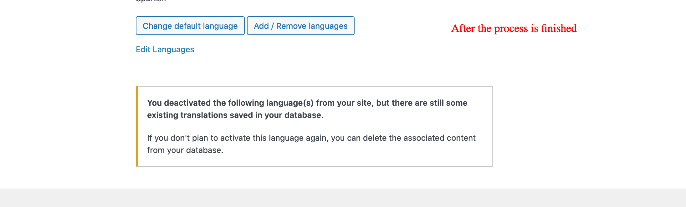

Hello I'm trying to remove a language from my site and the database using this article https://wpml.org/documentation/getting-started-guide/language-setup/deleting-languages-and-plugin-data-by-doing-a-wpml-reset-on-your-site/.
I'm having an issue in Step 1. When I click on the delete all data it seems to spin for a while but then it looks like nothing has changed. I have tried this for different languages with different sizes but they all do the same thing.
Any suggestions on this would be appreciated.

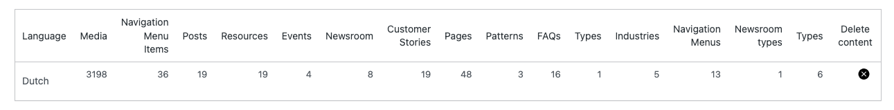

billT
This didn't seem to help at all. I'm not sure if it's because of the size of the site. For example see the number of resources in the image below. This is one of our small sites but it has a lot of media files associated.

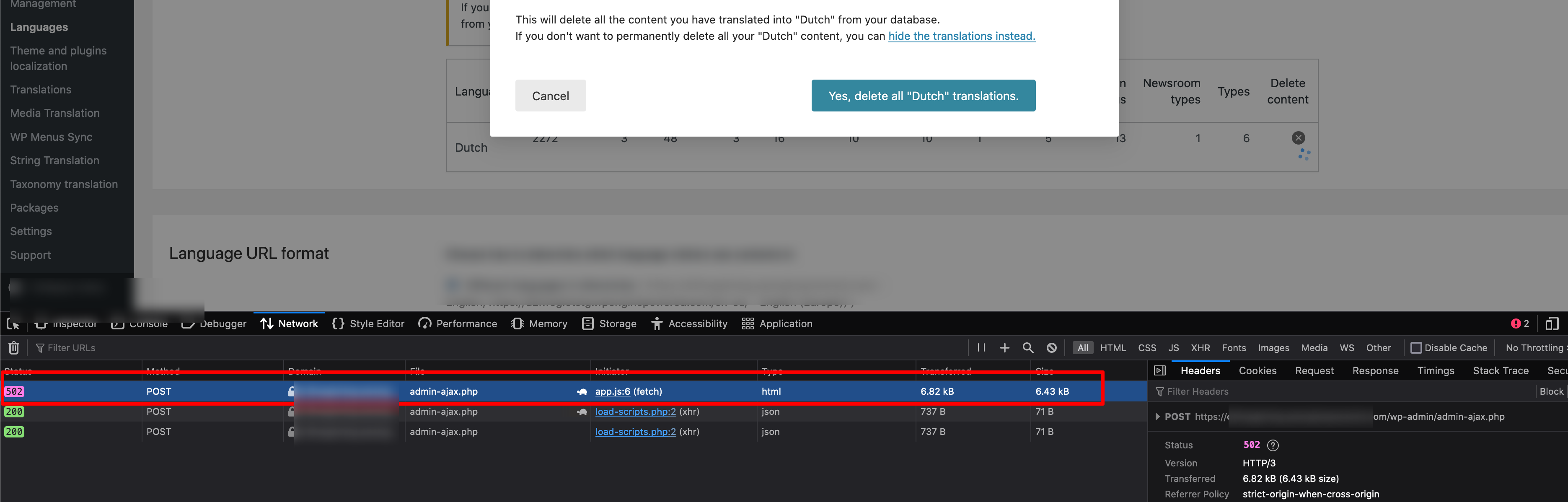

I noticed that there is a 502 Bad Gateway error during this process. Have you tried with any default theme? What are the results?

I see the 502 Bad Gateway in the browser console when the process is stuck.

I have replicated your website on my local computer and successfully ran the option without any issues. The data was deleted within a few minutes of testing it with your theme.
However, your site encountered a 502 Bad Gateway error during the process, and I don't have a clear understanding of why it's happening. To attempt to resolve this issue, I suggest disabling any cache on the server and increasing the WP memory limit.
I would also suggest that you consult your host regarding the issue.

I was able to complete the process on your website. It's likely that the server halted the process after reaching its limits. I clicked the button "Delete Dutch content from database" several times when it stopped. There are a few remaining items that should be removed manually.
