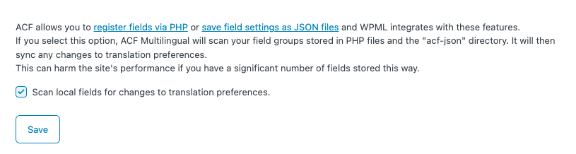

I've conducted numerous tests but can't pinpoint why this inconsistency occurs. Also, I'm curious about how to initiate a reindexing of fields to include new fields and generally how this reindexing process works.
Additionally, I discovered a setting that allows for scanning fields created with PHP, but unfortunately, this function isn't working for me. Is there a way to troubleshoot or fix this issue?
Any insights or guidance you can provide would be greatly appreciated.

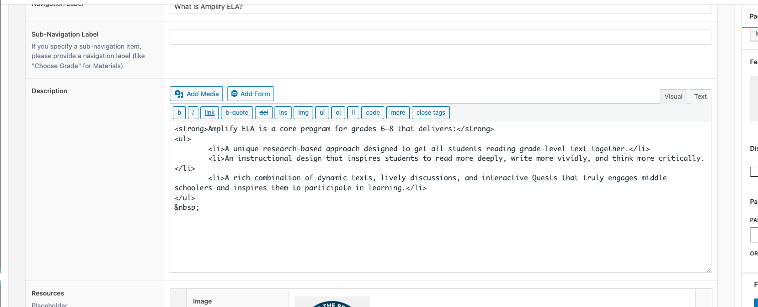

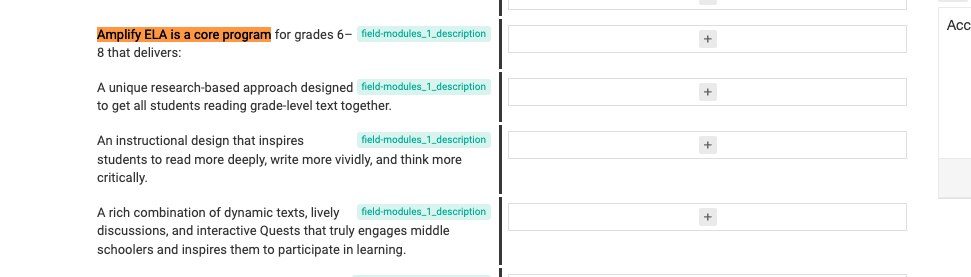

Another question, how can I merge the lines that were separated, because the translators will not understand the common content.
Here is example
The same things are happening with all HTML content. Is there any way to merge to use lines in one?

November 28, 2023 at 6:55 am #14935971
Bruno Kos
It is only possible like this:
https://wpml.org/documentation/translating-your-contents/advanced-translation-editor/#joining-sentences
But it is not possible to change how it works as there are algorithms that decide which sentences may be joined based on how they are created, etc.
