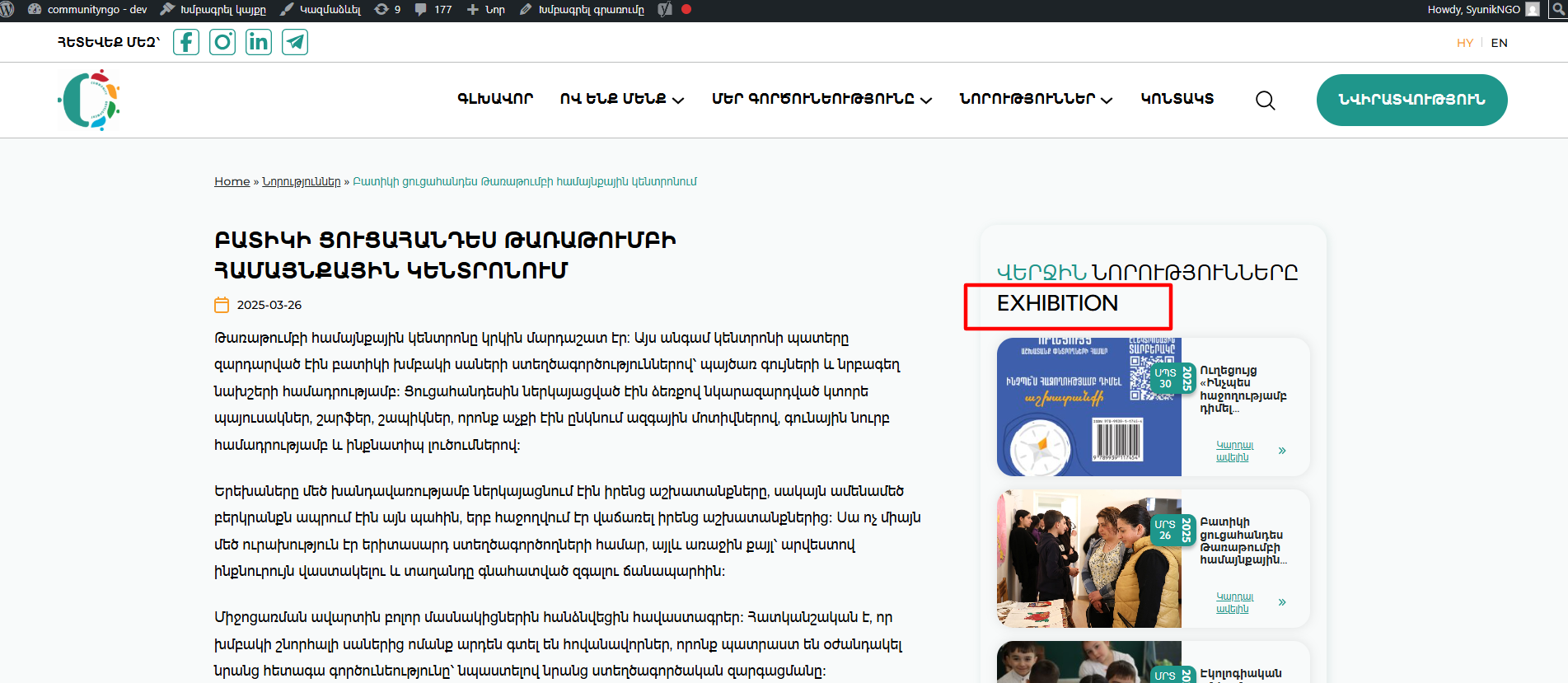

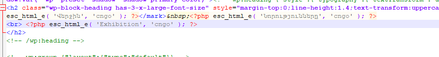

1. I've added the 'Exhibition' string to the theme’s sidebar.php file and translated it into Armenian, but on the Armenian version of the site, it still appears in English. Please see the attached screenshots.
String Translation page:
Front page:

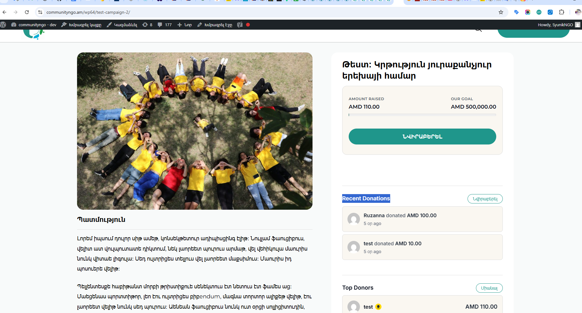

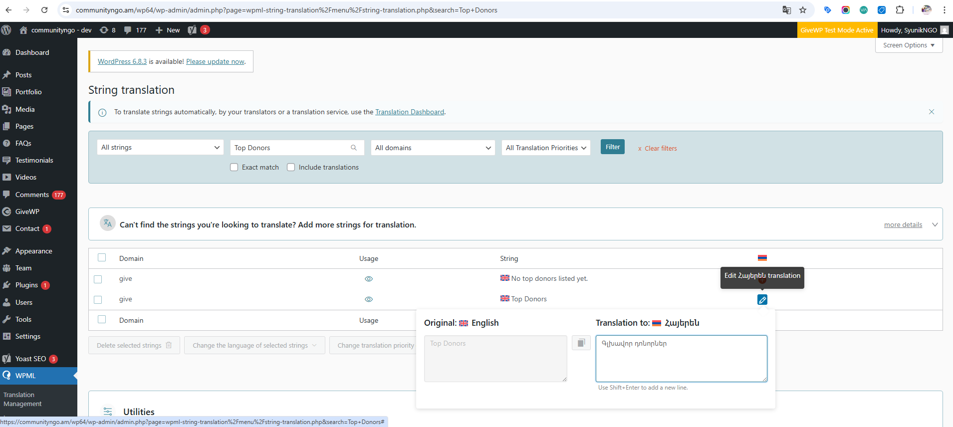

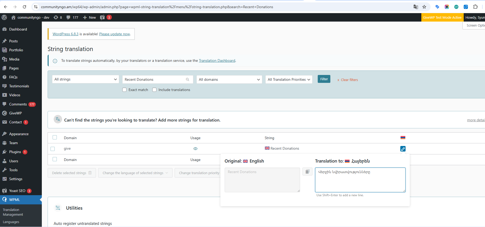

2. I've installed and configured the GiveWP plugin in your sandbox account. With the default languages set to English and German (as the secondary language), everything works correctly.
After that, I changed the default language to German — it still worked correctly.
Then I added Armenian to the language list, translated the strings, and reproduced the issue.
