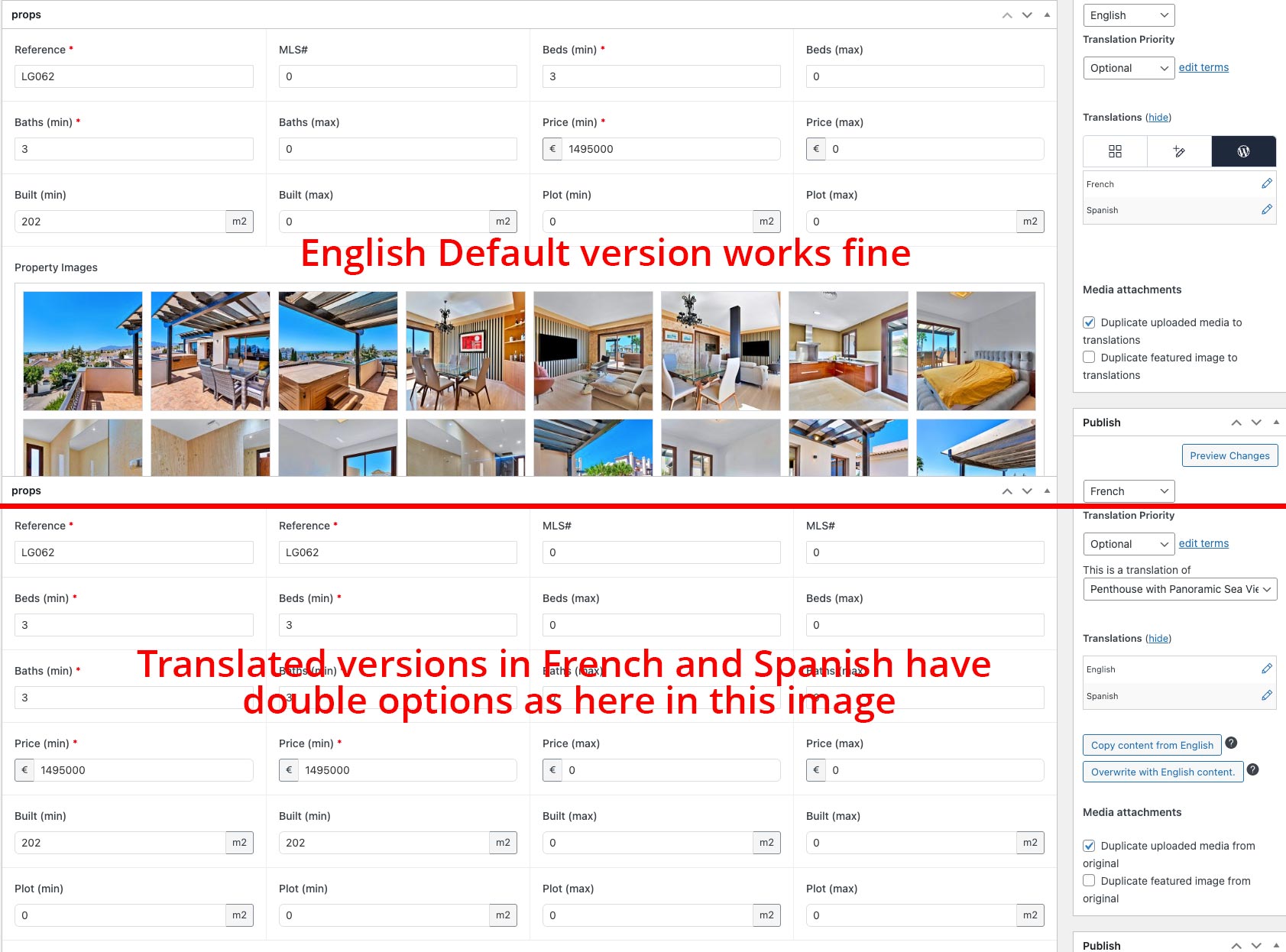

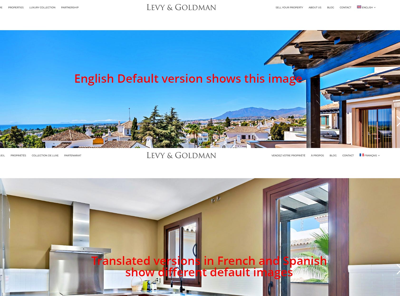

1. When properties are duplicated on your website, they do not display the same main selected image for each language on the front end.
2. When properties are translated with WPML, the system shows doubled options in the backend, such as two descriptions and two sets of fields for each property in the translated versions.

1. the properties on our website, when duplicated are not showing the same main selected image for each language on the front end.
2. when the properties are translated with WPML, the system is now showing doubled options in the back end. 2 descriptions, 2 sets of fields for each property on the translated versions. (the original versions are not showing this issue.

The system has been working fine and no issues for several months, the client has been able to upload and translate properties with no issues,
then in the last week, the WPMl and ACF pro system seems to be having a conflict in regards to duplicating them and now all duplicated properties are showing doubled content in the back end.
