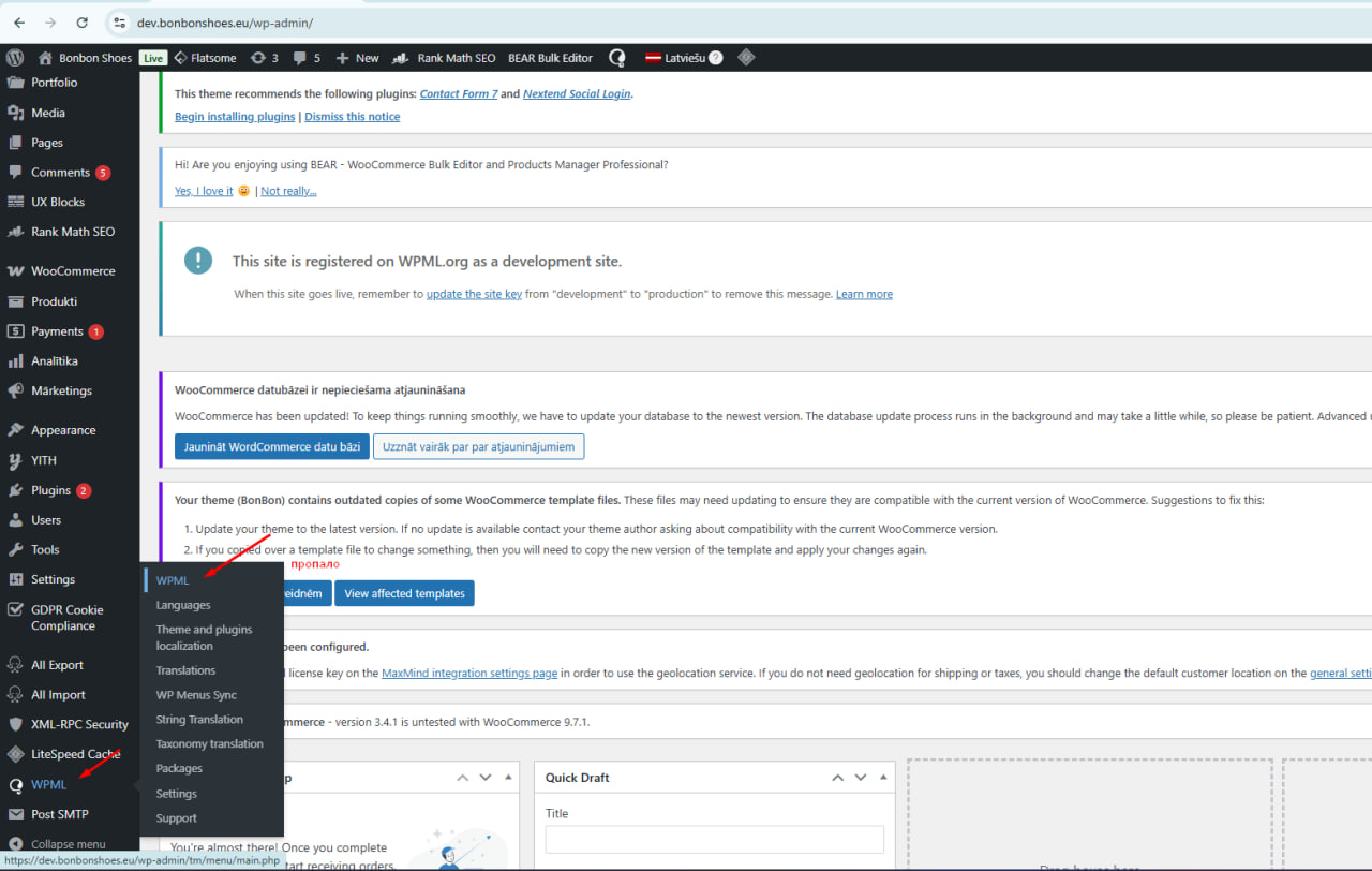

We encountered an issue while updating WPML on our test site hidden link. The plugin does not update unless a different key is entered. We assume that the key was originally taken from the production site, as the test version was created by fully copying the production site hidden link. However, WPML refuses to update using the production key and requires a new one.
After entering a new key and updating the plugins, the Translation Manager disappeared. It is no longer visible in the admin panel, and its functionality is unavailable.
Why is WPML not updating with the production key?
Why does the Translation Manager disappear after changing the key and updating the plugins?
