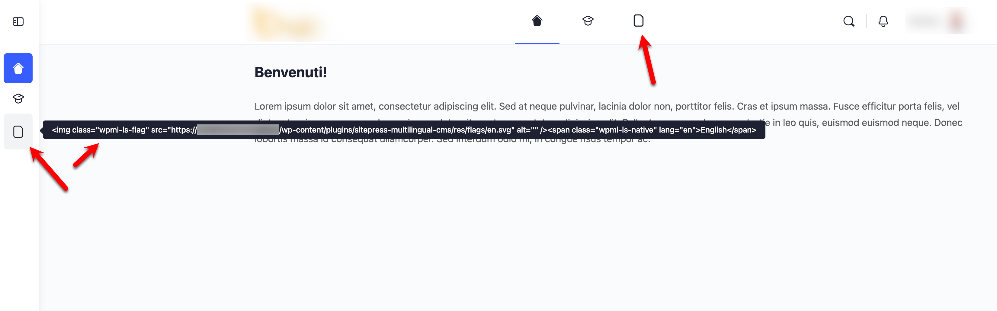

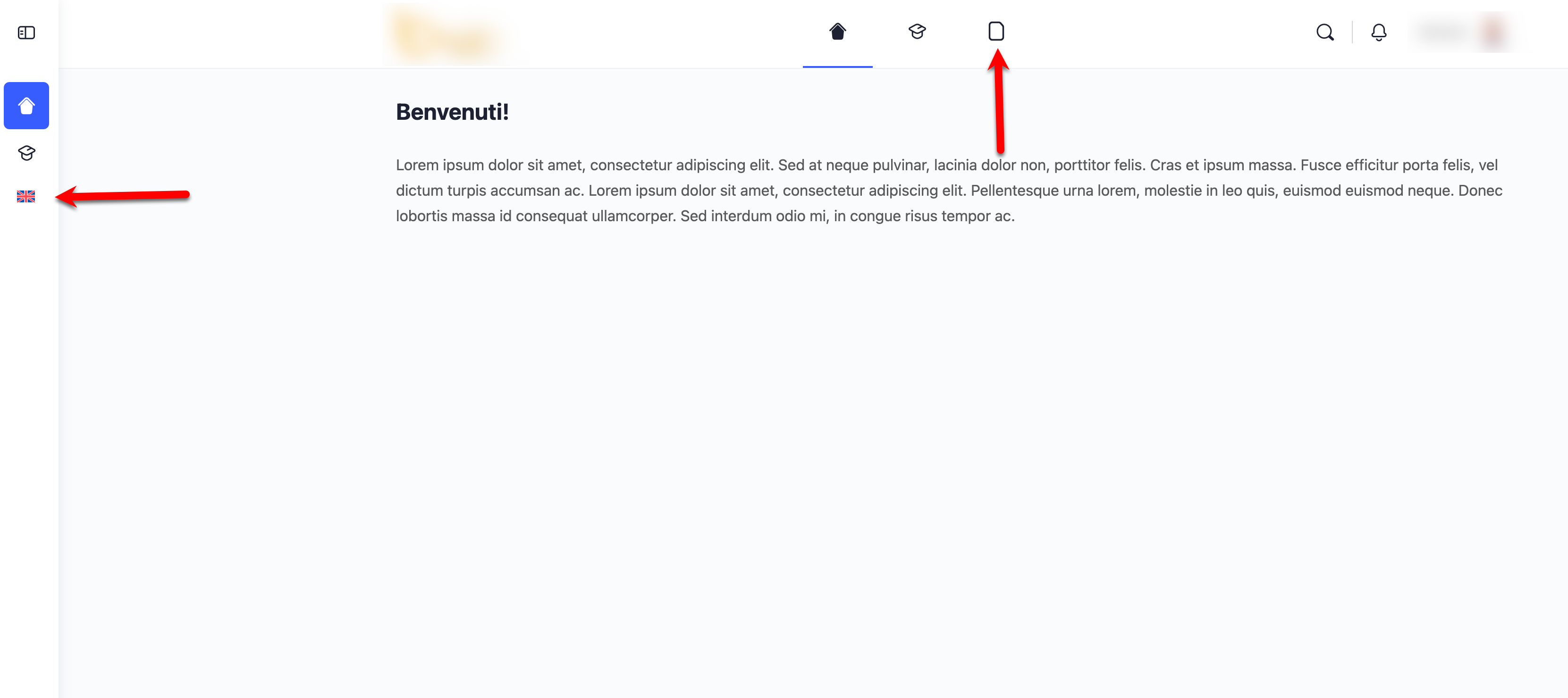

I must use WPML on a multilingual website with Learndash + BuddyBoss Platform/Theme.
Everything would work correctly except for placing the language switcher icon/text on the "Header" and "BuddyPanel" menus. When I activate the option on the WPML "Menu language switcher", a "no-icon" appears on the Header menu, and a "bb-icon-file" icon appears on the side panel.
Do you have any tutorials or suggestions for optimally enabling the language switcher on BuddyBoss menus?

The solution works only for the icon in the "BuddyPanel" menus; instead, in the "Header", I've always seen the missing icon "no-icon".
Thanks.
Michele

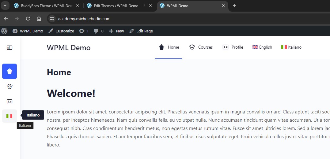

January 19, 2024 at 5:10 am #15202854
Waqas Bin Hasan
WPML Supporter since 05/2014
Thank you for your patience and the heads up.
I've applied following workarounds as suggested by the team and these seem to work fine in your staging site (we've also tested in our sandbox site).

And it is working fine now (see attached).
Please check and confirm, thanks.
January 19, 2024 at 8:43 am #15203374
micheleB-25
I confirm that the workaround received works well.
