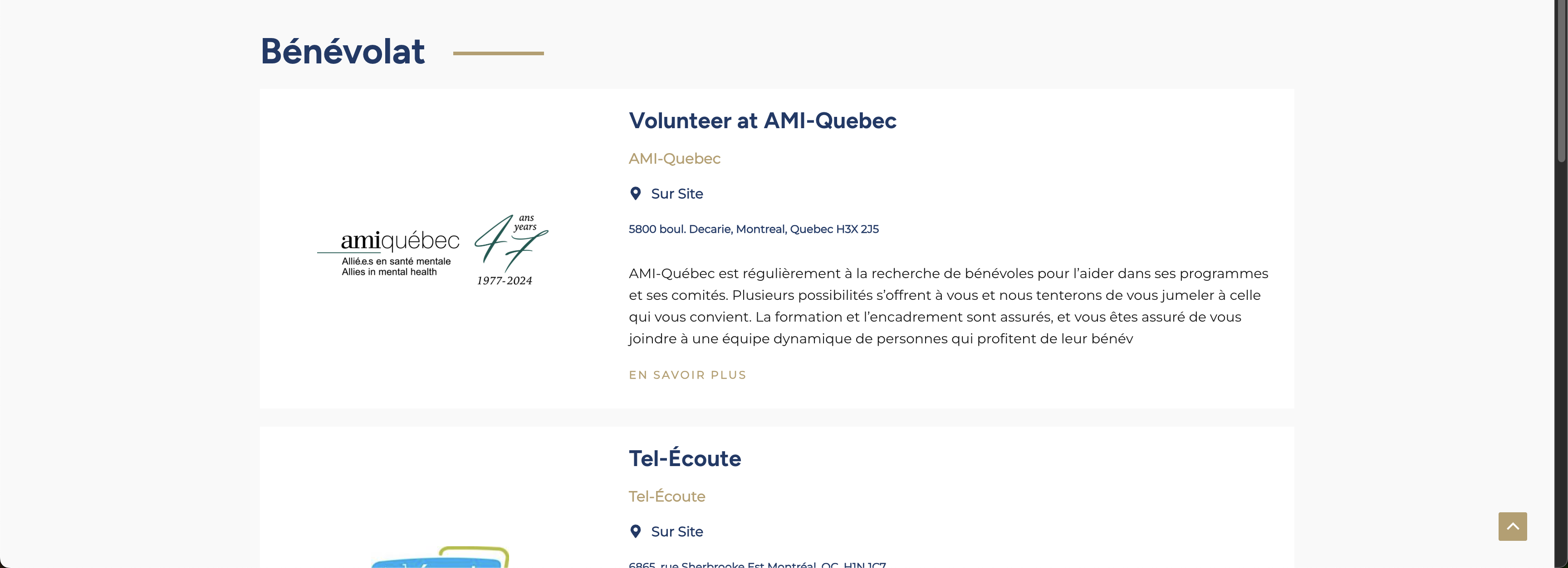

I am trying to translate custom post types created with JetEngine (Crocoblock) using WPML, but the translations are not working as expected. The post types I am working with include Événements, Emplois, Bénévolat, and Organismes membres. I have enabled post type translation in WPML, set custom fields and taxonomies to be translatable, and scanned JetEngine under WPML > Theme & Plugin Localization. I have spent several hours troubleshooting by adjusting WPML settings, checking WPML’s string translation, and resaving posts. Link to a page where the issue can be seen: hidden link
Automatic translations don’t work for posts under these post types via WPML’s Translation Manager. When manually translating a post, some meta fields are missing from the Advanced Translation Editor. Smart Filters in sidebars do not get translated. In the 'Organismes membres' post type, the translated version does not display all expected content.
Could you please assist me in identifying what might be causing this problem?

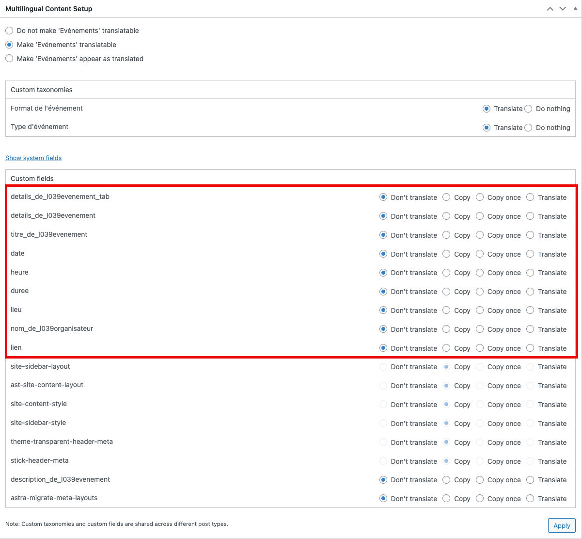

I checked the Events post type and found that the custom fields were not set to translate or copy. (Kindly check the attached screenshot)
After setting them correctly, I updated the event in the default language and its translation, which fixed the issue with the past events section.

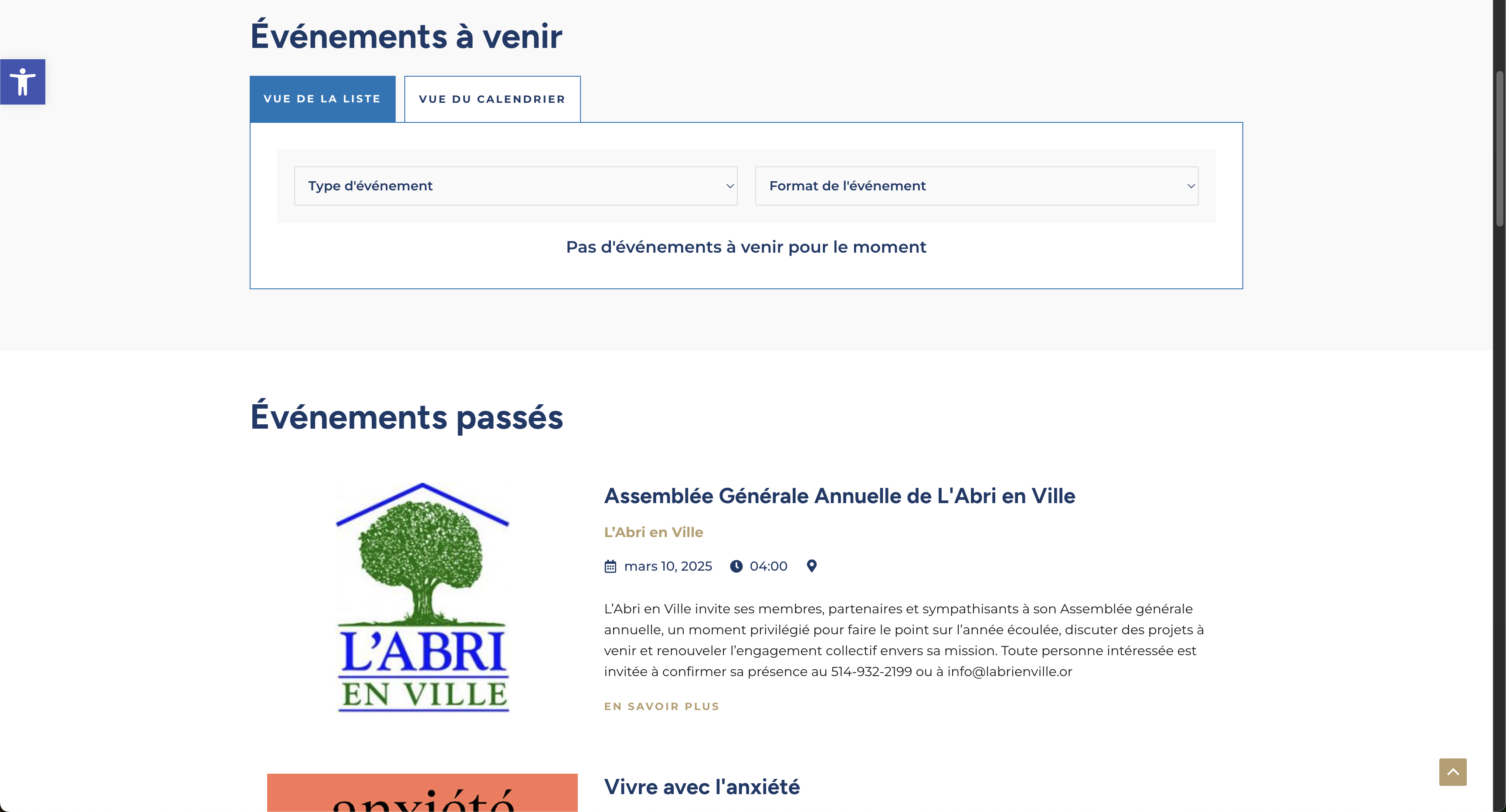

However, the above steps didn't fix the filter issue, so I edited the translated filters to select the taxonomy and updated them, which fixed the filter issue.
Please check the events page and let me know if it works as expected. (hidden link)

1) In order to set the field translation preference, please edit a post in the default language, scroll down to the Multilingual content setup section, and check the field translation preferences.
I set the fields to be translated, but you need to update the default language posts before translating.
2) To fix the filter issue, please go to Smart Filters-> All Filters, switch the language using the top admin bar language switcher, edit the translated filter, and ensure that the translated taxonomies are added correctly.
Osama
