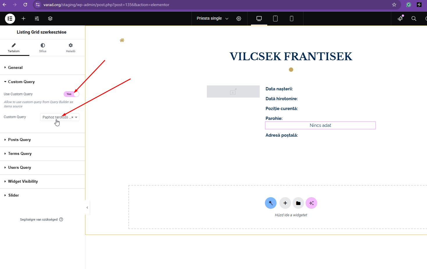

I have a many to many relationship in Jetengine where Parishes is the parent and Priests is the child post type. In the single template for both Parishes and Priests, I have listings. In Parishes, there is a listing of priests serving there, and in the Priest profile, there is a listing with the Parishes. In Hungarian language, this is working perfectly but when translating in Romanian it shows no data. All posts are translated in both CPTs. The single templates are also translated, the listings too. Every listing has a Query Builder query set but that is not translatable and I guess it should not be translated anyway. You can check one of the Priest posts here: hidden link
When translating the listings from Hungarian to Romanian, it shows no data despite all posts and templates being translated.
Why does the translation from Hungarian to Romanian show no data in the listings?
Is there a specific step needed to ensure Query Builder queries work with WPML translations?

Thanks for your patience. While preparing a report, I've solved the issue by selecting the correct custom query for the Romanian language here hidden link as shown in the attached screenshot. Now the parishes show up correctly hidden link and could you please check?
