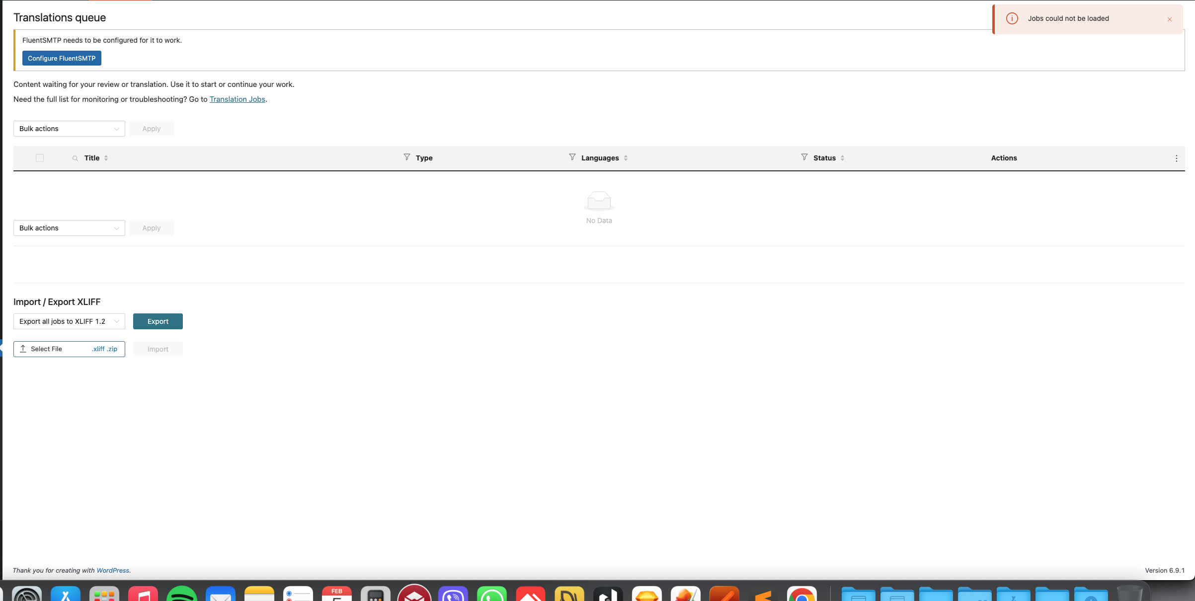

February 5, 2026 at 10:52 am #17795554
iliasK-9
the error is not fixed now is in the first page
February 5, 2026 at 10:54 am #17795559
iliasK-9
here is the image
February 5, 2026 at 12:14 pm #17795928
iliasK-9
we have a server load pls fix it

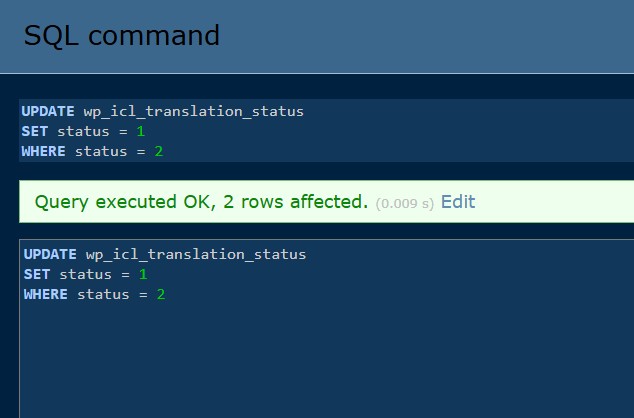

I followed the steps below:
1. Installed the Adminer plugin on your site.
2. Ran this query:
UPDATE wp_icl_translation_status
SET status = 1
WHERE status = 2;
After this, the WPML >> Translations and WPML >> Translation Dashboard > Translation Jobs pages are loading correctly, as shown in the attached video: hidden link
If this happens again, please check which specific page or post you were trying to translate when the issue occurred.
Thank you for your cooperation and patience.
