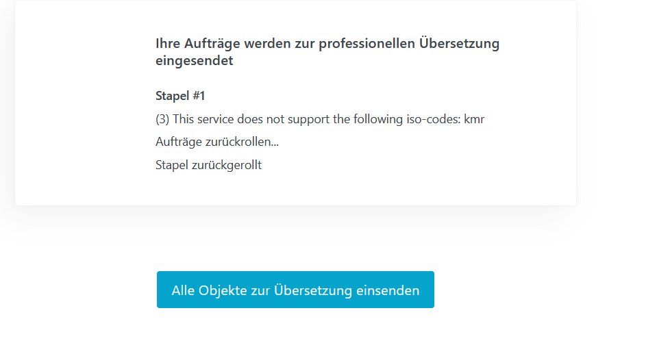

Hi, Northern Kurdish / Kurmanji as LTR with Latin alphabet is not supported in WPML out of the box.
However i've found forum posts, that suggested to create the language Kurmandji with the correct code kmr and define as ltr.
That worked so far.
Now we wanted to send our content to a professional translation service via wpml backend. But we got the error as depicted in the screenshot.
Any suggestions about what we can do?

Thank you for getting in touch with us. Indeed, Northern Kurdish still isn't supported by WordPress.
Can you please share the exact steps you followed? That way I can test the solution on my side and verify if it actually works with WPML's current version.
As an alternative, I advise you to check this other ticket (it's a bit advanced, but it might help):
https://wpml.org/forums/topic/kurdish-kurmanji-kmr-is-rtl-instead-of-ltr-its-load-like-kurdish-sorani-ckb/
I'm waiting for your feedback.
January 29, 2024 at 9:57 am #15237060
eikoT
Hi Lucas, thanks for your reply!
I'm not so sure if it is (still) true that kurmanji is not supported by wp. There a kurmanji version of the official website (latin alphabet and ltr): hidden link
To reproduce:
1: We created Kurdish with code "kmr" as a custom language, just the way it's described in the solution to the ticket you've mentioned above. https://wpml.org/forums/topic/kurdish-kurmanji-kmr-is-rtl-instead-of-ltr-its-load-like-kurdish-sorani-ckb/
(not having to use the "wpml_rtl_languages_codes" filter hook, similar to the op)
2: We marked some content for translation in translation management, then submitted the translation job to the professional translation service lingarium. (which are integrated into wpml).
That's when we got the error from the screenshot above.

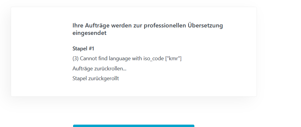

February 2, 2024 at 10:24 am #15258495
eikoT
Hi, now we get a different error. (Please see screenshot)
Does this mean, that we need to check with the translation service if they really enabled kmr?
And if so, do you have any ressouces that I can point them to?
Kind Regards
February 2, 2024 at 12:57 pm #15259333
Lucas Vidal de Andrade
WPML Supporter since 11/2023
Our team double-checked the configurations to ensure everything was correct. Can you please try again? I apologize for the confusion.
February 2, 2024 at 3:14 pm #15259926
eikoT
Thanks, those changes seemed to have worked. We were now able to transmit the translation job to the service!
We'll check with the service after the weekend, to see if they received everything correctly.
Kind Regards!
