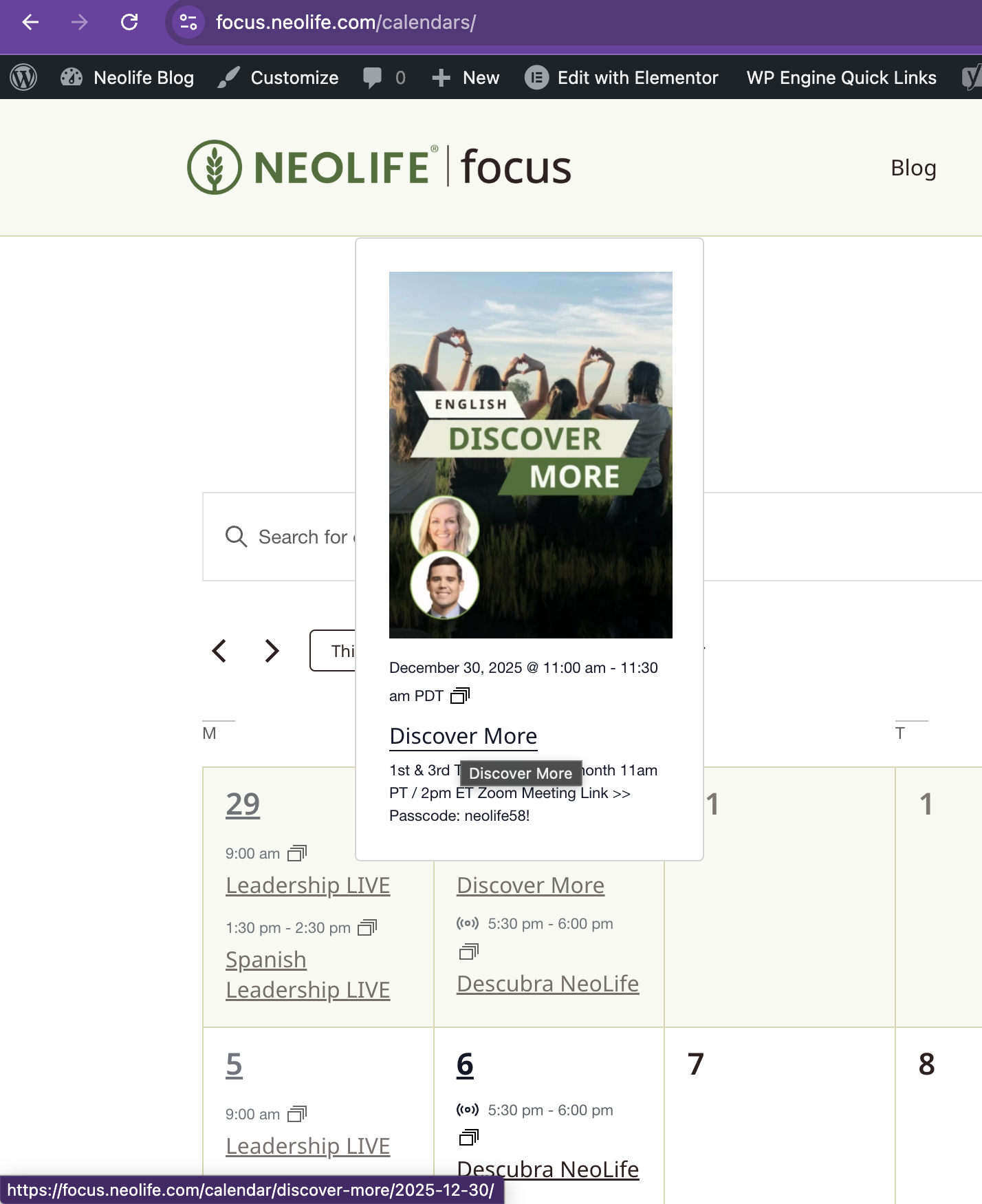

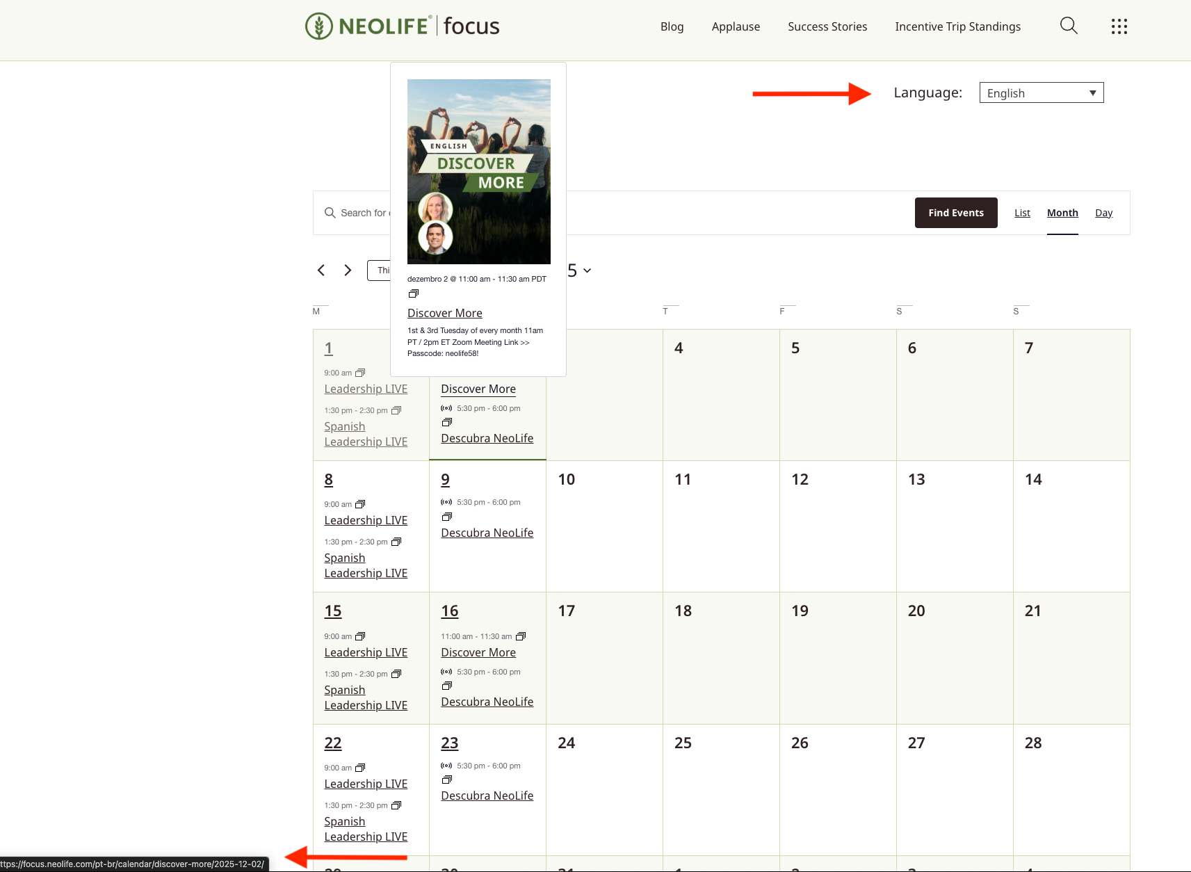

There is an issue with the plugin integration with events calendar (hidden link), I set it up correctly using the translation just in the events but when you navigate or click on the month view the language changes even though you have not interacted with the language dropdown. It also picks a random language for each event. (Please see attached screenshots)

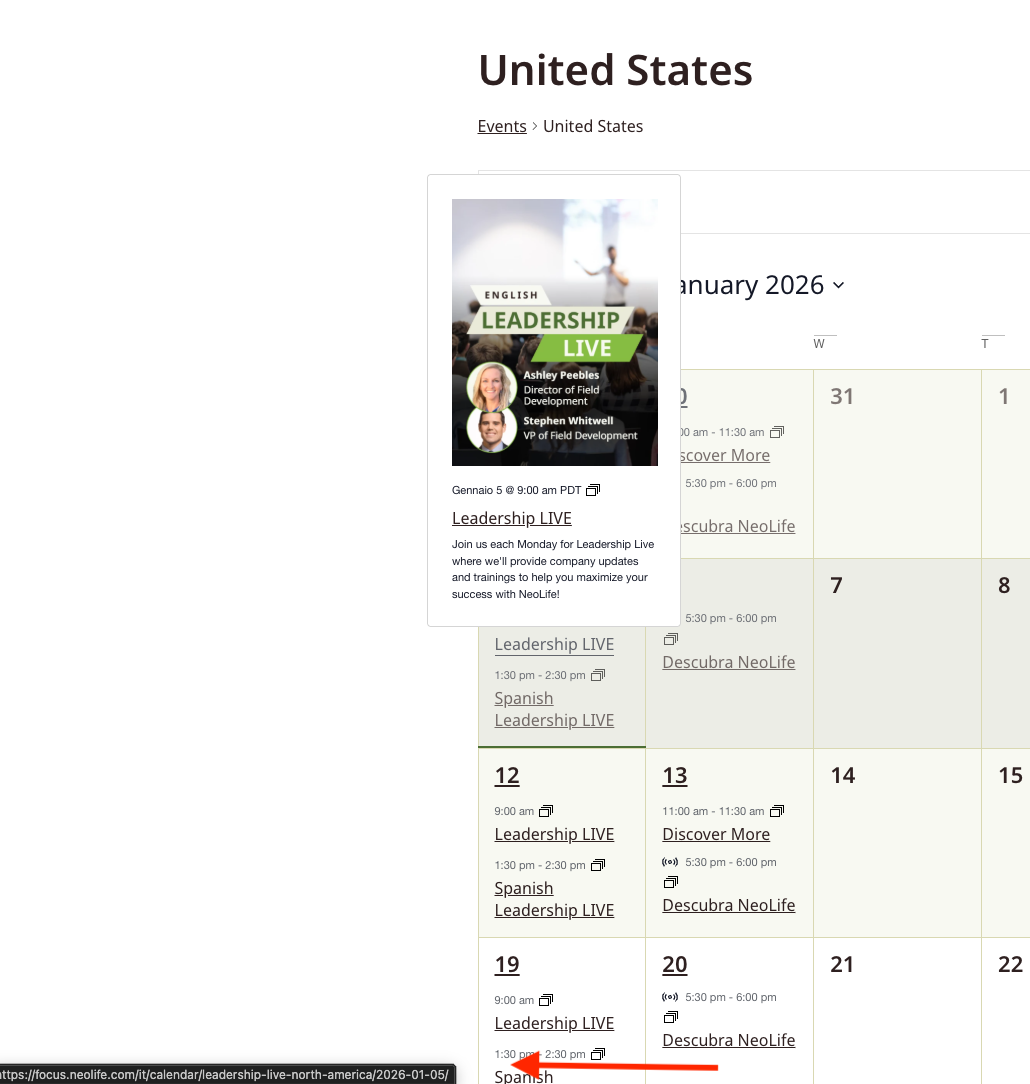

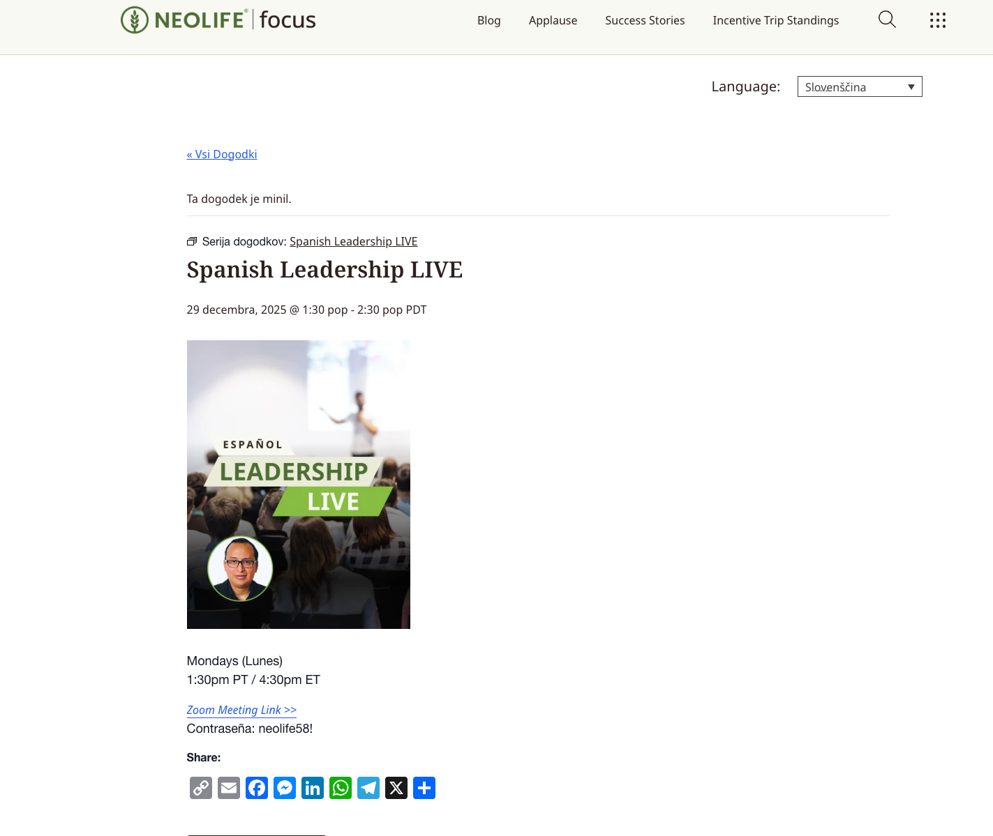

No, the same issue happened at first tried, I didn't even touched the dropdown and the language switched. You can see it in the month view, all of them have random language URLS. Please we need to solve this issue. We are about to launch the events and this is the only thing holding us now.

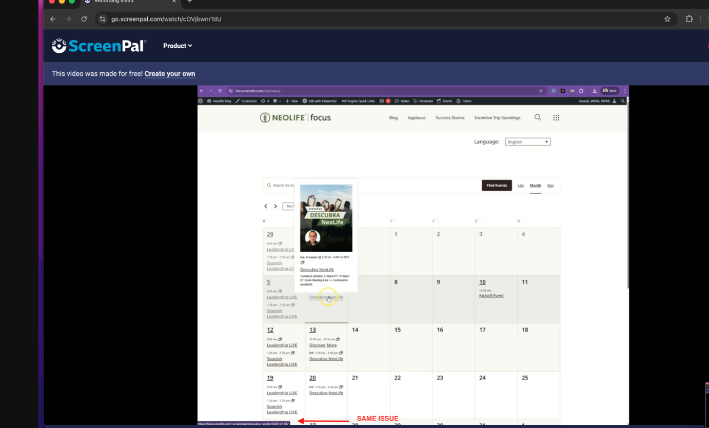

I look at your video and you are having exactly the same problem in your local server, I can see the urls having a random language and when you clicked on the event I could see the language changing as well. The screenshots are from your recording. Please review since if it's happening in your local server as well the issue is not the server.

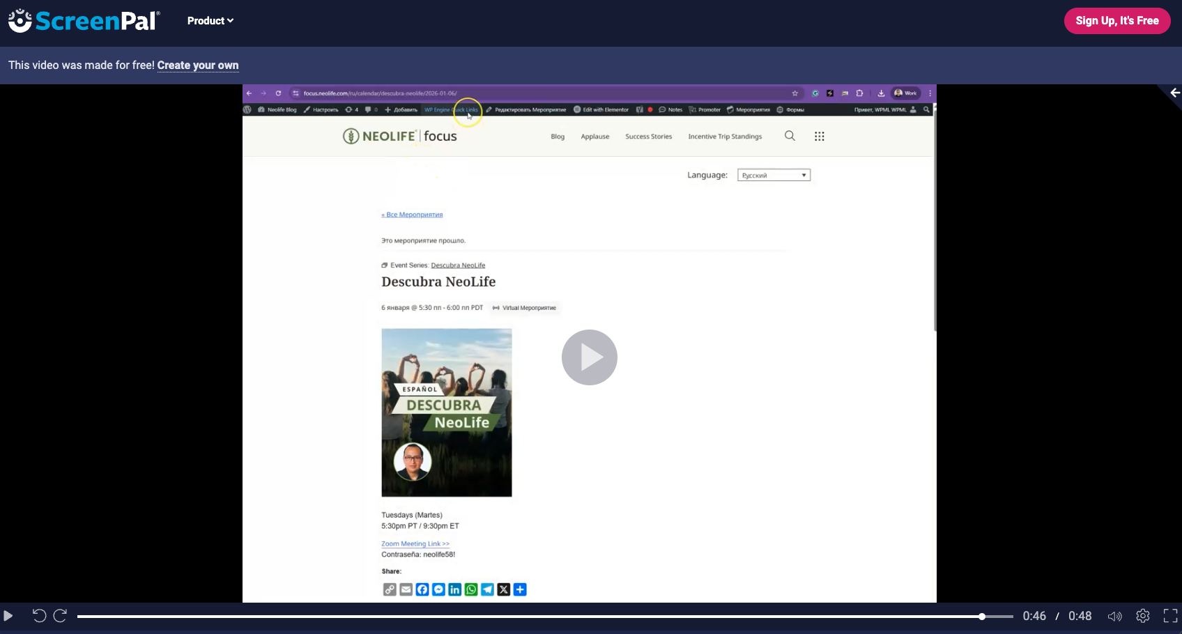

I suspected the issue is related to WP Engine caching. To test this, I temporarily disabled WP Engine caching on your staging site by commenting out most of the code below the “Localized Language Stuff” section in the wp-config.php file.
Now the events load the correct languages, and please refer to this screen recording for details: hidden link
