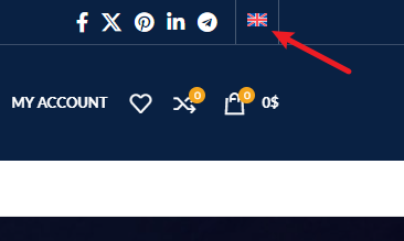

darithS

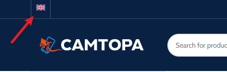

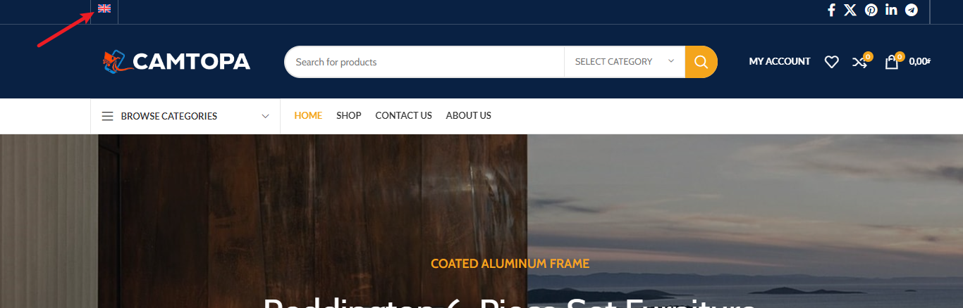

I have already completed customize to show language on the Top bar but it not showing and it also not translate my site. Please help me
February 19, 2024 at 12:55 pm #15318277
darithS
Only showing 1 language

Hi there.
So, from what I can see in your screenshots, only the cart and checkout are "translated" at the moment (you can see that they are green-colored in your screenshot). Probably they are duplicated, not actually translated, but at least there's a "translated" version available for the "cart" and the "checkout" pages.
That is why for example, in the "Cart" page here (hidden link), you will see that all the language flags are showing up in the header left area.
So the content needs to be translated.

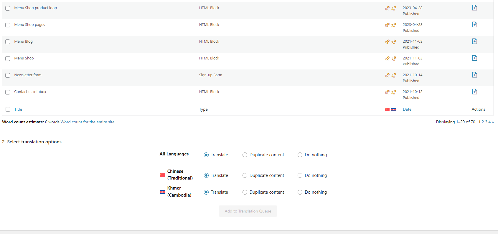

I have provide (wp-admin and FTP) in private and as the screenshot bellow why some text or page did not translate as I choose translate everything?

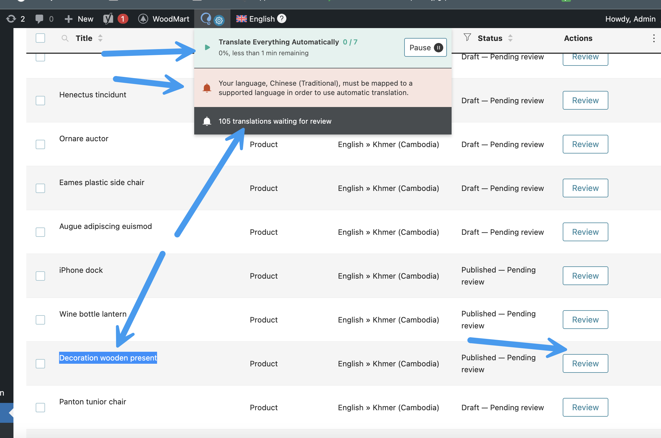

Hi there and thank you for the credentials.
Please take a look at the screenshot that I attached - you will see some important notices there.
For example:

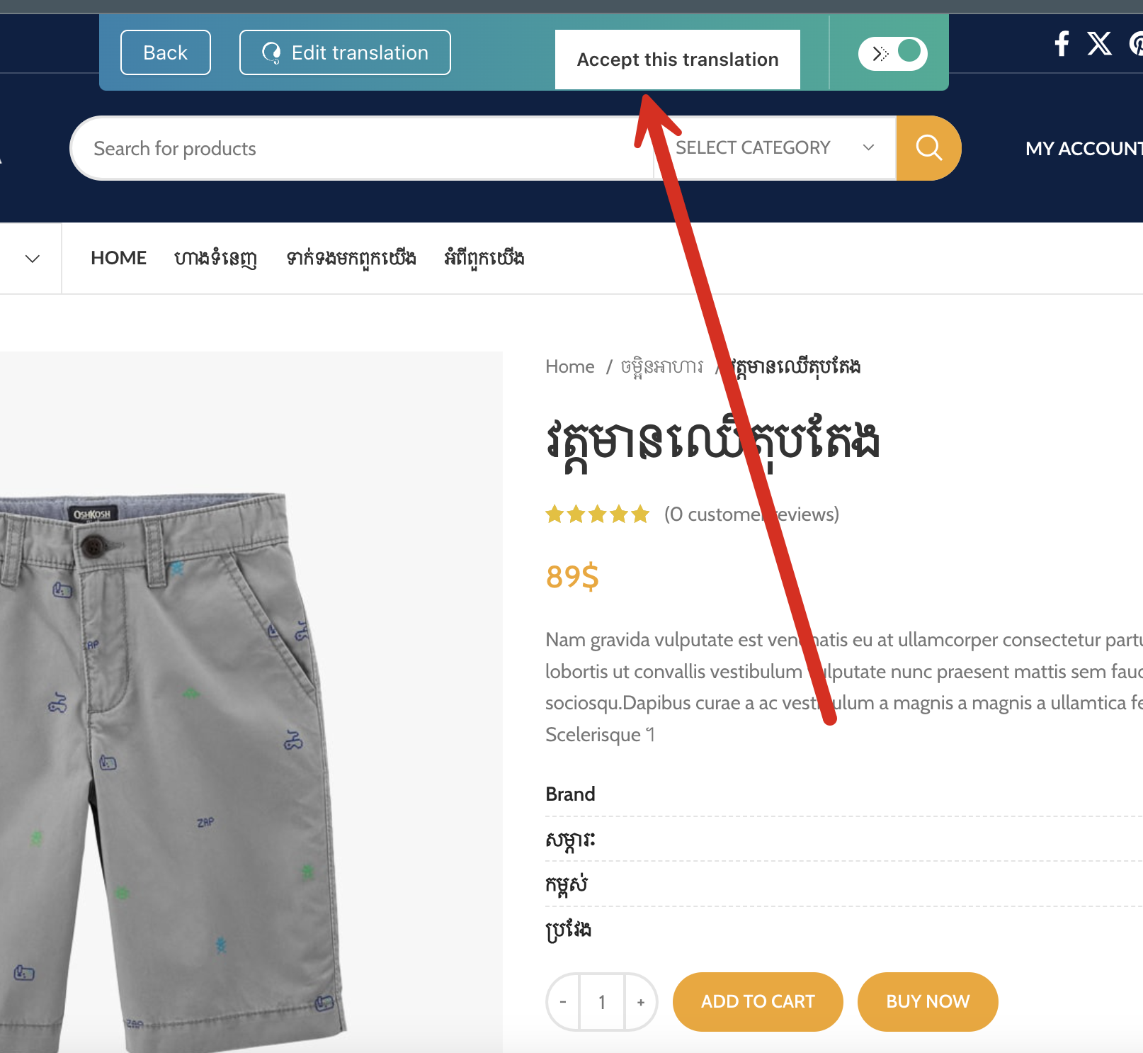

You have 105 translations that are available for you to review and accept the translation. You can see all of them here:
So, if you go here (hidden link) and select this product for example "Decoration wooden present" > and click the "Review button" > that will take you here (hidden link) where you will see the available translation and at the top, you have the option to accept the translation.
We also have some super helpful documentation here:
https://wpml.org/documentation/automatic-translation/how-to-review-automatic-translations-on-your-site/
In regards to this other notification that you have at the top on your site's backend ("Your language, Chinese (Traditional), must be mapped to a supported language in order to use automatic translation."), I am creating a new ticket below so that we can tackle one issue per ticket:
https://wpml.org/forums/topic/split-your-language-chinese-traditional-must-be-mapped-to-a-supported-language-in-order-to-use-automatic-translation
In regards to the first message at the top (with the current process of translation), you can go here (hidden link) and see the current status.
Even there it will mention the language mapping procedure that needs to be done first.
I will also create a new ticket below for your latest question above, present in your latest reply:
https://wpml.org/forums/topic/split-why-some-text-or-page-did-not-translate-as-i-choose-translate-everything/
You will be notified via email whenever there's a new answer to each of the tickets.
Per our Support Policy, we can handle only one issue per ticket.
Continuing with one issue per ticket helps not only supporters to focus on one issue at once, but also enables other users to find solutions to their questions faster.
I hope that you will find all that information helpful.
Please follow the steps that I mentioned above.
Mihai

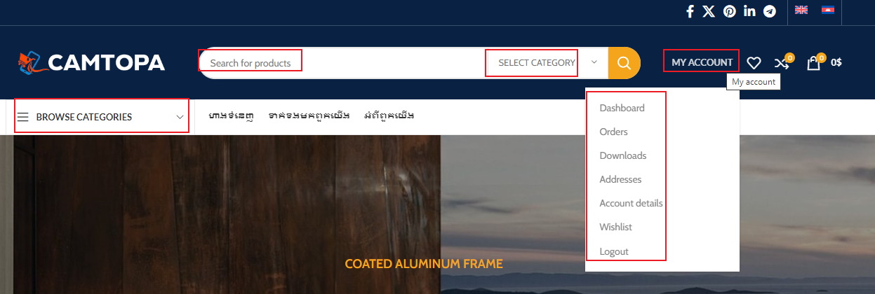

February 21, 2024 at 4:53 am #15325248
darithS

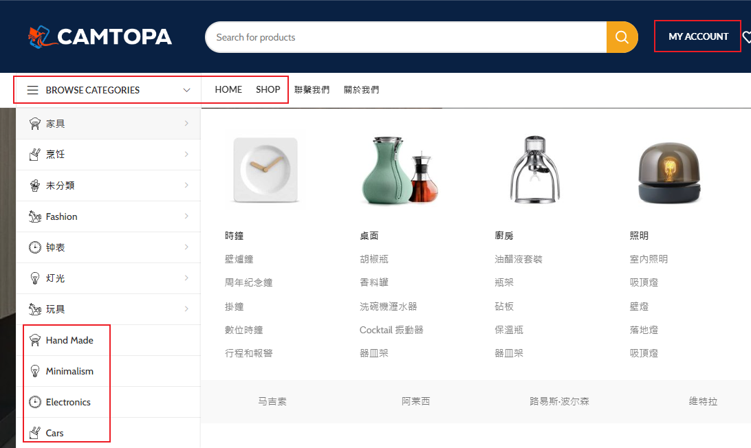

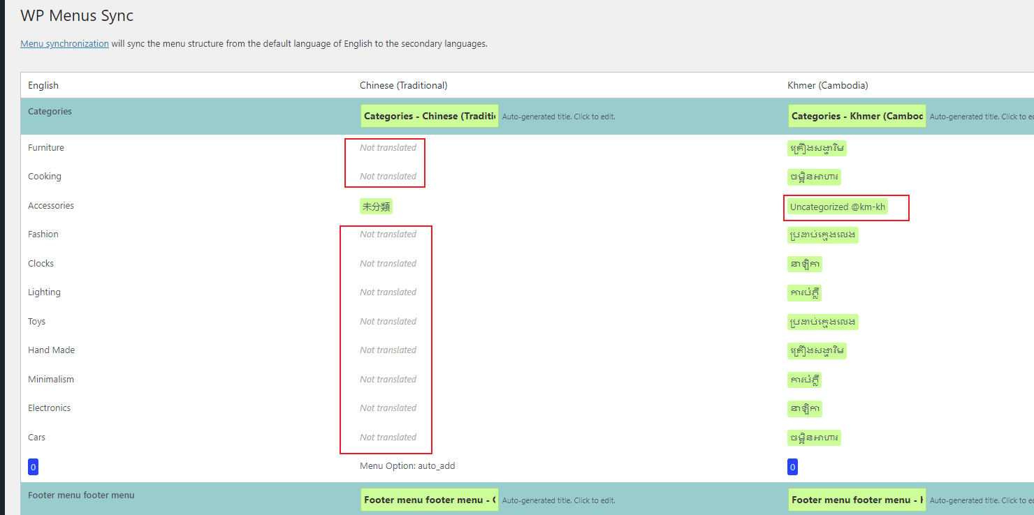

How can I edit or translate this to the right one?
February 21, 2024 at 7:13 am #15325415
darithS
Can you help me how can I find and translate this menu? I go to String Translate but I can not find it.
February 21, 2024 at 2:13 pm #15328553
darithS

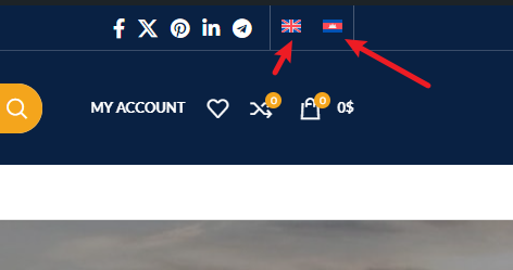

Can you help me how can I find and translate this menu? I go to String Translate but I can not find it. And on the top bar only show 2 language. Please help me check with what is the problem?

As I mentioned in my latest reply, I already created a new ticket for the menu translation issue - it is here and I can see that there's already a colleague who's assisting you:
You should share this image here (https://wpml.org/wp-content/uploads/2024/02/15325248-Snipaste_2024_02_21_11_52_54.png) with my colleague on the other ticket as it is also related to the menu translation issue.

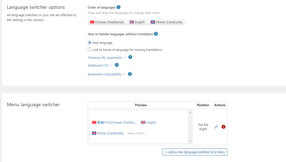

In regards to the initial issue reported in this ticket (the fact that there are no translations and you only see one flag at the top, in the language switcher area), I think we handled this in my latest reply here:
https://wpml.org/forums/topic/language-not-showing-on-site/#post-15324829
Practically, many translations are already there but:
1. They need to be accepted by you
2. And, to continue the translation process, you need to map the Chinese language as I shown in the screenshot example.
Is everything clear on this specific topic that was mentioned at the beginning of this ticket?
Please let me know.
