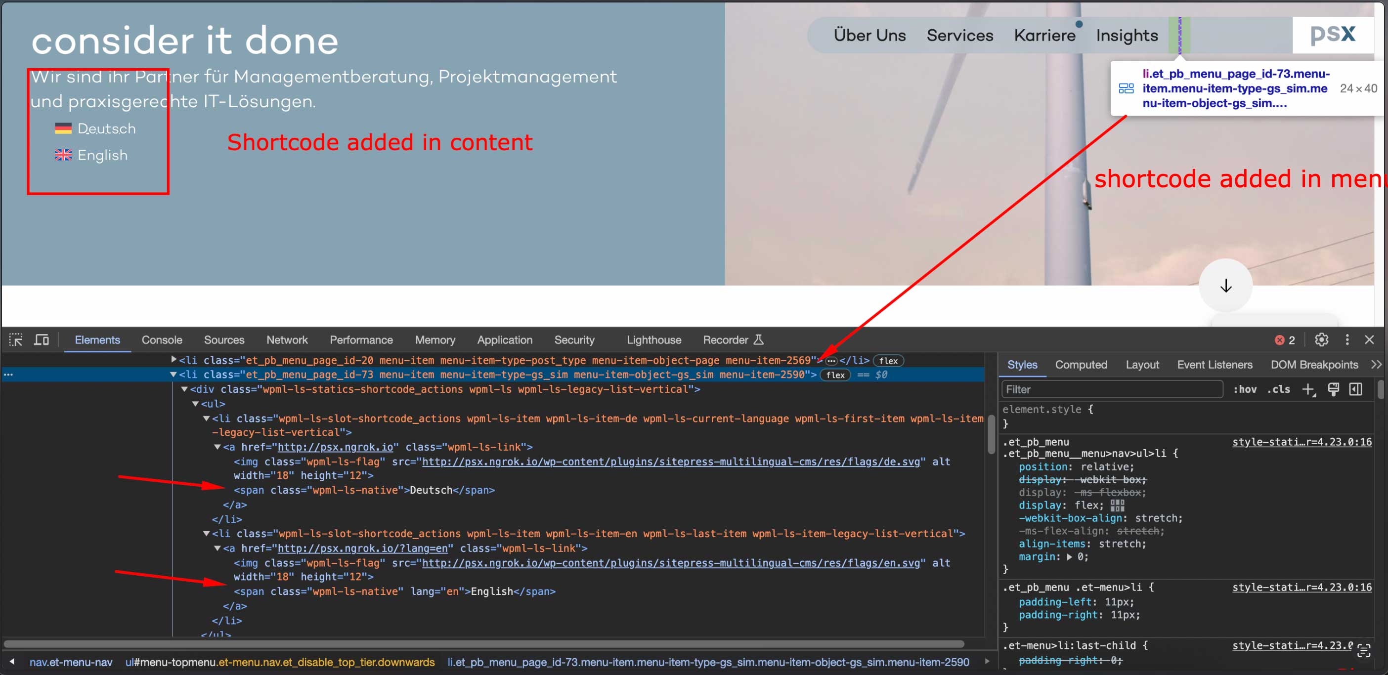

I am facing problems with widget shortcodethis is my website: hidden link (without https!!)
I am using the widget shortcode and it does not work in my menu
I dont know what else to do...
The shortcode, if is added in the content... it is working super
The shortcode, if is added in the menu... it does not work
It is not the template and is not incompatibility with other plugins. I tried to use a different template and same problem

You should add this hook to your functions.php to activate shortcodes in menus (If you prefer, you can also use a plugin called "Shortcode in Menus" but it doesn't work either).
/* ENABLE SHORTCODES MENU */
add_filter('wp_nav_menu_items', 'do_shortcode');
Once this is done, you must add a new menu item containing the shortcode: [wpml_language_selector_widget].
You will see that the language switcher does not work, it does not become visible. Something is wrong with WPML that doesn't allow you to insert the language switcher to the menu using the shortcode I have previously indicated.
All you have done in your sandbox wordpress is activate the "Footer language switcher" option from WPML > Languages > Show language switcher in footer, you are not doing what I am asking you to do, unfortunately.
Please check the image I have attached. As you can see, the shortcode shows everything correctly in the page content but in the menu the shortcode is not working.
It neither works in my Divi template nor works in the base wordpress template.

I added the shortcode to using the WordPress editor, and it works correctly. (Kindly check this hidden link)
It works as expected when adding it to the menu as a menu item description. (Kindly check this hidden link)
When adding it as a navigation label, it also works correctly. (Kindly check this hidden link)
However, it doesn't look good, and there are two empty rows because of the # link, but CSS or Javascript could fix this.
