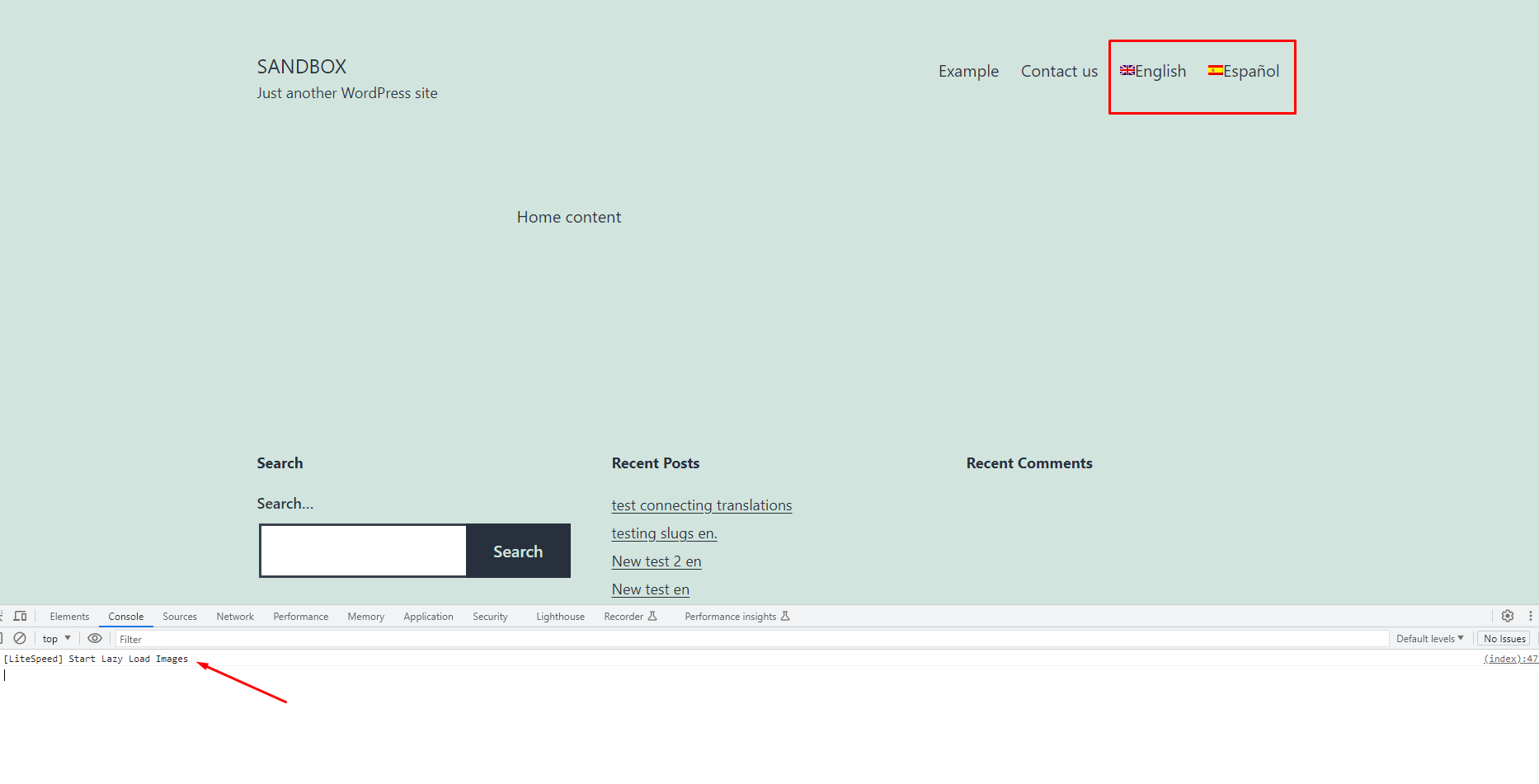

August 16, 2023 at 9:20 am #14208103
ninaB-11
I have disabled the lazy loading of images in lightspeed plugin and now seems to work fine. We would like to have lazy load enabled so this is probably not the best solution.
August 16, 2023 at 12:26 pm #14227767
Mohamed Sayed
I tried to replicate the issue on one of our testing sites hidden link, but the flags are loading without any issues. Maybe I'm using different settings.
I have created this clean sandbox setup on our servers here:
hidden link (one-click login)
I would need you to please set up WPML + the WPML add-ons as you have them on your site (they are already installed) and to also install the LiteSpeed plugin and try to recreate this issue with same settings you have.
Please don't install anything else like plugins that are not necessary, on a clean sandbox we try to use just the WPML plugins and the plugin/theme that's part of the issue
If the issue is going to take place on this clean setup on our servers too, then I can forward this to our compatibility department.
Please let me know how that goes and what you are able to find.
