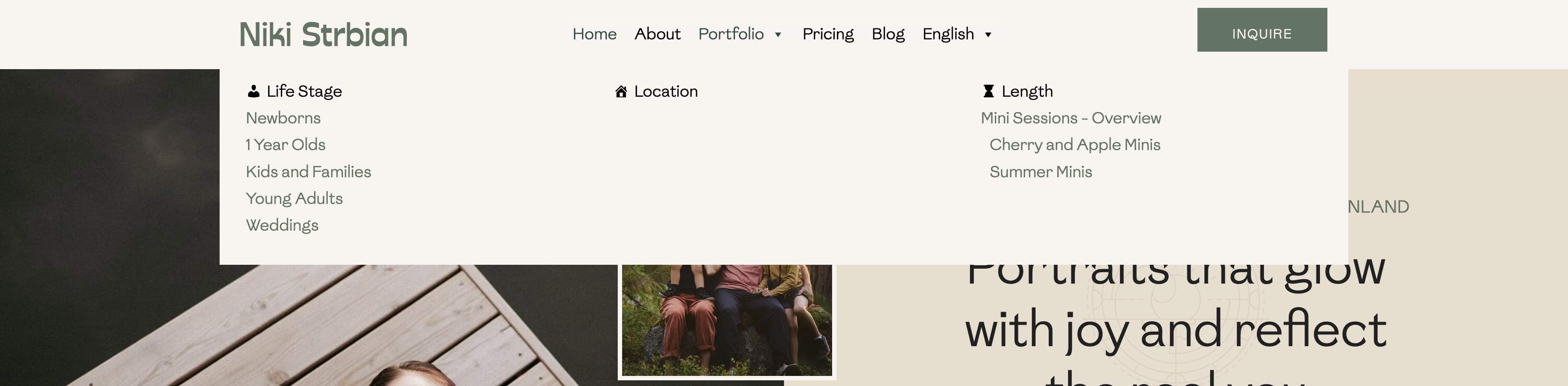

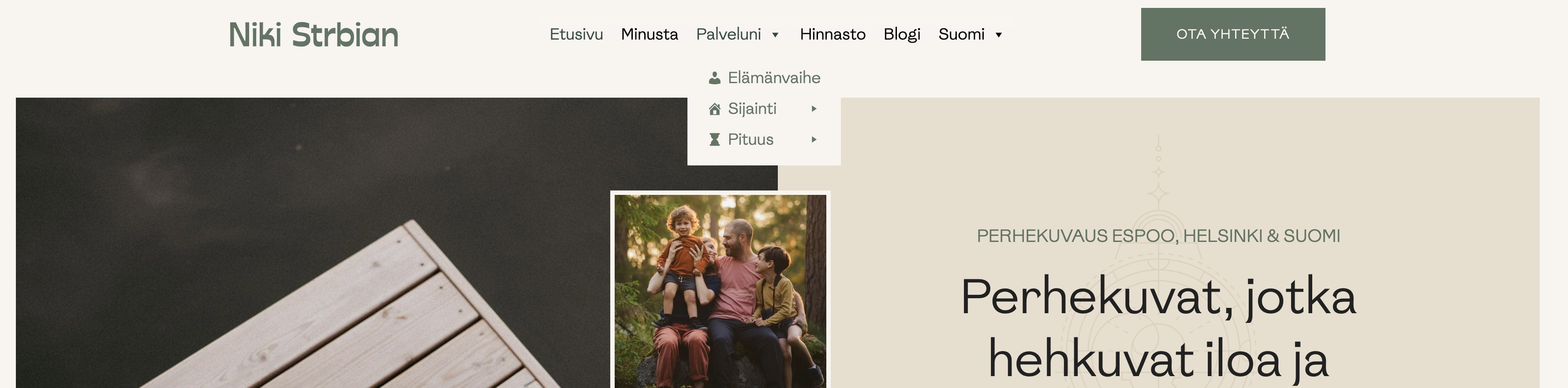

Everything else is going smoothly and we are still is process with finalising translations to the pages, but please see photos for reference with what is happening with the layout. The menu is obviously not inheriting the layout and the page has a border even though they share the same default settings. I can change this manually, but it should inherit it from the English page right? 🙂

Basically, you need to manually adjust the mega menu settings in each menu in each language. The WPML > WP Menus Sync feature will not be able to handle those settings.
If I edit the Finish menu item for Portfolio I am able to select a different layout. I have set it now to Mega Menu Standard Layout.

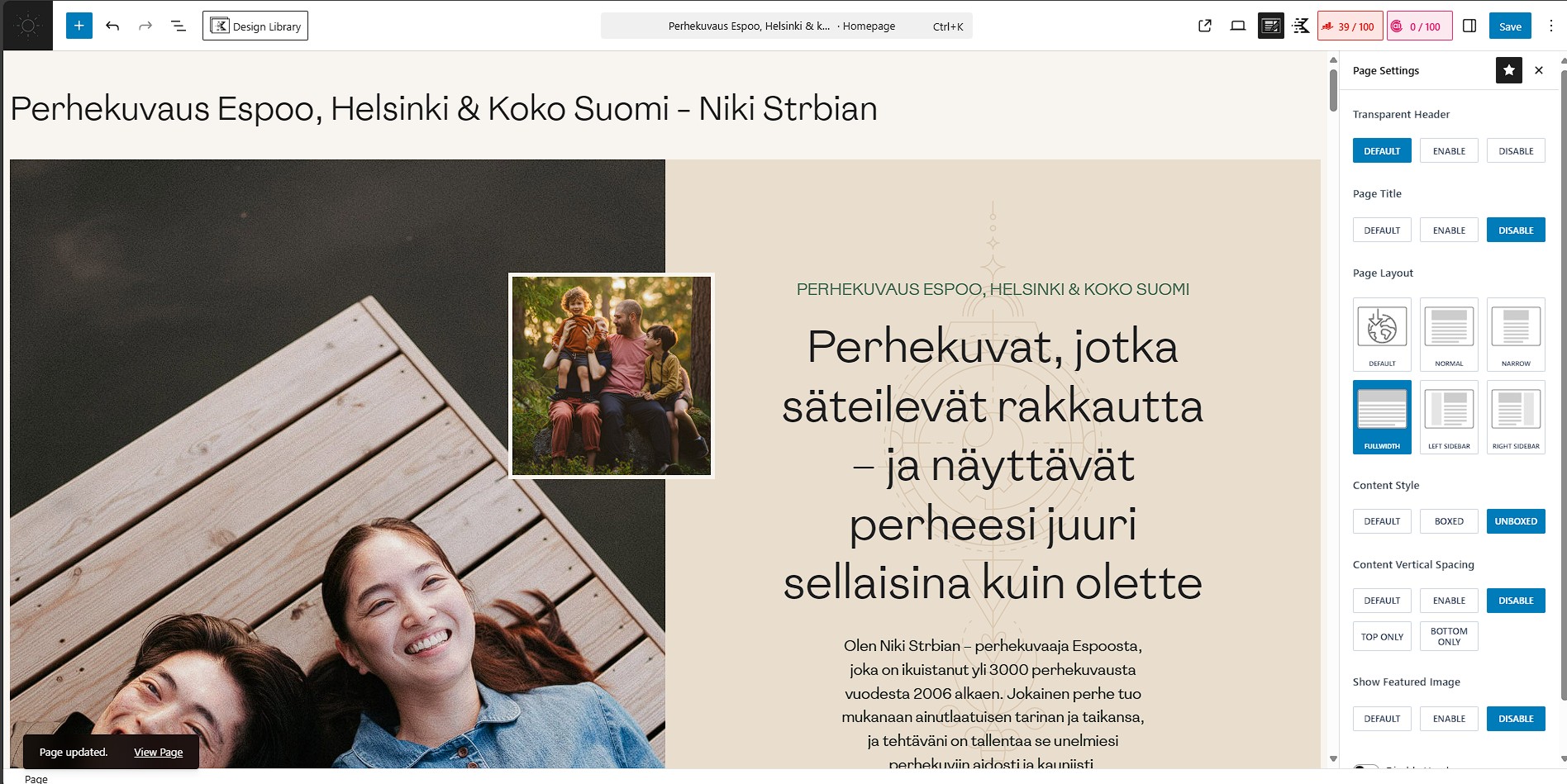

Somehow the global page settings were not identical between the original page and its translation.
See screenshot.
Now, I usually would expect that those settings will be copied over from the original page to the translation when translating the page, which seems not to be the case here.
I will run a test on a new test site to see if I can recreate the issue, but I suspect is an issue related to Kadence PRO. I will let you know in case I will need your cooperation on this matter.
May 29, 2025 at 9:33 pm #17089950

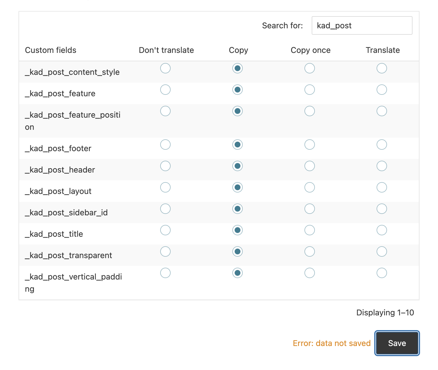

To solve this issue, go to WPML > Settings > Custom Field Translation and click the link "Show system fields" beneath the section title.
Then search for the following fields and set them to "Copy".
_kad_post_content_style
_kad_post_feature
_kad_post_feature_position
_kad_post_footer
_kad_post_header
_kad_post_layout
_kad_post_sidebar_id
_kad_post_title
_kad_post_transparent
_kad_post_vertical_padding
Now, apply the translations of your pages again and the global page settings will be copied as expected.
May 30, 2025 at 4:54 am #17090354
Kaylie McGilvray
Hi Andreas,
Thank you again for your help and quick response. I actually had these set to 'copy' already, but when I went to save my settings, it kept giving an error message that said that my selections could not be saved. Regardless, this has now been solved as the layout is inherited on the Finnish page now. Thank you so much again! 🙂
May 30, 2025 at 5:42 am #17090387
Kaylie McGilvray
Hi again,
I'm still getting the error msg when tried to save these settings. The layout is inherited on the front page but not the rest.
Please see img attached.
May 30, 2025 at 3:28 pm #17092731
Indeed, I realized those error messages but I could not confirm that the settings were not saved.
It seems the minimum requirements on the server are not met:
https://wpml.org/en/home/minimum-requirements/
Could you please increase the WordPress memory limit (WP Memory Limit) to at least 256 MB? WPML requires at least 128 MB.
Your current values ​​are:
PHP Memory Limit 512 MB
WP Memory Limit 40 MB
To do this, you need to connect to your website's server and open the wp-config.php file in a text editor. The file is located in the WordPress root directory.
Add this code to the wp-config.php file to increase WordPress's memory:
define ('WP_MEMORY_LIMIT', '256M');
Add this just before this comment:
// That's all, stop editing! Happy blogging.
The current values ​​can be viewed under WPML > Support > WordPress.
These settings can be restricted directly by your hosting provider. Therefore, I recommend contacting them and asking them to change them directly if the changes are not applied immediately.
If this will not solve the error message, please let me know.
