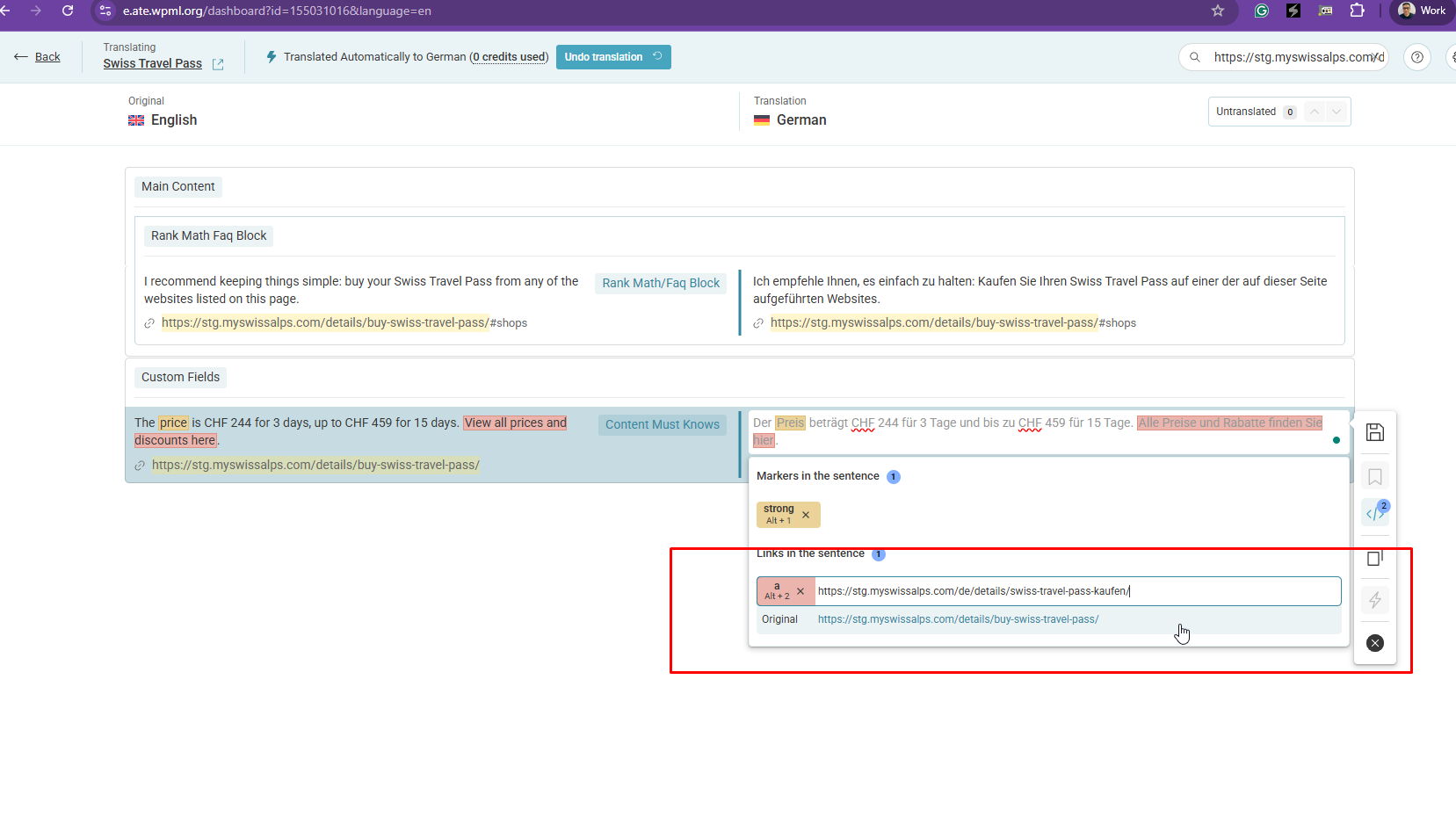

Thanks for your reply. I've checked, and I can see the untranslated links using the Advanced Translation Editor as shown in the attached screenshot.
I've tried both methods listed here https://wpml.org/faq/how-to-translate-links/#fixing-links-that-point-to-the-wrong-translation and it's not working.
It looks like WPML failed to identify the translated custom posts and you'll need to manually correct it.

On the live site, I clicked the "unlock" option in the translator and corrected the link manually. It did not change in the frontend yet. Perhaps because of caching, but it's already 16 hours ago, and still nothing changed. Did this work for you on the staging site?
Even if it works, how come WPML failed to identify the translated custom posts? If everything is setup correctly, I suppose this is a bug?

I found that the link was not translated into German, so I’ve updated it for you as shown in the attached screenshot. The link "Alle Preise und Rabatte finden Sie hier" is now working at hidden link

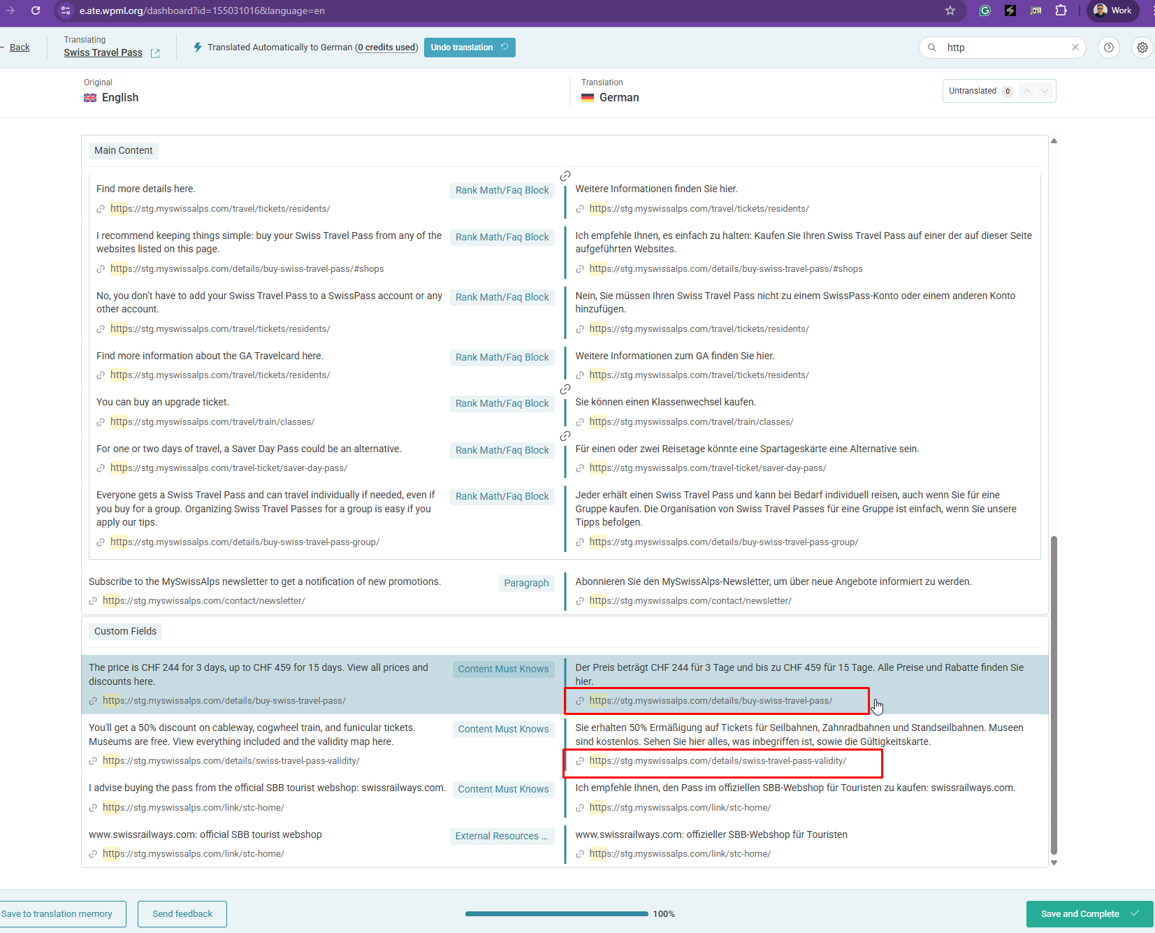

No, I haven't made changes. Links to the new post type are still incorrect; here are some examples:
- On hidden link, the link in the button "Alle Preise und Rabatte ansehen".
- On hidden link, the first two links under "Swiss Half Fare Card – Kurzüberblick".
