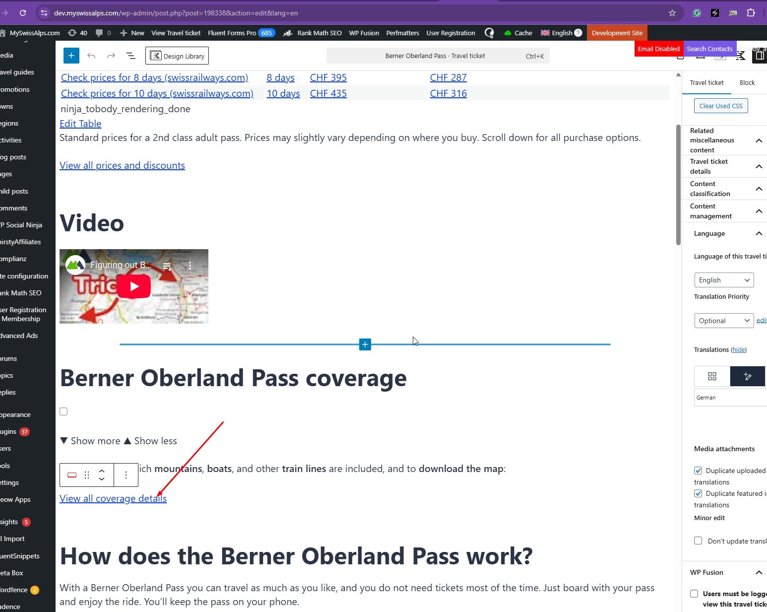

Yes, I had updated WPML as instructed. I tried again: the text links are fine, but the button "Alle Gültigkeitsdetails ansehen" is not. Even though WPML is instructed to translate that custom field too, please see my very first message.

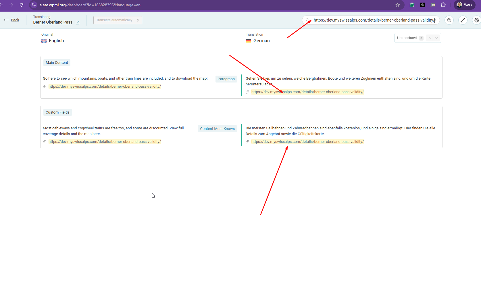

Thanks for your reply. Could you try adjusting the button links in the Advanced Translation Editor when you translate it here? hidden link . check out the attached screenshot.

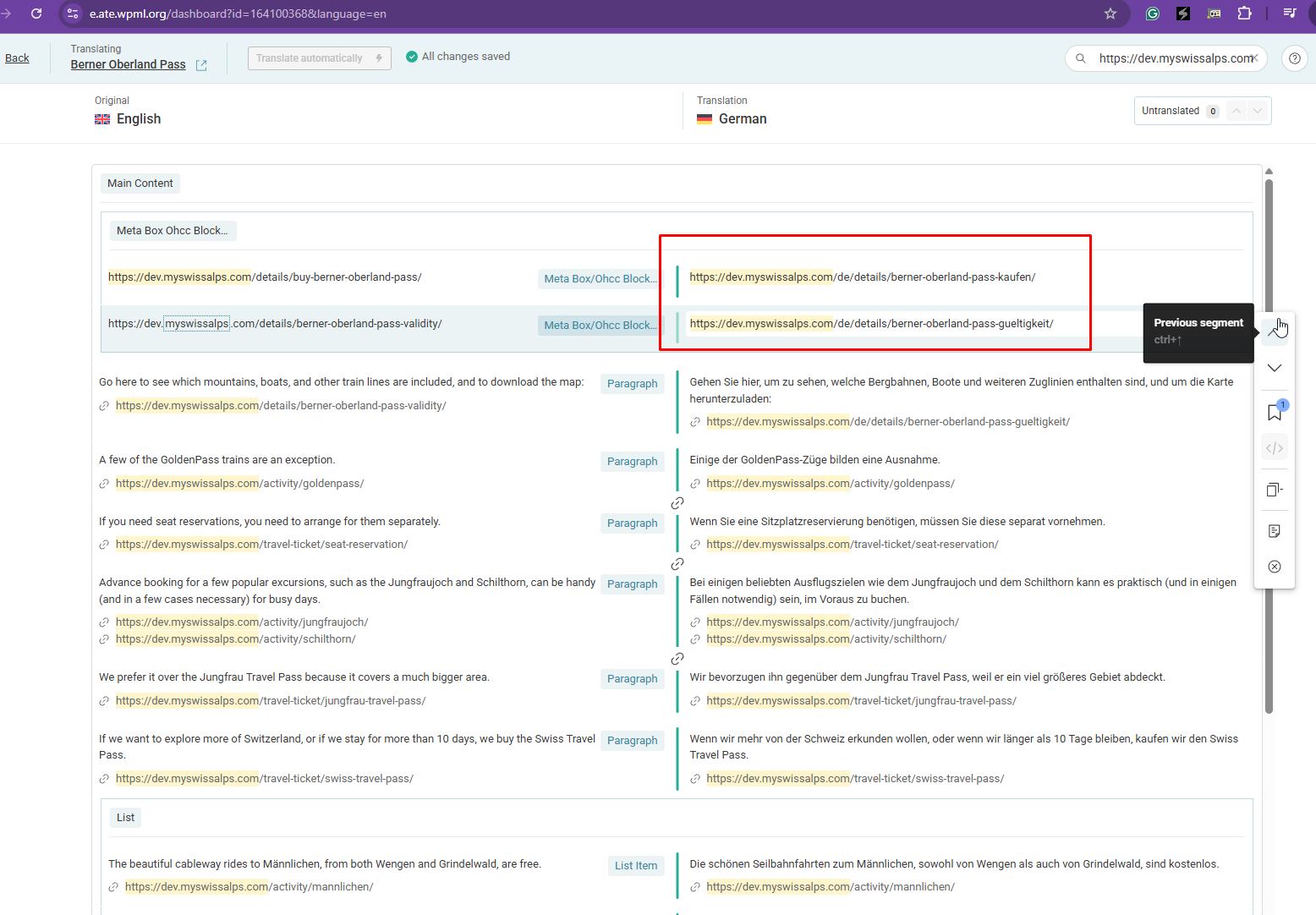

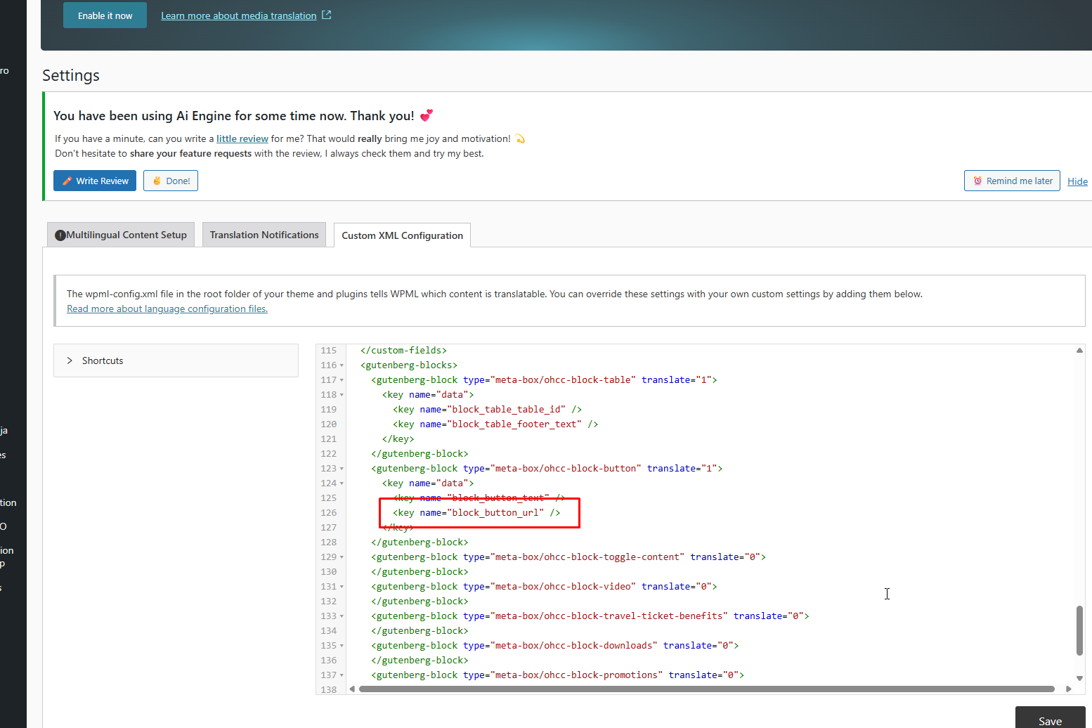

Thanks for your reply. I've added the custom XML configuration below and the links should be translatable now as shown in the attached screenshot.
 <gutenberg-block type="meta-box/ohcc-block-button" translate="1">
      <key name="data">
        <key name="block_button_text" />
        <key name="block_button_url" />
      </key>
    </gutenberg-block>
Please check now and I apologize for not double checking earlier.
