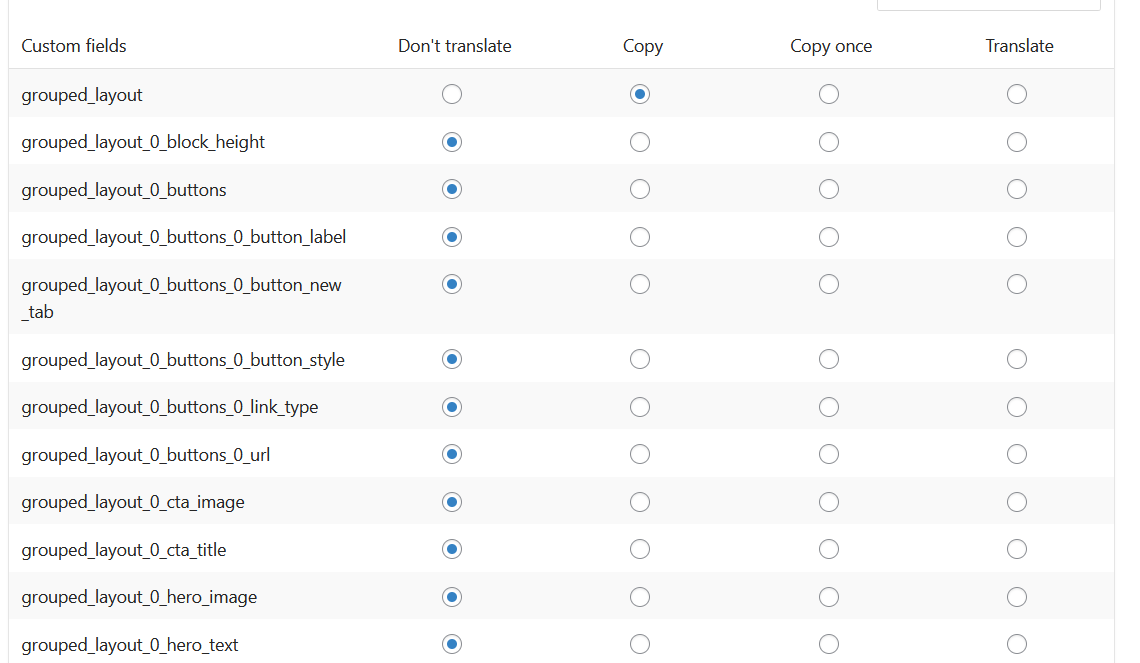

Eligos Alexander
I did set all the fields as per the recommendations. Only the base-level fields came through to the custom fields settings. None of the flexible content fields came through.
I believe the code lacks the ability to traverse sub-fields to check for translation preferences.
