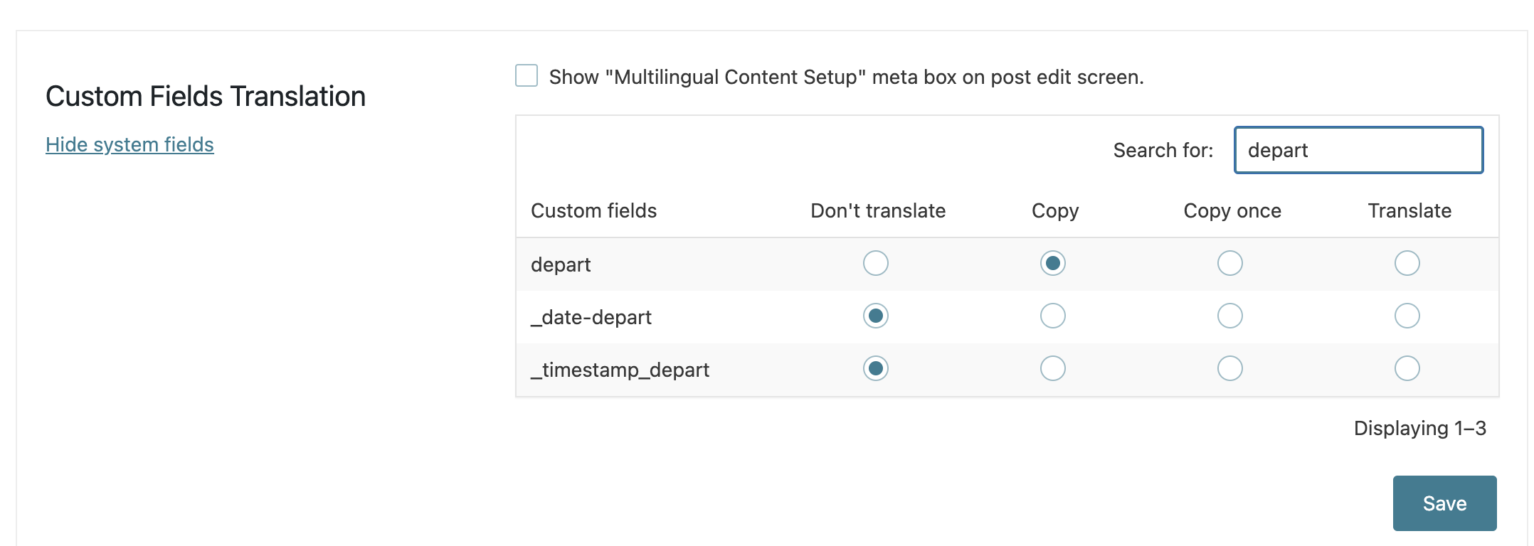

First, as it only happens in the default language, I'd check if the issue persists with WPML deactivated.
If it doesn't, please check the screenshot attached. I think those fields need to be translatable (or at least "copy once"). You'll need to click on "show system fields" and use the search box to locate them. And you'll need to update the post and its translation so it takes effect.

April 30, 2025 at 7:20 pm #16985208
alexiaC-4
Thanks Otto, it worked!
