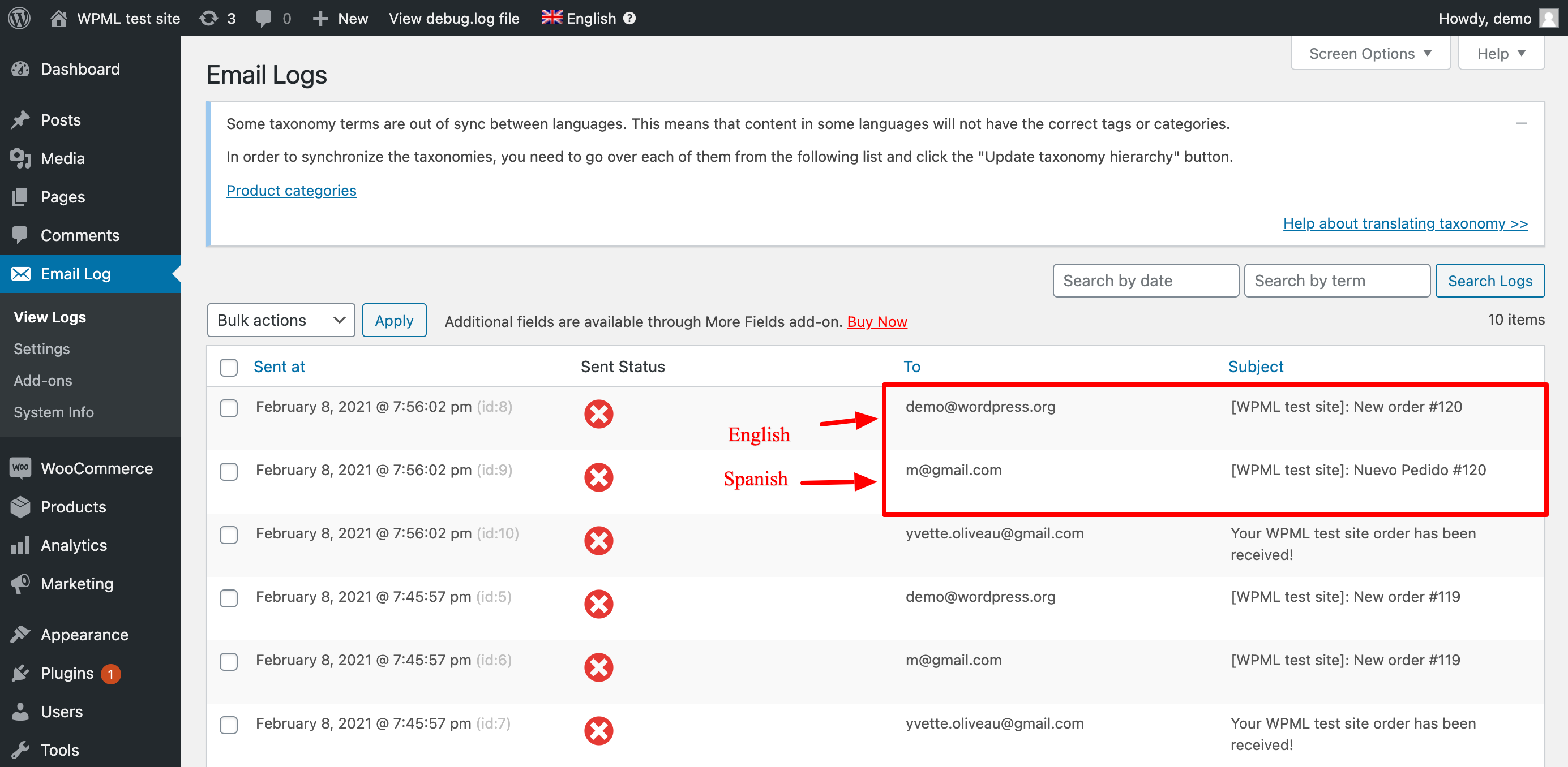

Here i have defined a shop manager with email m@gmail.com with the language "Spanish" as the preferred language in the user profile.
There is also a standard admin role "demo" that uses "English/ Default language" n the profile.
I then place an order in English, and this makes an EN order.
You can see the New Order email results in the image below.
2 admin emails are created: one iin Spanish and the other in English
Please try this yourself to see that this is the baseline default behaviour. Then we can see what is different with your site.

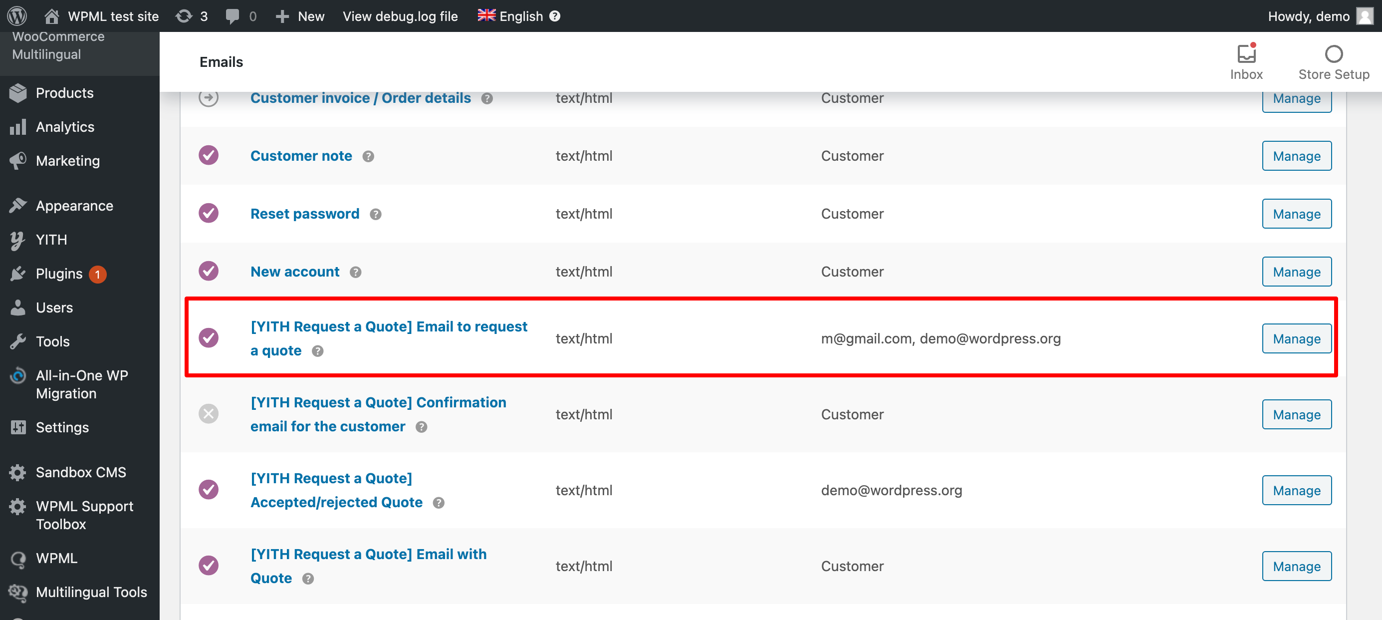

You just had to "manage" / configure the Request-a-quote email to have it also send the email to the shop manager. I have done that for you.
So please try again.

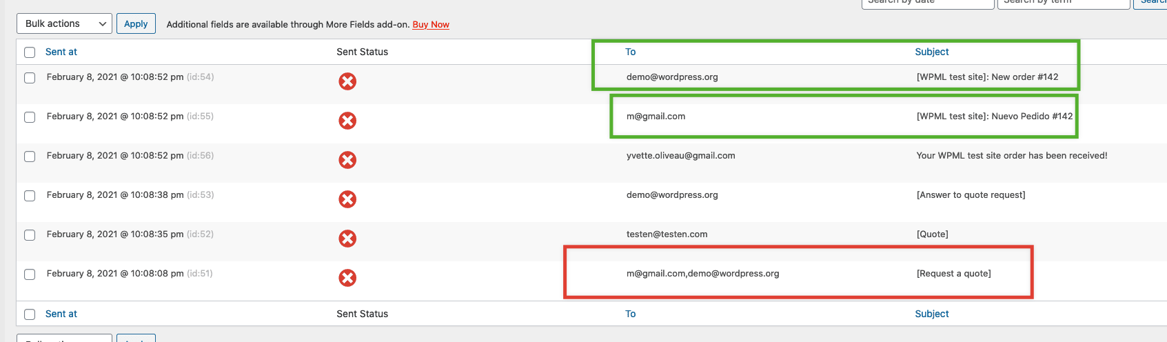

Thank you, I took the test again,
the message via the quote plugins only sends the message in English to the shop manager (normally this email must be in spanish)
and in green in the image you could see that the default woocommerce message is sent in the correct language
(I would like to add that in my side the templates are well translated normally
because the nl or fr client does receive in the language defined here -> wpml_language)
