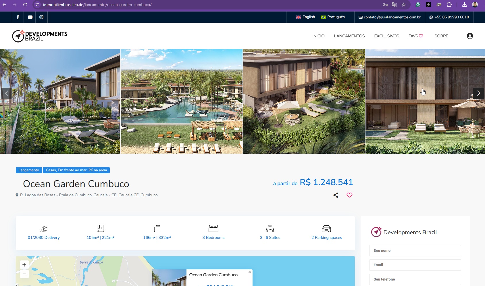

If I translate a property which is present in english, than in portugues language changing the images the order. It happened on the second property already.

1. Incorrect Image Order (Possibly Cache-Related)
As shown in this screen recording hidden link , the image order is correct in the Portuguese backend. However, on the frontend, the order appears incorrect. Interestingly, when switching the setting to "Different languages in directories" under WPML > Languages > Language URL format, the images display in the correct order.

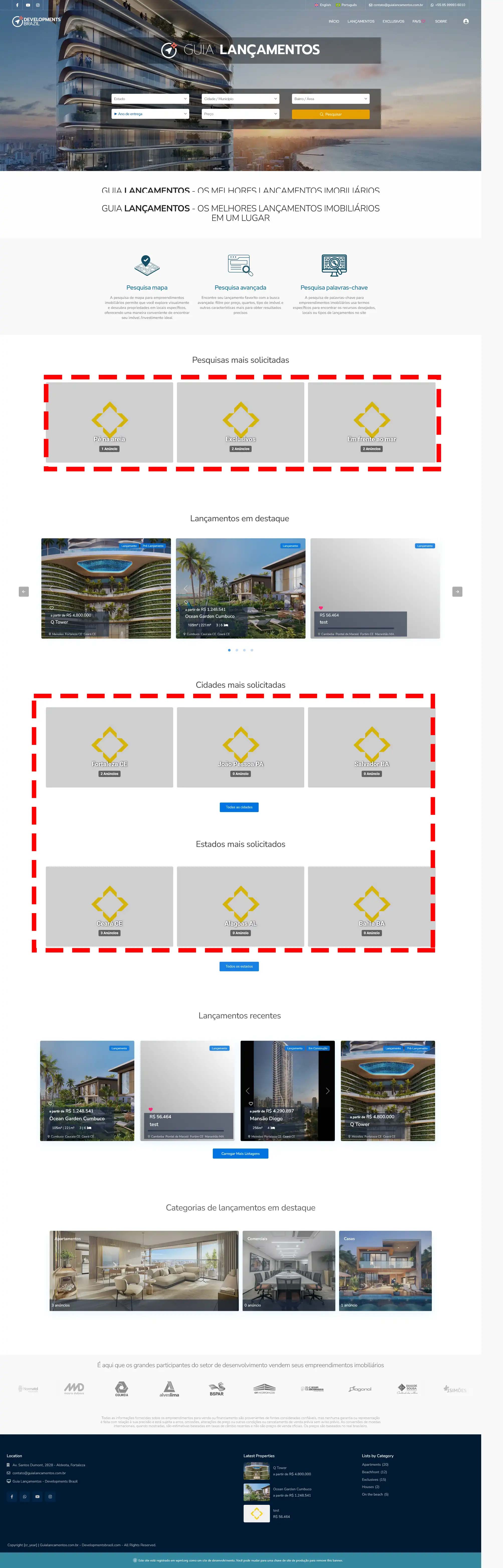

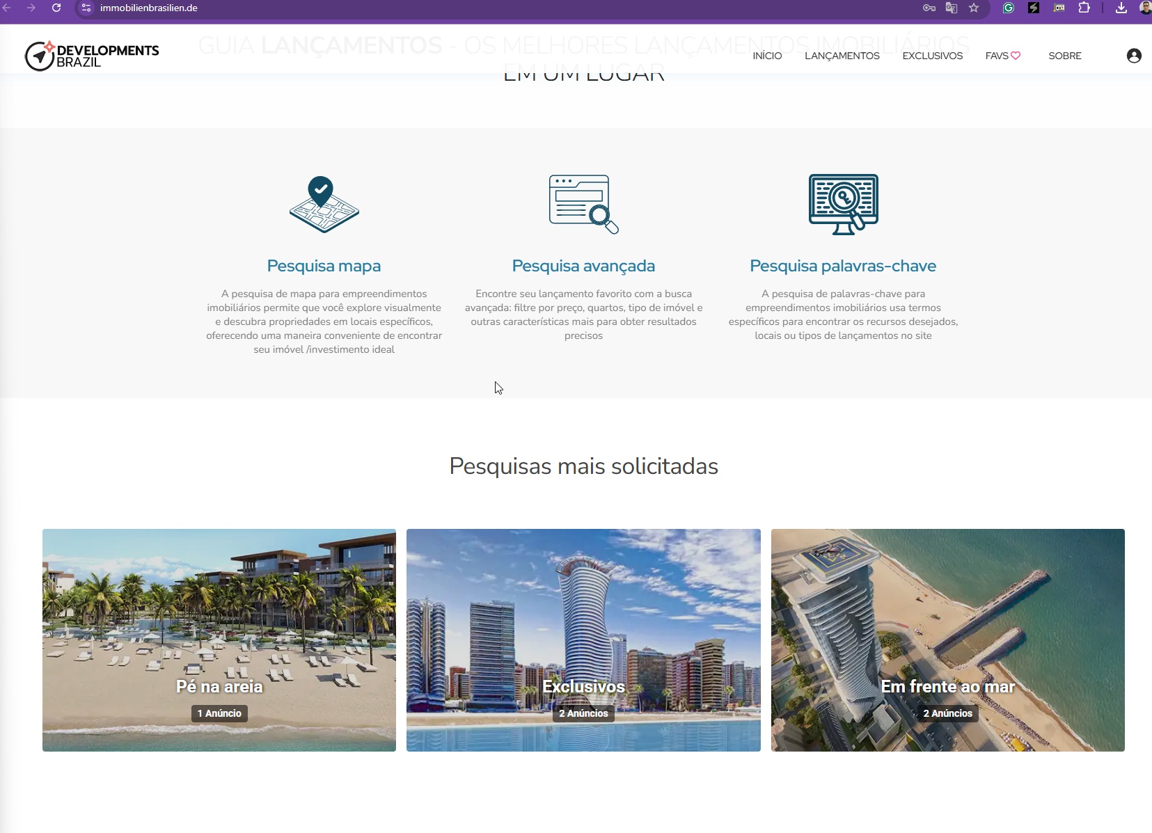

The problem persists with the order of the property images and the category images, which are filled in English and Portuguese (because I was initially told there was no automatic translation option).
Sometimes they appear, sometimes not (see homepage: On the Beach – Beachfront – Exclusive…)

Also this grey images in screenshot don't show up, like I mentioned, which are filled in English and Portuguese (because I was initially told there was no automatic translation option).

I translated this listing yesterday hidden link and the images are not in order in the Portuguese language. But when I checked today, hidden link , it is in the correct order as shown in the attached screenshot, but with an extra featured image showing up. Did you do anything on your end? I suspect a server cache issue.
The images that you highlighted on the homepage are showing up for me in Portuguese, as shown in the attached screenshot. Could you recheck?

Hello Kor, no, the problem with the order of the images still exist.
June 23, 2025 at 3:54 pm #17161492
Thanks for your reply. It seems to be a caching issue. Here's what was done to fix the property image order: hidden link
1. The property was edited and resaved: hidden link
2. Then, I translated the property into Portuguese, but the image order was still incorrect on the frontend.
3. Logged into hidden link using incognito mode.
After clicking “Clear WPResidence Cache,” the image order displayed correctly in Portuguese language: hidden link
