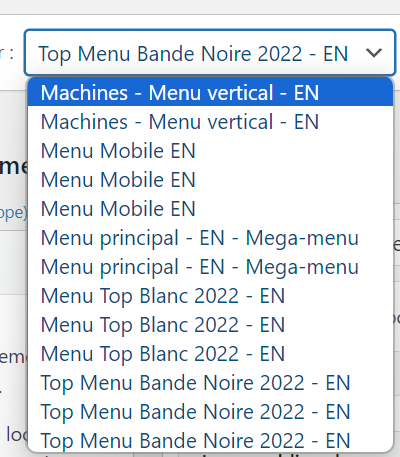

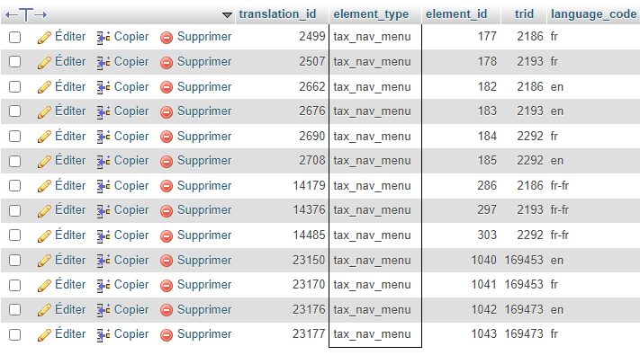

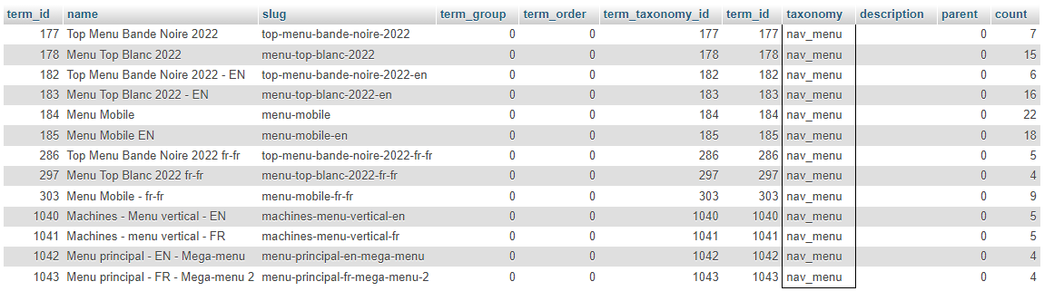

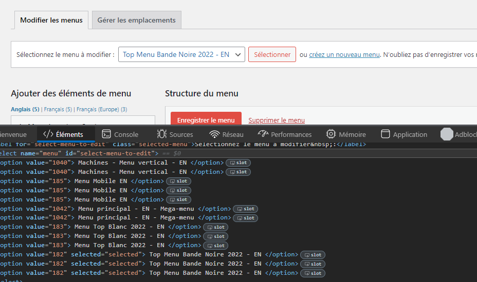

I am managing a multilingual site using WPML and encountering issues with the menu display in the WordPress admin. The menus appear duplicated and in one language, although they are correctly separated and identified in different languages in the database and the left menu.
Menus in the WordPress admin are intermittently showing all in one language instead of separate languages. This issue occurs occasionally, and the menus sometimes revert to displaying correctly without any clear reason.
Why do the menus in the admin appear all in one language instead of multiple languages?
What could be causing the intermittent nature of this issue where the menus sometimes display correctly?

Ok the issue is back on the staging so you can see it.
Plus, some menus have content that has disappeared.
