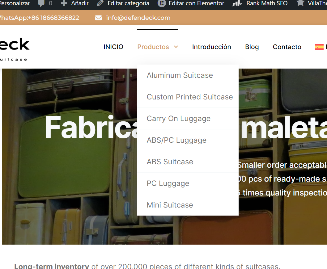

Hi, I want to synchronize my existing menu but failed after reviewing the guidances.
Would you please help me?

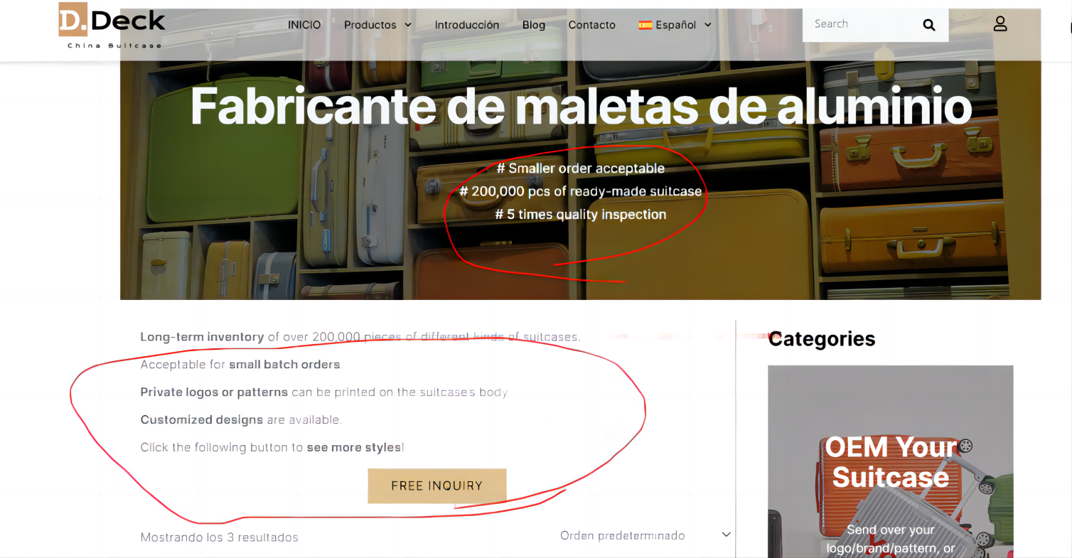

And I found my theme template hasn't been translated.(photo No.2)

After reviewing your website, I noticed that all the menu items, except for the Product Categories, are correctly translated into various languages. This might indicate an issue with the synchronization of the product categories, leading to the improper functioning of the category links in the menu. Would you please try the following and check if that helps in solving the issue?
- Please go to WooCommerce > WooCommerce Multilingual > Categories
- Click on the "Synchronize Categories" button at the bottom of the page.
- Once the Synchronization process is completed, please try to Sync the Menu again by following this guide: https://wpml.org/documentation/getting-started-guide/translating-menus/#easy-customizable-wp-menus-sync
- Clear the caches from your site and browser as well.
I hope the categories in the Menu will appear properly after completing the translation. Let me know the update, please.
About the problem where the Category template isn't displaying translated content - If you've used Elementor to create an Archive template for the category, ensure that this Template has been translated into the other languages. If not, the content within the template won't be shown in the translated versions. To understand the process of Translating templates created using Elementor, please check the guide below.
- https://wpml.org/documentation/plugins-compatibility/elementor/#translate-elementor-templates
If they have already been translated, please check by updating the translation. To do so, please open the template in the WordPress editor and make a small change in the title. After that, update the template and its translation.

I've checked and managed to resolve the issue with the Categories in the Menu. The problem was caused due to including custom links for the Categories in the Menu, rather than adding the Product Categories directly.
By inserting the Product Categories in the Menu and synchronizing the menu, I was able to solve the issue. Now, the Categories in the menu are correctly updated in other languages according to their translations.
Please check and let me know if there is anything else if you need help with. I will be happy to help.
