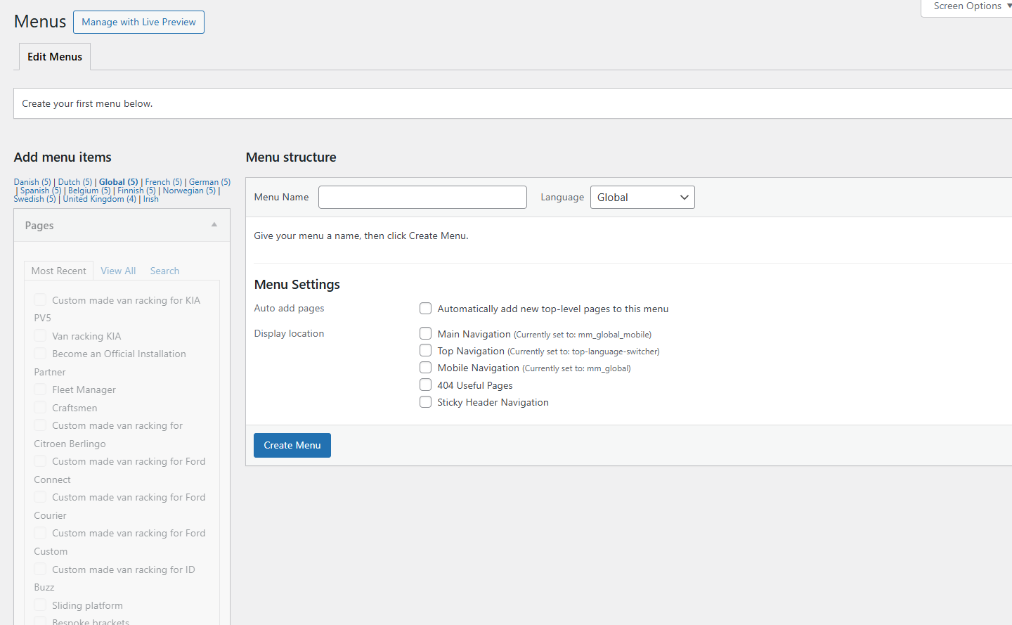

I have an issue, where the menus from my website dissapear under "appearance".
The only thing I get is "Create your first menu below"
But I already have menues.

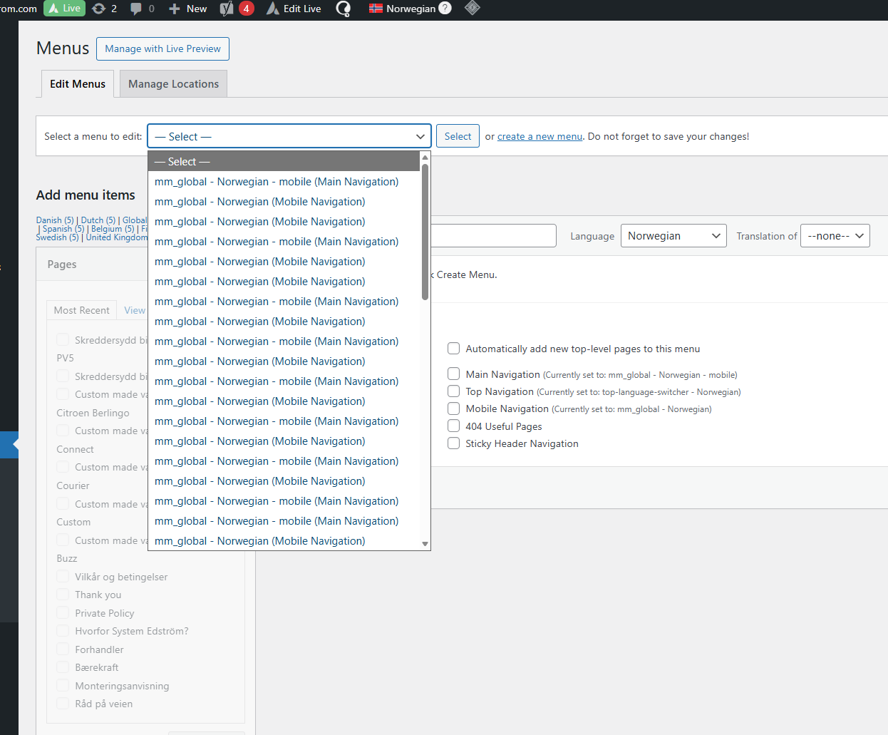

And the second thing, is if i change language i can get all the menues shown in another language.
But I have to look at which language it is. So in this case "norway" shows all the menus. See attached imags.
I have tried WP-menu sync but that just crashes.
And all of a sudden the menus can reapear.
And then the same issue appears again after a while where they care gone.

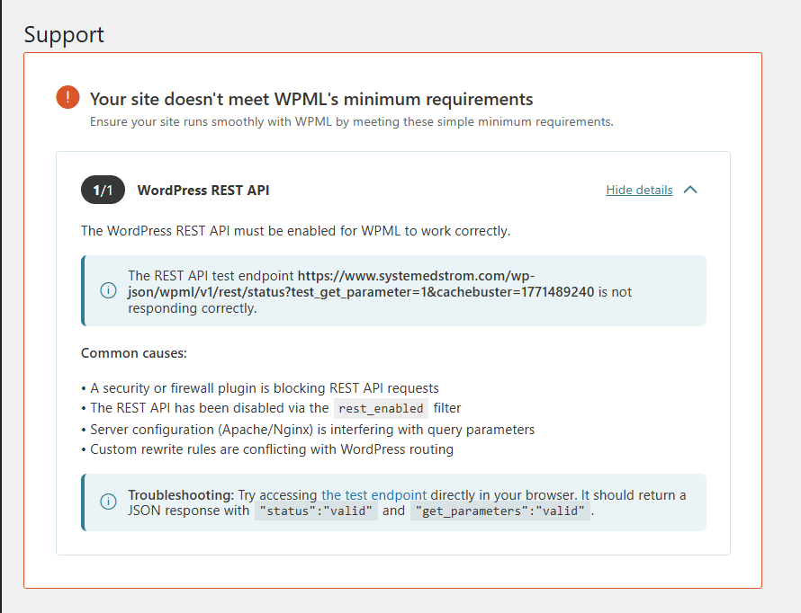

I can setup a staging website if you want and give you access to that one?
Also, I have been having this issue, and it's almost everytime I do a plugin update.
Never had this issue before and I have been using WPML for many years.

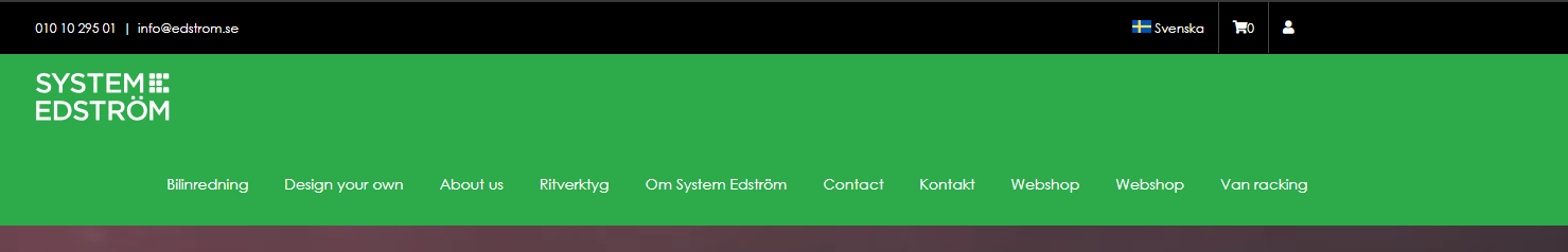

If i go to the Swedish language on frontend.
The menu now shows ENG menu options.
And there are missing submenus.
So something is still wrong.

Looking at the Swedish langauge on frontend, this is what I see (see attached image).
This was never an issue before.
And I never did a string translations on the menu items, since the menu is and can be different in other languages. So not always the share the same menu structure. And that is how I want to keep it.
And if i select "Wp menu sync". After a while i get a 404 error so I can't do a sync.
