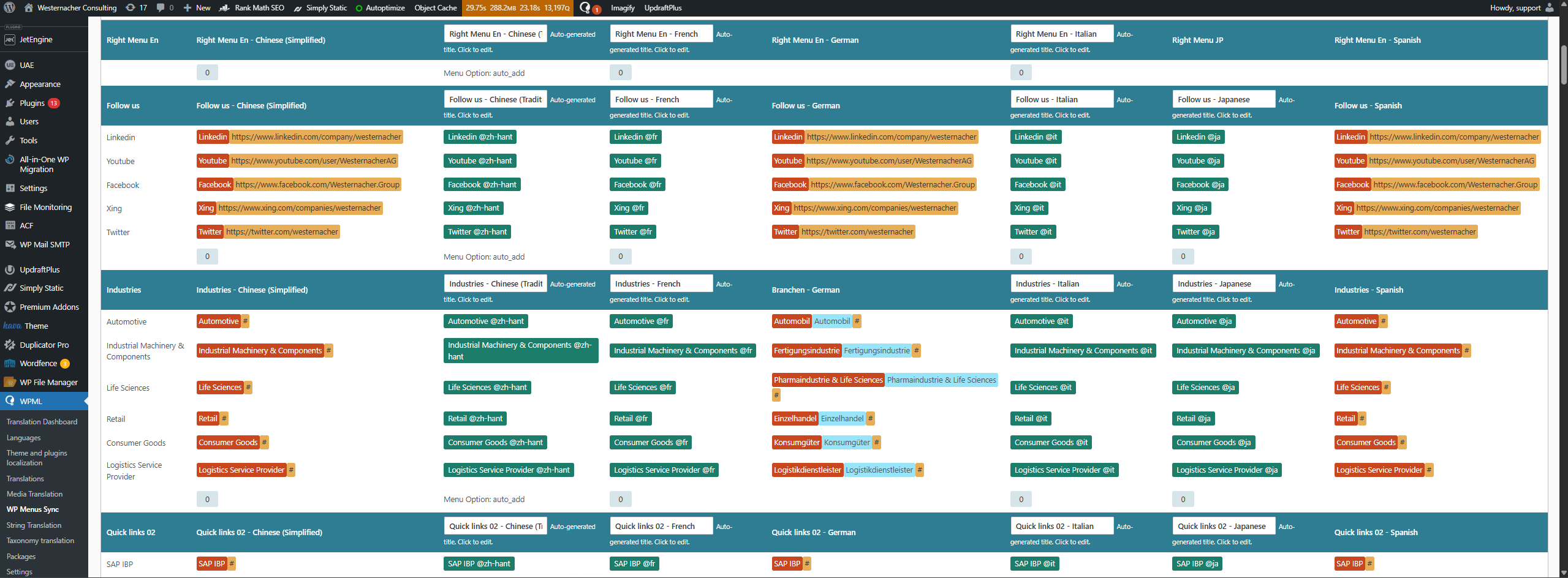

March 3, 2026 at 5:48 am #17866688
Prosenjit Barman
WPML Supporter since 03/2023
Hi There,
I hope you’re doing well.
I’ve set up the same Nginx-based development environment locally and imported the site copy there. The installation completed successfully, including all content and menu items. When I accessed the Menu Sync page in my environment, it loaded correctly without any timeout issues. The PHP timeout is also set to 300 seconds, just like on your server.
Since the Menu Sync works properly in my environment under the same timeout limit, this strongly suggests that the issue is environment-specific and occurring only on your server due to some specific configuration. That said, we still need to determine what exactly is triggering the timeout in your setup.
To investigate further on your production site, I began analyzing logs to identify any slow scripts or database queries that might be causing the delay. I did not deactivate any themes or plugins during this process.
As part of troubleshooting, I installed a small utility plugin to clear the PHP OPcache (bytecode cache). The goal was simply to ensure that cached compiled PHP files were not affecting the logging behavior. However, after clearing the OPcache, the site unexpectedly started showing an HTTP 500 Internal Server Error, which is unusual. This plugin is commonly used just to clear OPcache and typically does not trigger server errors.
I sincerely apologize for any inconvenience this may have caused.
If you have FTP access, you can resolve this quickly by either:
- Deleting the OPcache plugin folder from `wp-content/plugins`, or
- Renaming the plugin folder to deactivate it.
That should restore the site immediately. Additionally, your hosting provider may have more detailed server-level logs explaining the 500 error, which can help confirm the exact cause.
If you prefer, you can share FTP access via the private box, and I’ll take care of it for you.
Since this is a production site, continuing deep debugging there carries some risk, as we’ve just seen. Do you have a staging or development site where the Menu Sync issue can be reproduced? If so, please share access to that environment instead. I can then perform all further investigation there to ensure your live site remains unaffected.
I’ve enabled the private reply option so you can securely share any access details.
Once again, I truly apologize for the inconvenience during this investigation. I appreciate your patience and cooperation, and I’ll proceed very carefully from here.
Prosenjit
