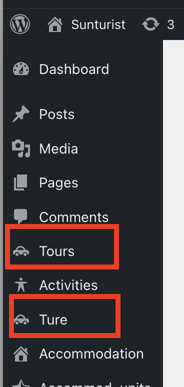

What jumped out at me when I installed a copy of the site was that in the sidebar we have both a Tours and a Ture post type available.
Not the posts, but the post types.
So if you disable WPML and return to the same page you will see that each post type is registered 4 times, and one of the times that the Tours post type is registered it is registered with a slug of ture.
I am 99% certain that doing this is wrong (you certainly wouldn't do this with any other tool such as CPT UI).

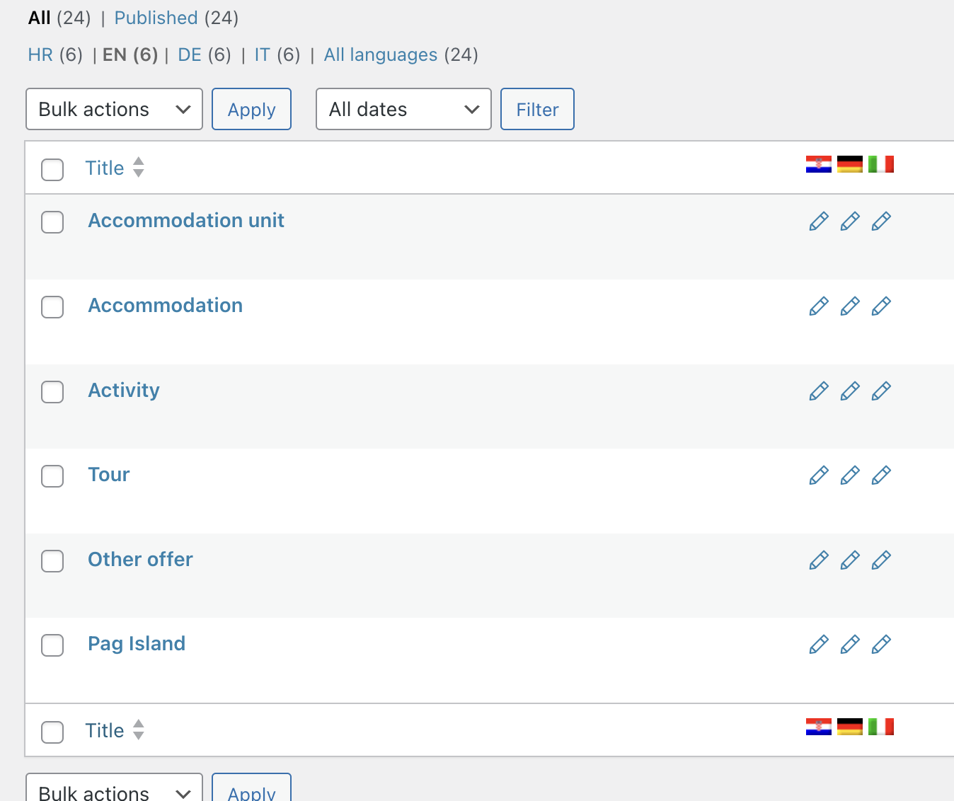

Go to WPML > Settings > Post Types Translation and you will see that the Meta Box internal post type (used to store details about the post types being registered) mb-post-type is set as translatable, as we as the custom post types (such as Tours) being marked as translatable. (But not the "ture" post type.)
The mb-post-type post type should almost certainly be set as not translatable, which will eliminate the duplicate post type registrations, including that of the "ture" post type, which I would expect to resolve problems with post type slugs.

You second tier support mentioned "Ture" as additional post type which exist with the original post "Tours".

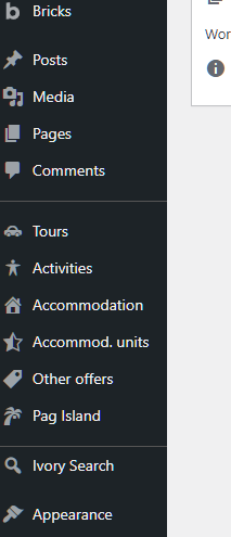

That post type is not what I have created. This is what you have created or your support team. Please, look at the my screenshot (I restored my backup meanwhile) - there is no post type "Ture". It's just "Tours". Somebody also changed some other elements, so that's why I was a bit angry, and realized I will have to bring back my backup (backup restore).
I mean, it won't be the problem if you (or anybody else) bring back the original situation, and not leave those changes active - because we can see now, those changes lead to wrong conclusion.
So, once again - there is no another post type "Ture". There is just "Tours" (check my screenshot). Please, ignore that post type - it doesn't exist on my Site anymore, it something you or your support colleges created and now that same thing is confusing you.
