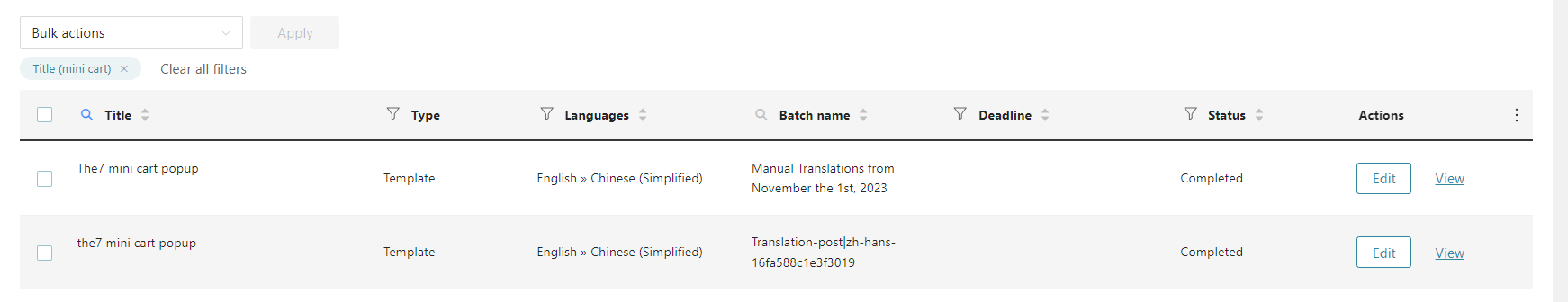

I've tried translating my "the7 mini cart popup" but it hasn't been translated. See attached image.
And with the translated template, is there a way to delete the translation? Thanks.

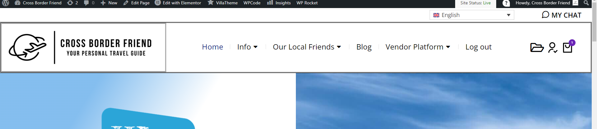

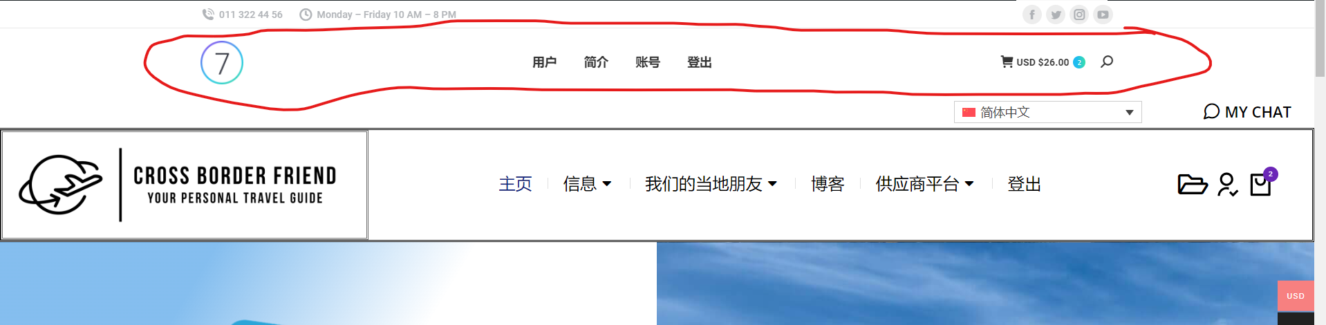

Thanks for that, but since then my translated site has came up with a secondary header menu as shown in the image. This header does not appear in the original language. Hopefully you can reply to this asap as this is quite critical for the whole site to work, thanks

The issue occurs because the header template in Chinese is not set to display on the Entire site so both Elementor header and theme header are displayed. I fixed that issue on your site. Also, please don't move the translation of the popup template to the trash. I've restored it back to make it work properly.

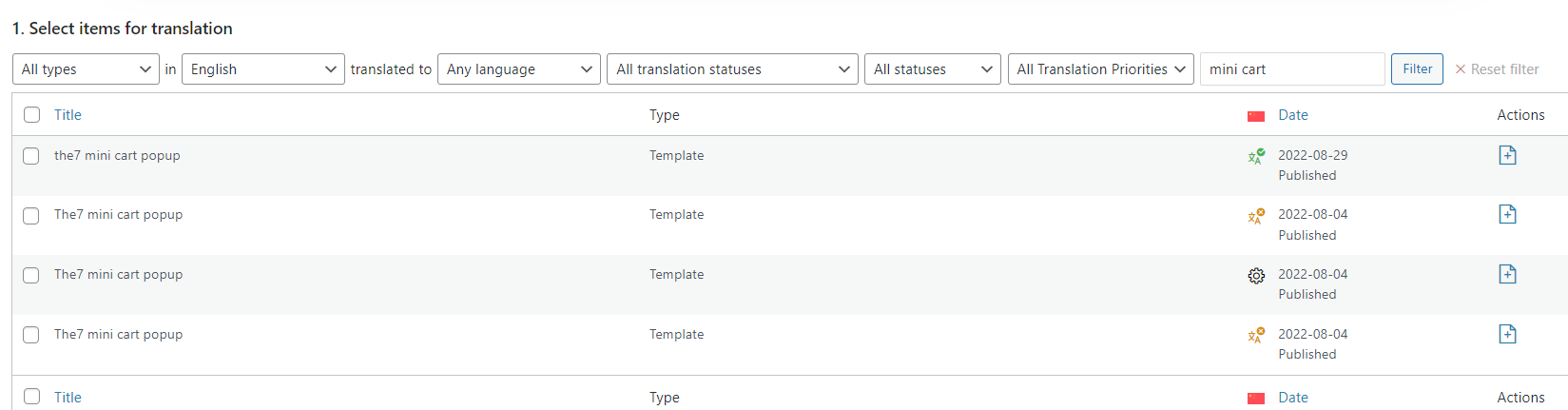

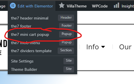

Also with the translation template, may I know how do you find which one to translate? I am having trouble figuring out what to do when alot of these unused template all appeared in the translation. I would have thought my mini cart template is the one with small letter "the7" since that is what shown in the Edit in Elementor header. (See image). Can you please advise on this?

You are right to find the template: visit the page in the frontend > hover over the Elementor button in the admin bar > edit the popup template. In the admin area, you can translate the template when editing it.
If you want to find the correct template in the list, you can see the post ID in the URL. I also suggest removing other templates with a similar name if not needed.
Regarding the header template, I just delete the translation template in Chinese > Re-translate it to sync the condition display of Elementor (Entire site).

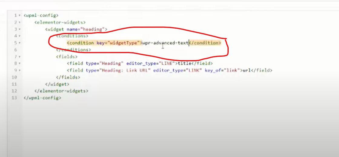

The process of the video provided doesn't seems the same with what you've done for me on the menu cart earlier. With the code given in the documentation, there was a condition key where you'll need to replace it by doing a sequence of work, but your code seems a little different. How did you find the widget name to be "the7-woocommerce-menu-cart" when the name of it is "the7 mini cart popup"?

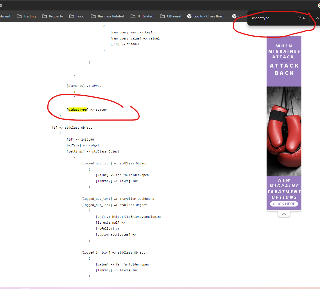

Can you help me to translate the mob menu as another example please? I've got a series of massive codes during Unserialise when I was trying to translate it... (as you can see in the image, I got different type of Widget type here)
Thanks!

According to your screenshot, there are 14 widget types and you should check all of them to find the widget needed. I just follow step-by-step in the documentation to find and translate the widget.
Besides that, you can use the plugin Multilingual Tools to get the custom XML configuration code when editing the template/post, please check screenshot attached. And follow the documentation
https://wpml.org/documentation/related-projects/wpml-compatibility-test-tools-plugin/
And here is the custom XML configuration code to translate the text of The7 Login widget in the mobile popup menu, the condition tag is not needed in this case so I removed it.
