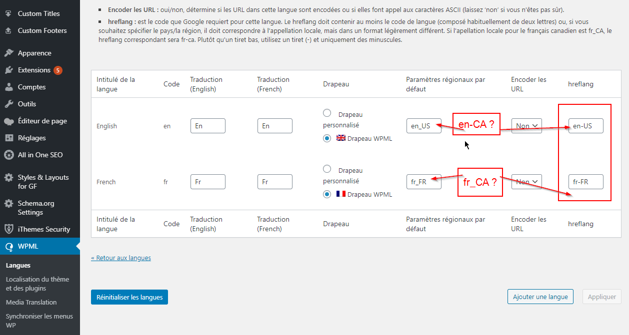

Found an error at ahref.com Missing reciprocal hreflang (no return-tag) in Ahref Site Audit
See attached. How can I fix it?
Read your documentation on this page: https://wpml.org/documentation/support/adding-hreflang-wordpress/#troubleshooting
Please check my hreflang settings ( see attached). Now, I am thinking to change it to en-CA, fr-CA because we are in Canada. Please let me know if I can make this change manually directly in the settings.
What is the link to your site? hidden link

I opened hidden link and checked the source code, this is what I find there:
<link rel="alternate" hreflang="en-us" href="<em><u>hidden link</u></em>" /><link rel="alternate" hreflang="fr-fr" href="<em><u>hidden link</u></em>" />
And If I open hidden link I also find this:
According to this: hidden link.
would that not mean that they in fact have reciprocal hreflang and that Ahref Site Audit is giving incorrect results?
I am also puzzled by results as shown https://wpml.org/wp-content/uploads/2021/02/8011137-hreflang.png, is it not showing correct but then incorrect results for the same url?

I first, contacted my AIOSEO plugin support and they had the same reaction: Ahref Site Audit is giving incorrect results!
I needed a second opinion on that matter, and I appreciate your time and support. Thanks for looking into it.
At this moment, I am going to address this issue with the Ahref support.
