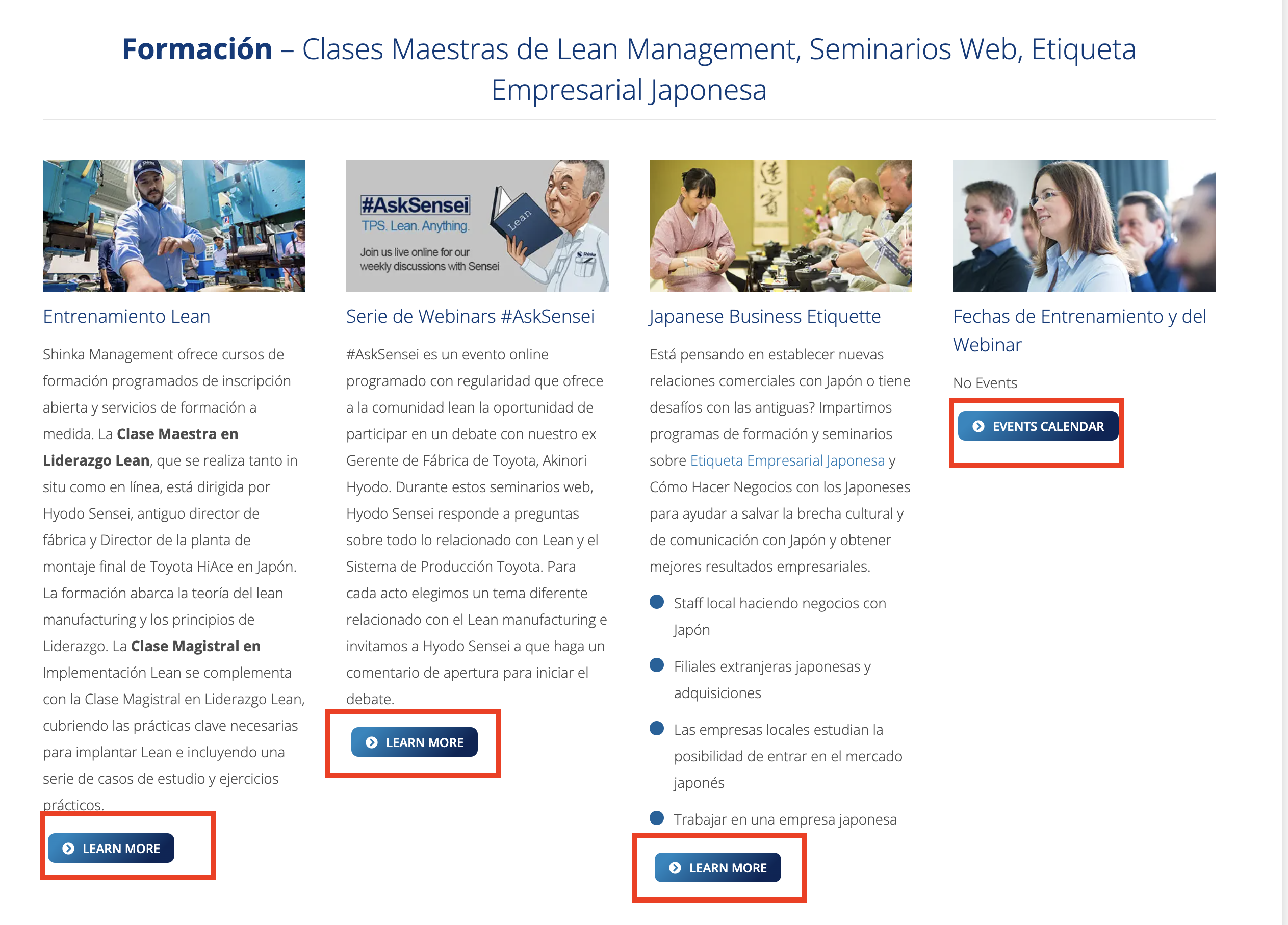

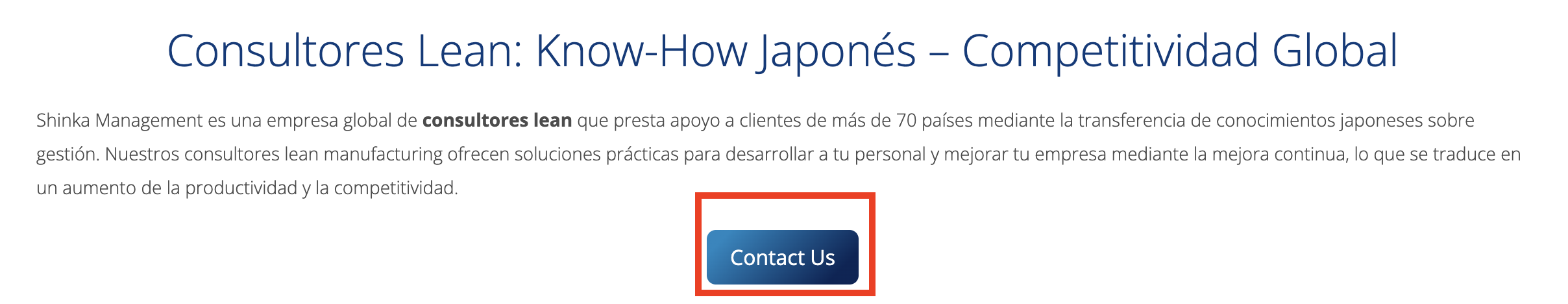

I am trying to translate strings on my site hidden link using WPML. I have already searched for them on the Translate texts in admin screens but I could not find them.
Strings are missing for translation.
Why are some strings missing for translation?
How can I find and translate these missing strings?

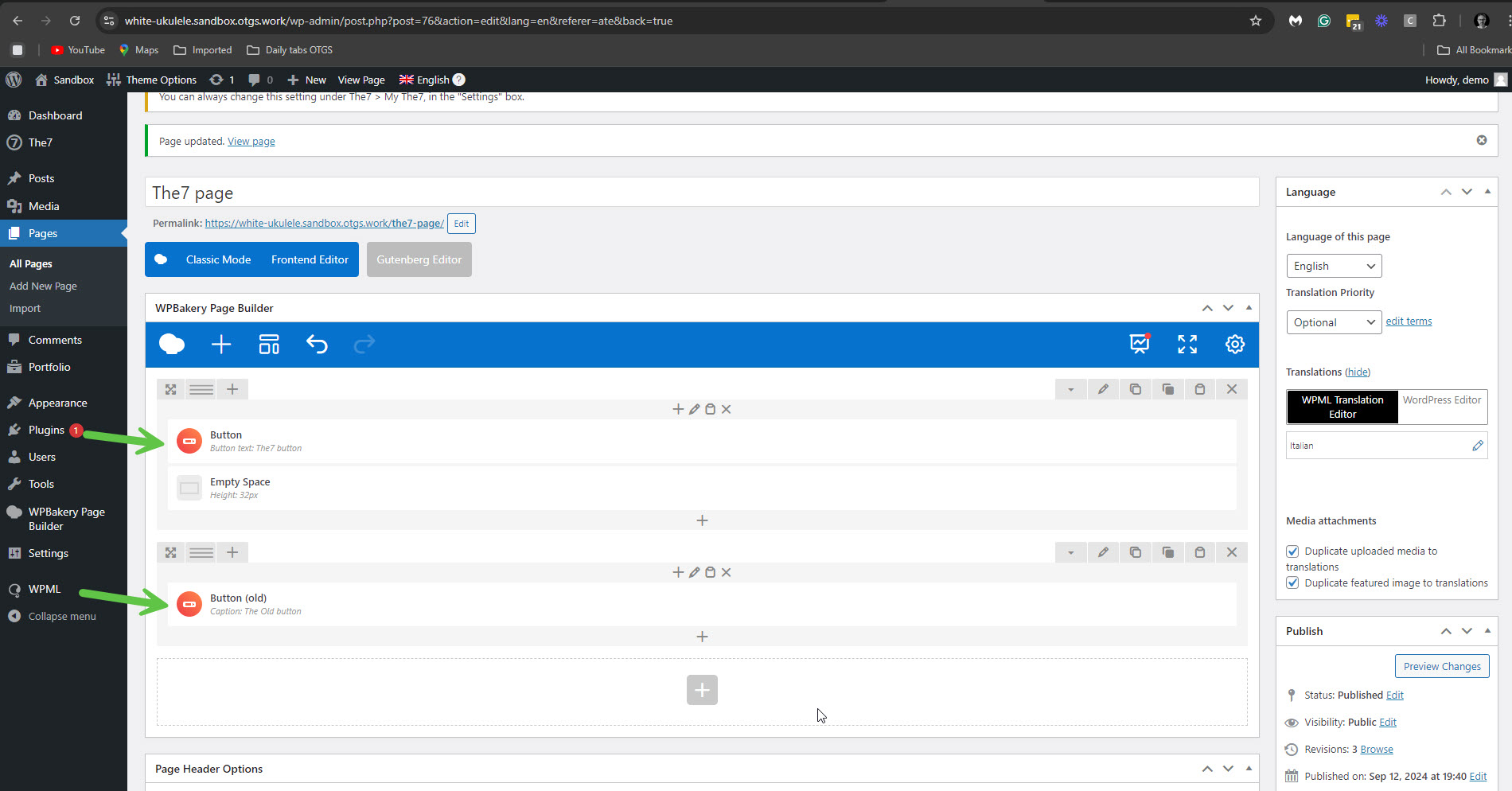

I could not replicate this issue on a test site with the The7 theme and WPBakery + The7 Elements responsible for the button element.

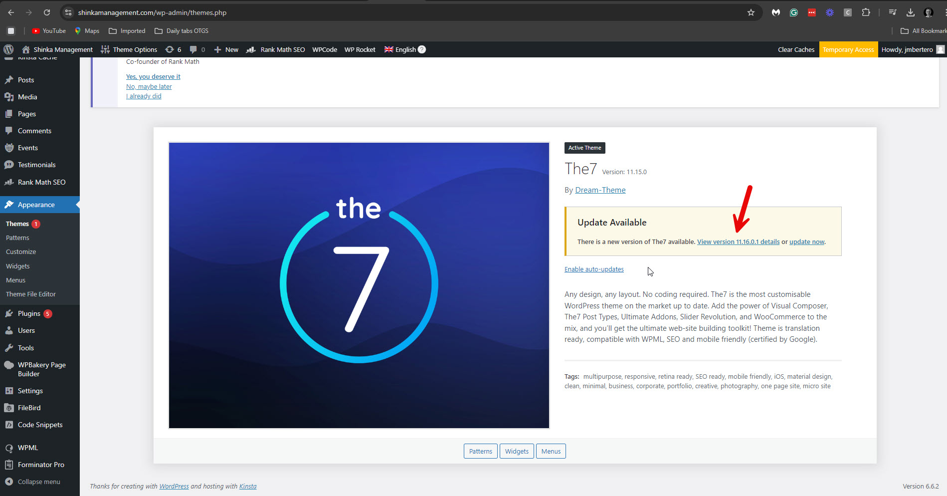

The7 theme on your site has not been updated to its latest version. Please see the attached screenshot.
Please update it to the latest version. Then please make a small change to the original page and update the translation. Check if you can now translate the buttons.

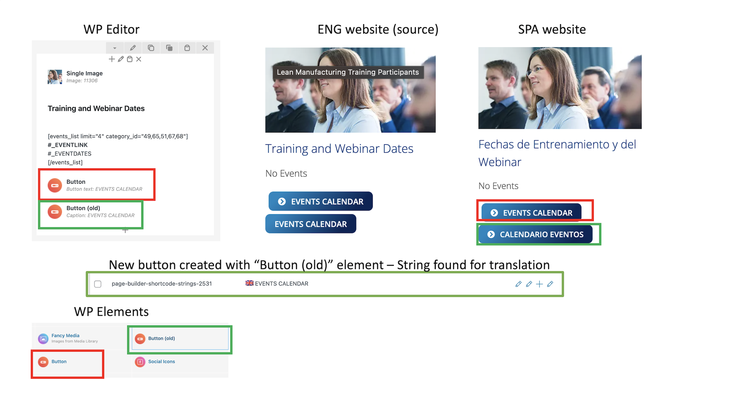

Unfortunately the problem persists.
I've discovered that the issue is with the "Button" element while when adding "Button (old)" element the strings register to be translated please see image attached.
Could you please explain the reason for this and suggest a solution?

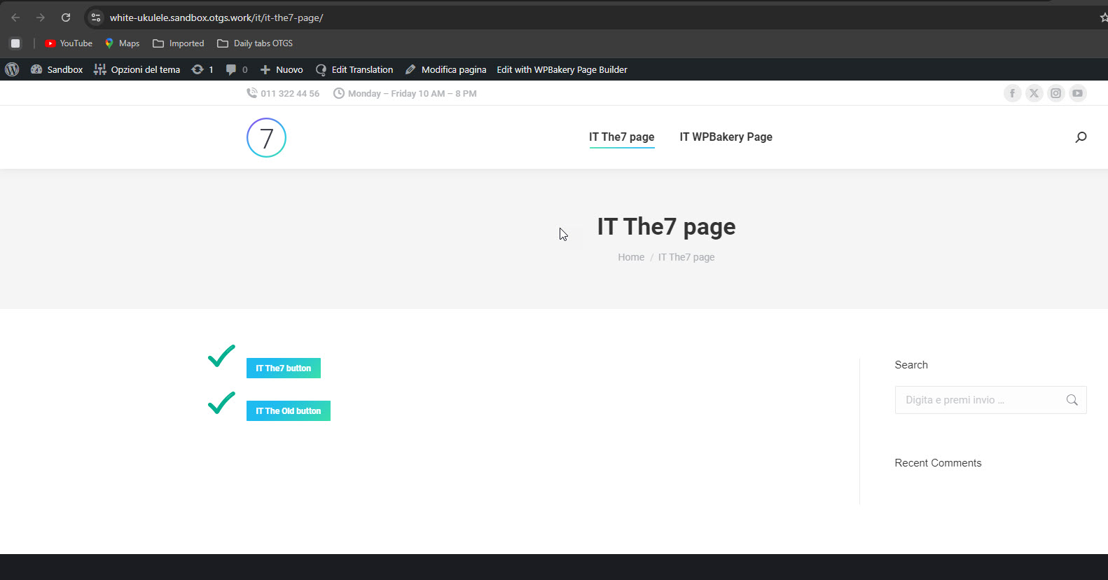

At this point, I have no explanation for this. I can translate the new and old button elements on my test site. Please see the attached screenshots. You can see the page here.
You can also check my test site by accessing it using this link.
My current solution is using the Button (old) element.
