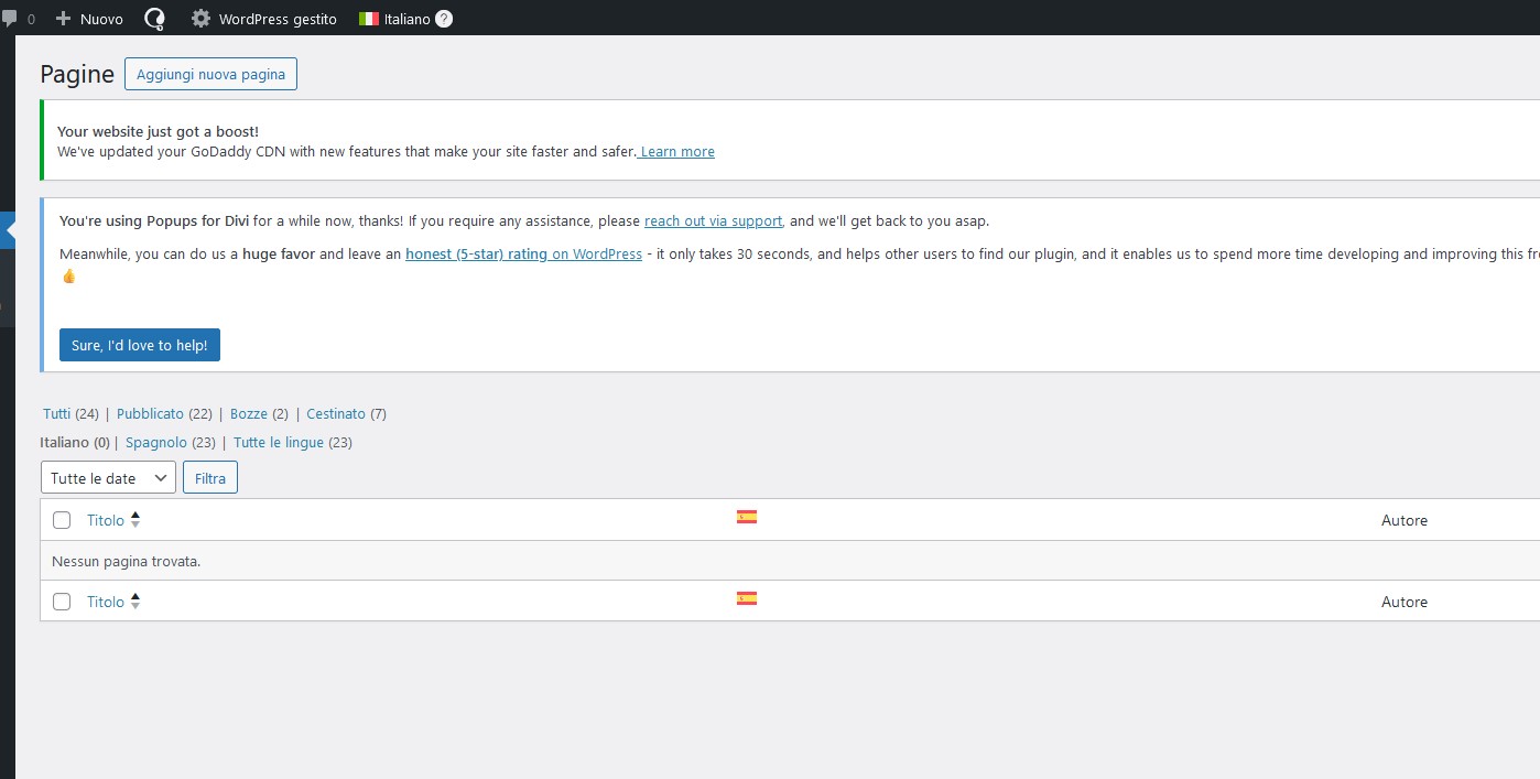

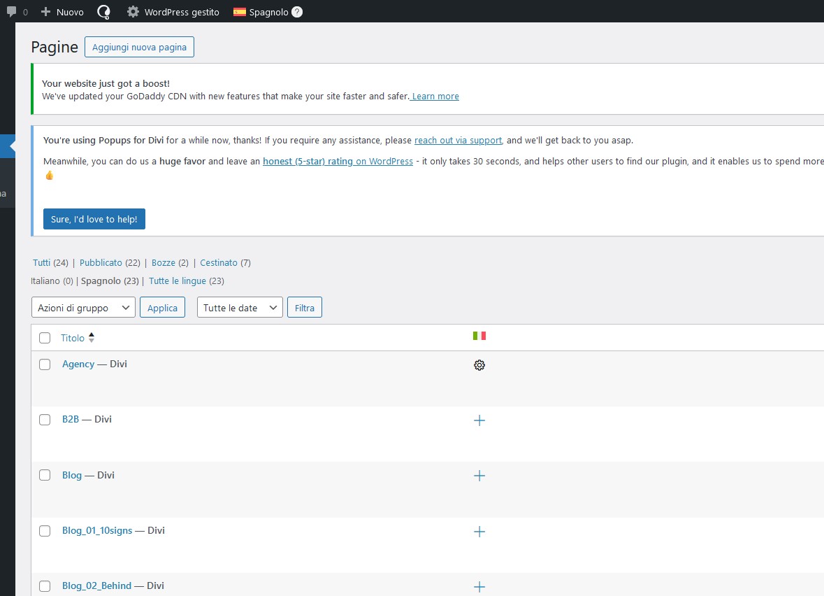

Hi good morning , I make a error in my first setup of wpml in one of my website
the error is setup the primary language in spanish , but I make the web in Italian , so now the Italian page are empty , but when I swithch in the worpress back end in spanish , that show all my page , but the page are in italian , do you can give some advice to solve that?
thank you advance.

If you want to reset WPML and start fresh completely, you can do so by following these steps:
1. Go to WPML → Support and click the Troubleshooting link.
2. In the Reset section of the Troubleshooting page, select the "I am about to reset all translation and language data" checkbox.
3. Click the "Reset and deactivate WPML" button.
Please note that it's recommended to backup your database before making any changes. Also, please be aware that resetting WPML will delete all translation and language data, so proceed cautiously.
Here's a link to the Troubleshooting page for your reference: https://wpml.org/documentation/getting-started-guide/language-setup/deleting-languages-and-plugin-data-by-doing-a-wpml-reset-on-your-site/#step-3-do-the-wpml-reset.
