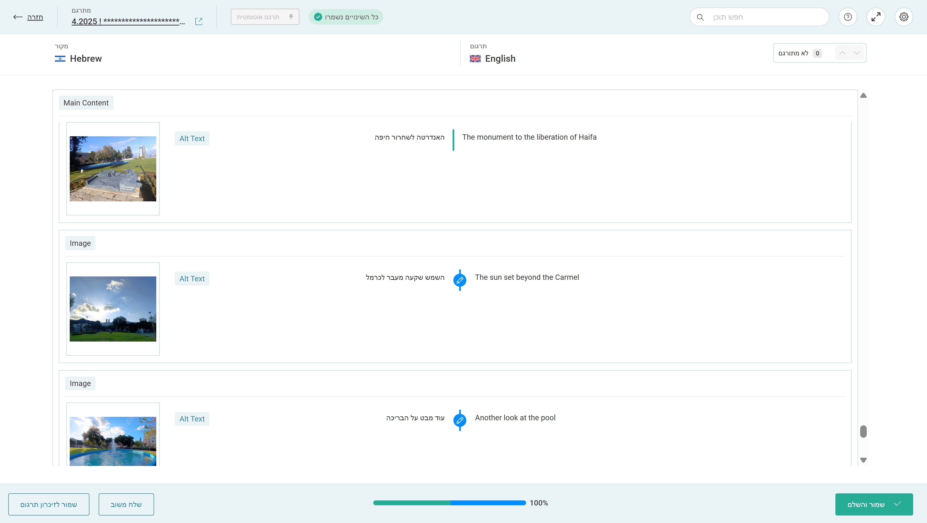

motiP

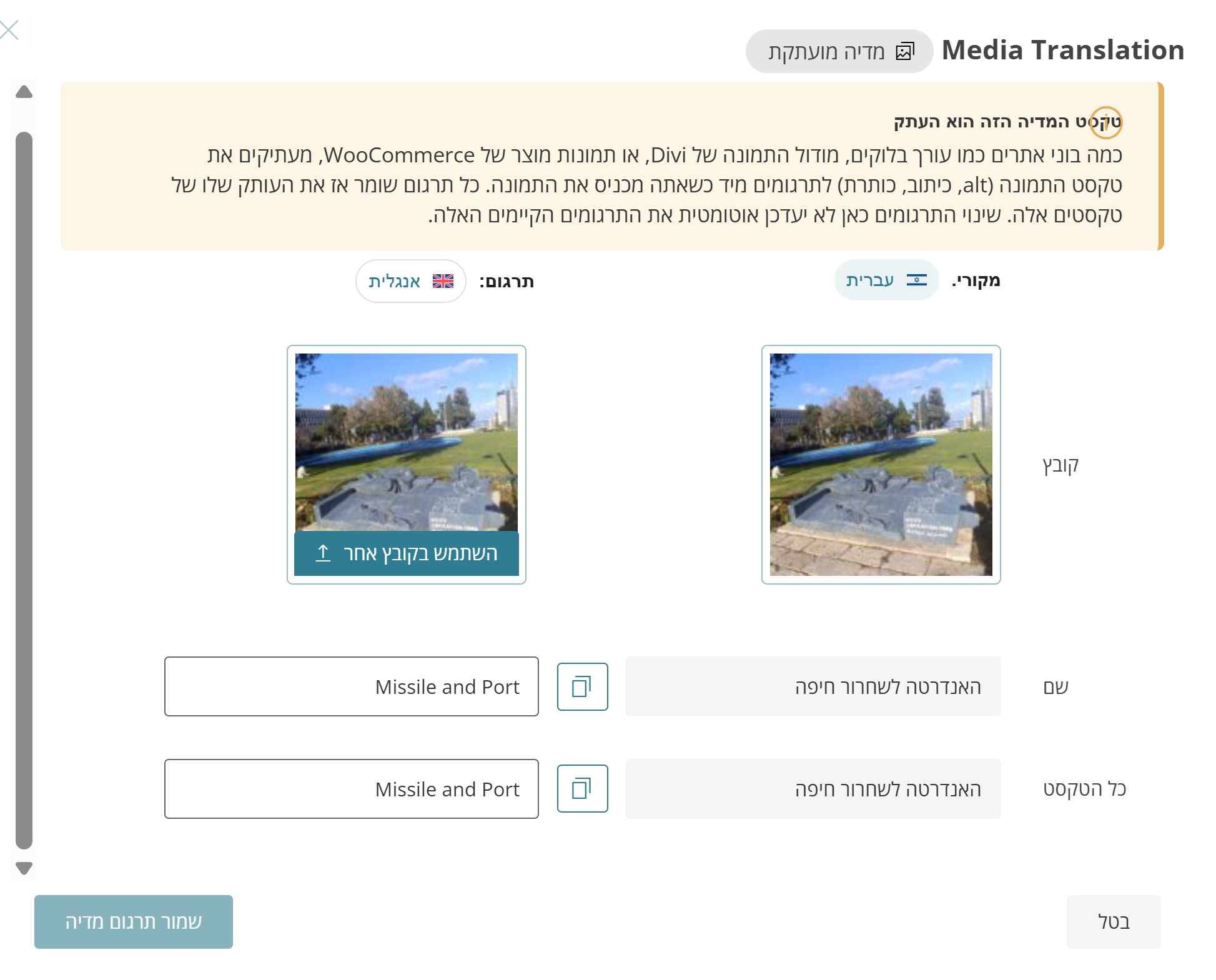

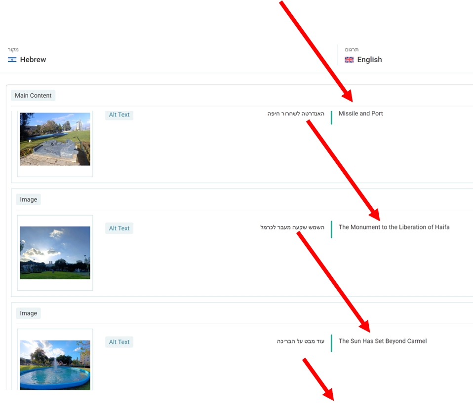

Hi, I had a bug concerning media translation when the translated text skipped to the next picture. I thought it was just a small amount of pictures but now I've found out it is in more than one. Apparently all came from the same dummy-page I was requested to put up (which is a very dummy method).
So now my question is how to re-translate a page, hoping this will work now?

January 10, 2026 at 6:15 pm #17718359
motiP

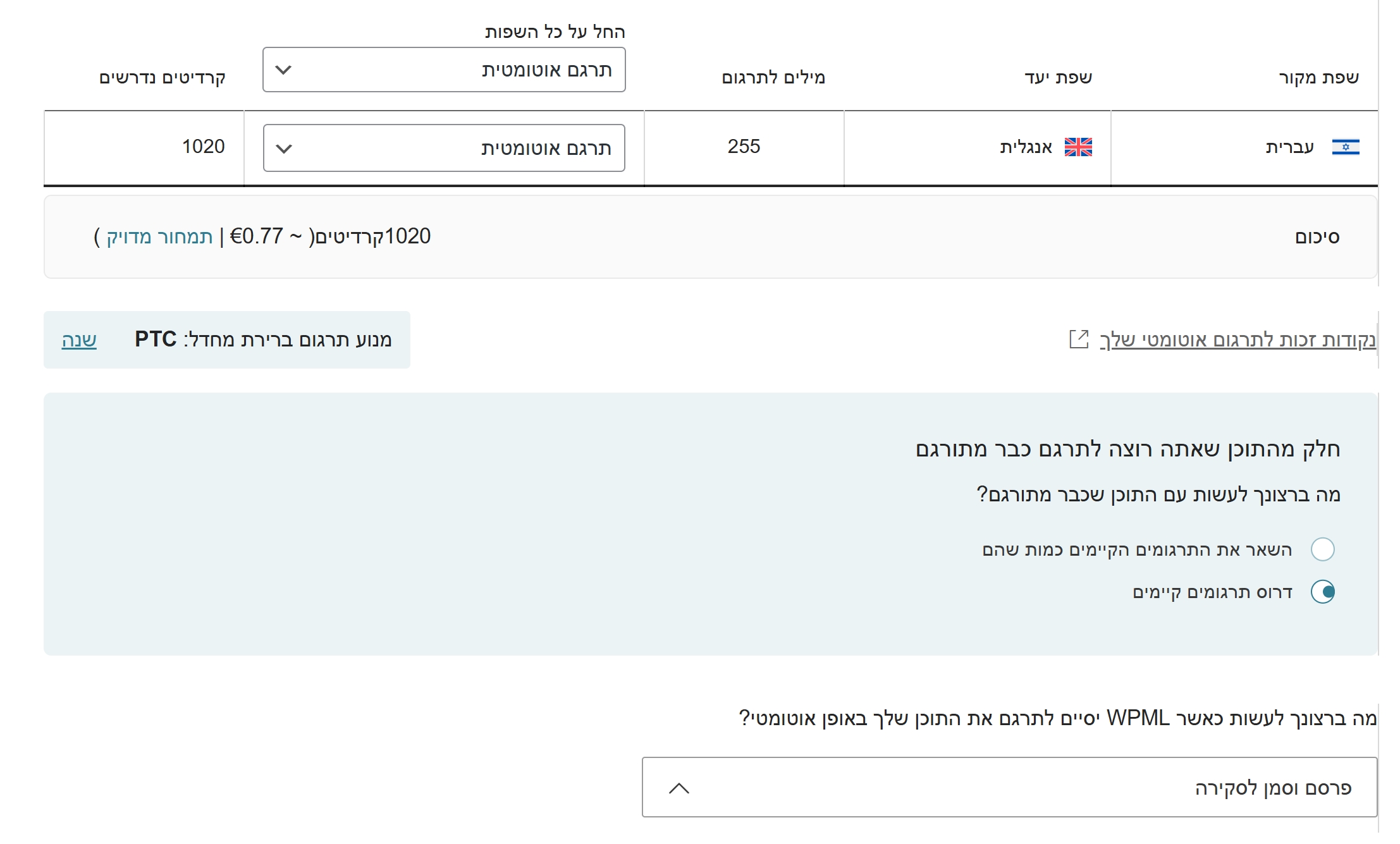

Update: I have found how to release the job, and I retranslated the dummy page containing all the pictures. It cost me 1020 credits (please reimburse this since this is due to your bug), and this time translated correctly, when I checked the translation (and approved it).

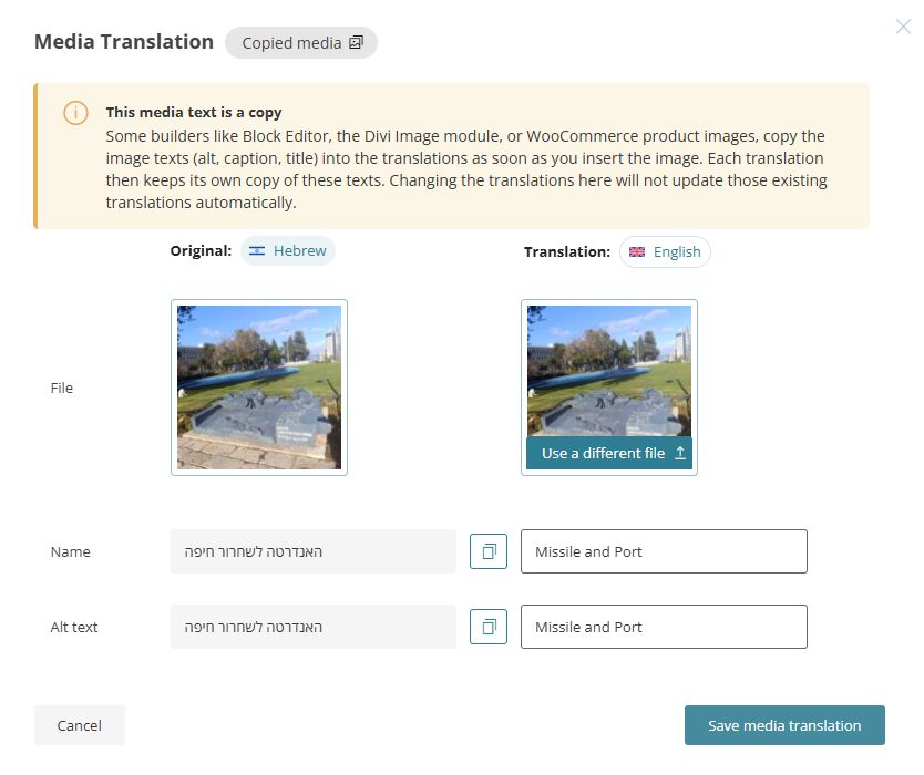

HOWEVER it did not pupulate to the pages that use the media.
Checking the media translation I get a weird message that it is "a copied media" with the old, buggy, WRONG translation, and the message says that the translation will not be used in the page.
So now what should I do???
See images attached.

January 13, 2026 at 5:10 pm #17726862
motiP
Hello Kor,
Please just help me fix the problem on my site. I'm not here to QA your bugs.
I only want to have correct translations on my media and I'm quite frustrated with this terribly cumbersome process, especially when you promise to translate everything automatically.
So there was a glitch, perhaps one of the pictures did not load properly in the translation, or it loaded just a fraction of a second after the translation process started. I don't really care as it was fixed as stated by re-translating, and I don't expect that bug to happen again.
THIS IS WHAT NEEDS TO BE FIXED:
There are several dozens of "copied media" with wrong translation. See image attached, I changed the interface to English for you.
I ask to get rid of these copied media, whatever it is and why I don't care, and get the correct translations to the media. That's all.
- Moti

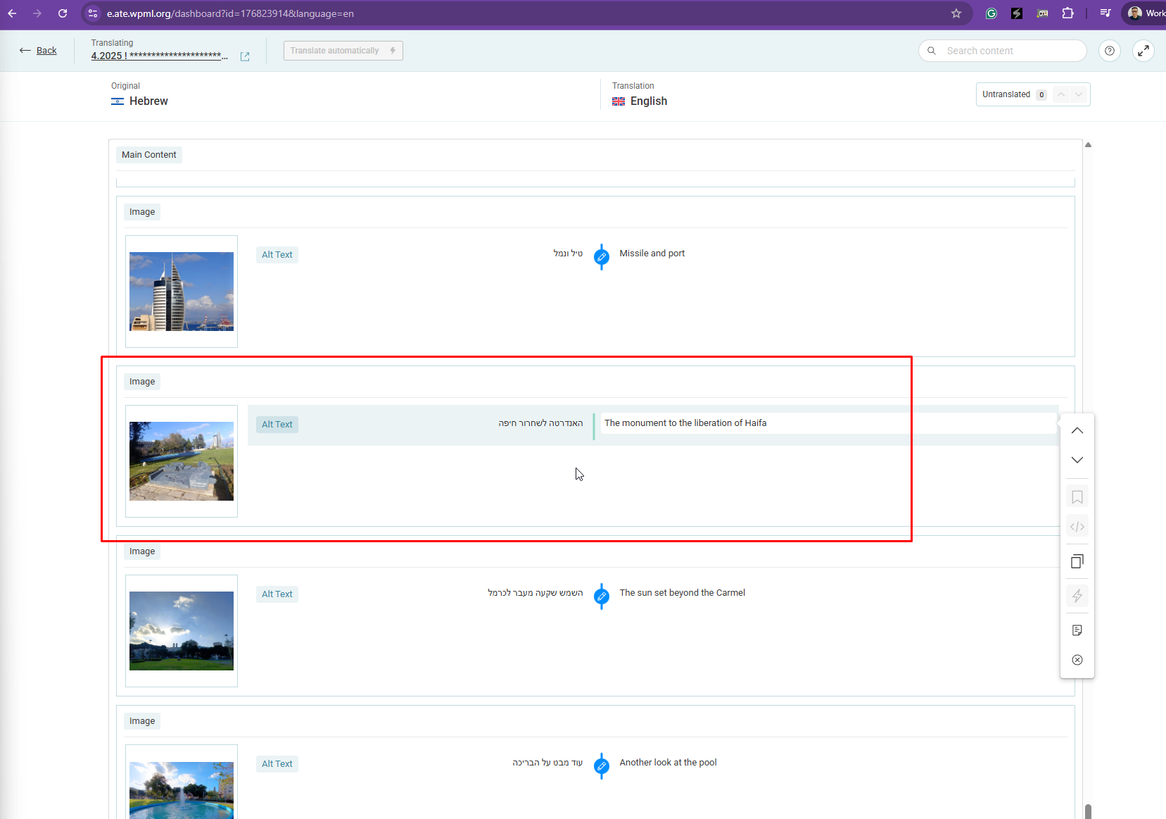

January 14, 2026 at 9:15 am #17728219
WPML Supporter since 08/2022
Thanks for your patience. For now, we’ll skip replicating the issue on our sandbox site, but I’ll need a bit more clarification to better understand what you’re experiencing.
From what I understand, you’re trying to ensure that your media translations are applied correctly, but the results are not as expected.
Let’s look at the example page you shared:
I’ve opened the Advanced Translation Editor and located the media Alt Text you mentioned, “האנדרטה לשחרור חיפה.” In the Advanced Translation Editor, this text is translated as “The monument to the liberation of Haifa” (see the screenshot labeled ATE).
However, in Media Translation, the same media item is translated as “Missile and Port” (see the screenshot labeled MT).
To confirm, are you expecting the media Alt Text translation shown in the Advanced Translation Editor to follow the translation you’ve set in Media Translation? Is this the discrepancy you’re trying to highlight?

January 14, 2026 at 2:52 pm #17729838

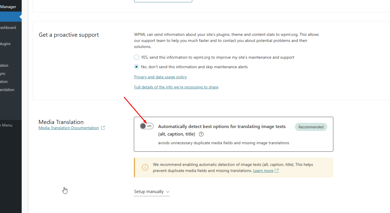

Thanks for your reply. The difference between connected and copied media isn’t something you can directly control, as it depends on how the theme or page builder handles media.
When media is shown as “copied media”, it means the page is using an image that was previously uploaded to the Media Library. In this case, you can only translate the media information (such as alt text or title) within the page itself.
When media is shown as “connected media”, it means the image was uploaded directly while editing the page. In this scenario, changing the media information in Media Translation will affect that media’s information across all languages.
If you prefer not to use this behavior, you can disable it in WPML > Settings > Media Translation, as shown in the attached screenshot.
January 14, 2026 at 7:49 pm #17731087
motiP
Hi Kor, sorry but this didn't work at all.
I turned off the option in the settings (it was on), but I still see the WRONG translation and the "copied media" message is still there at the media translate window (although not in the page anymore).
PLEASE HELP... How to turn off the "copied media" thing??? Just get inside my site and remove it.
- Moti
January 15, 2026 at 11:46 am #17732980
Thanks for your reply. It looks like disabling this option will not remove the “copied media” status from images that were already processed.
For images already marked as “Copied Media”, the only way to translate their information is by translating the Alt Text through the Advanced Translation Editor while translating the page, not via Media Translation.
Now that the “Automatically detect best options for translating image texts” option is turned off in WPML → Media Translation, newly added images will no longer be marked as “copied media.” Could you please test this by adding new images to a new page and let me know the result?
January 16, 2026 at 8:52 pm #17738435
motiP
Yes, now the bug is fixed, thanks.
All I needed to do is to approve the translation, didn't even need to add new images.
