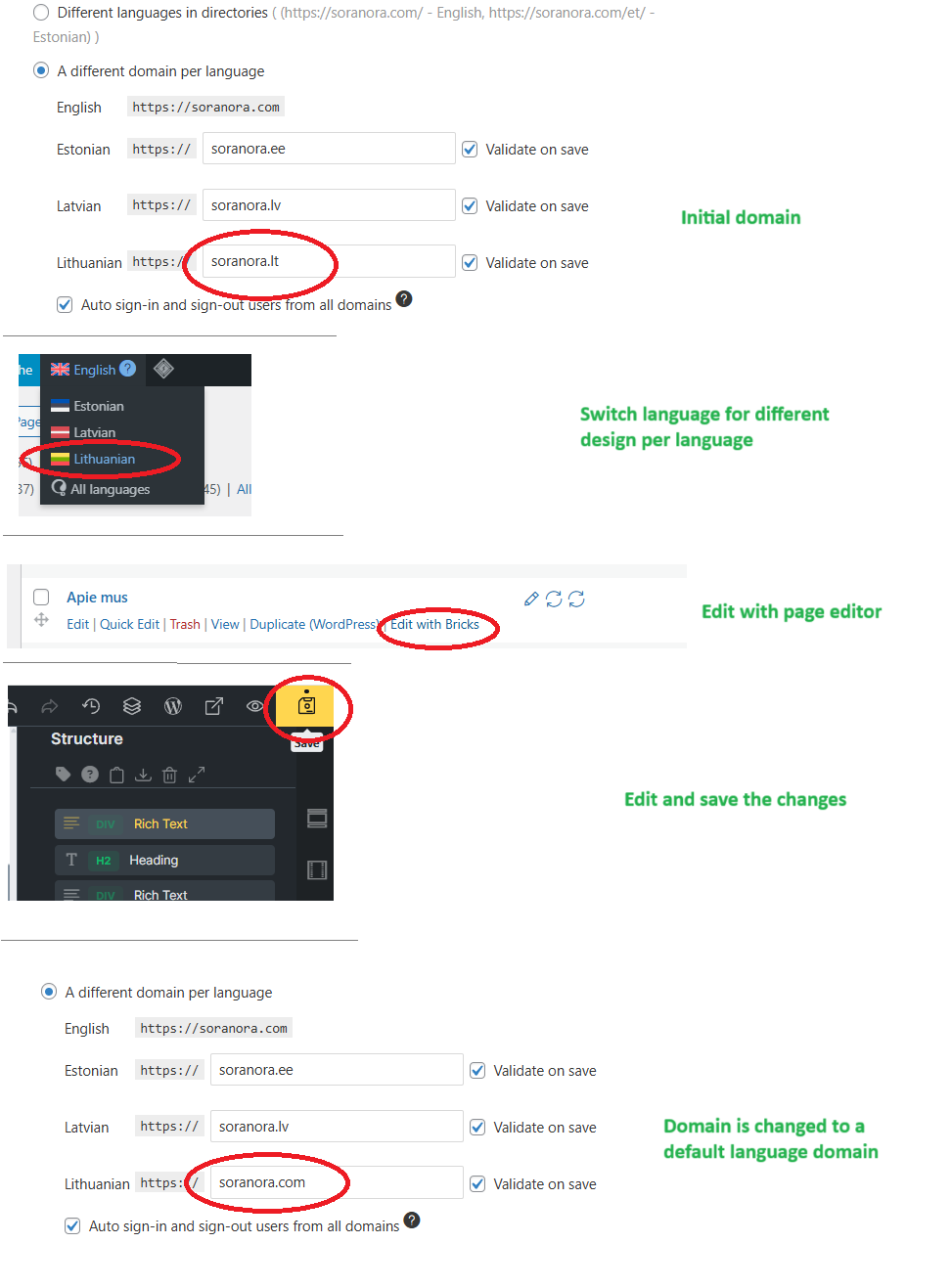

I was trying to maintain the correct language settings for my websites: soranora.com should be in English, and soranora.lt should be in Lithuanian. After updating WPML, the languages got mixed up. The issue can be seen at hidden link.
After the WPML update, soranora.com started showing Lithuanian language, and soranora.lt started showing English language. soranora.lv and soranora.ee have the correct languages.
Why did the languages switch after the WPML update?
How can I restore the correct language settings for soranora.com and soranora.lt?

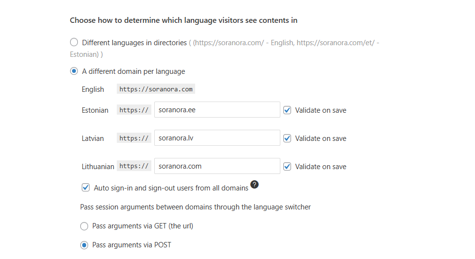

In settings domain for Lithuanian language became incorrect. After changing it back to normal soranora.lt, problem remains for home page.
If product page or archive is entered from there, then language is correct - Lithuanian. But home page is a problem.

Upgrade was done from 4.7.2 to 4.7.3 security fix. After it, last language in "domain per language setting" gets default domain name. Domain was replaced back to normal, site started to work again, but next day, last domain in a list was set to default domain again.
Now I have added one more language and domain to the list, to check if problem will remain and does the new domain at the end of the list will be set to default domain again.

Finally we have found how to replicate the problem. It happens when page is edited with a builder and not in a default language. After saving the page, the domain is switched to default one.
1. Go to WP Pages.
2. Switch default language (e.g. English) to another one (e.g. Lithuanian).
3. Choose to edit with not Gutenberg editor. (e.g. Edit with Bricks)
4. Make an edit, save page.
5. Language domain has been changed to a default.
