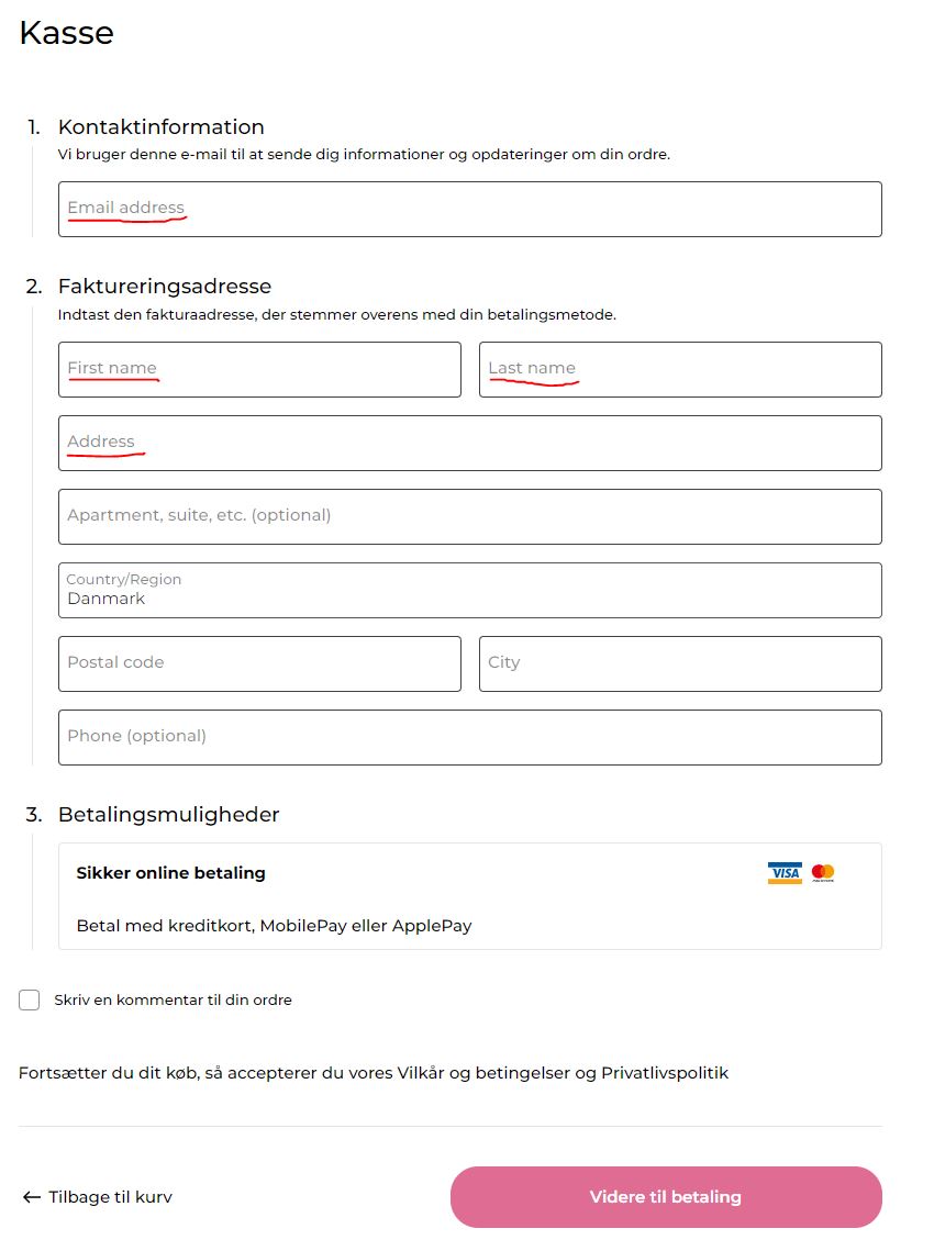

Default language is Danish and we have one additional language (English).
When WPML is activated the labels for the WooCommerce fields is in English but everything else is in Danish. Please see attached image.
How to solve this?
When WPML is deactivated the labels are in Danish as intended.

Just increased WP Memory limit to 256M and confirmed the settings under WPML -> Support
I have checked through all strings for WooCommerce, Gutenberg (used for the checkout page) and Divi and all English strings are assigned to the correct source language.
So the issue is unsolved.
When I browse the checkout page from a signed in user which uses the Danish language, the labels on the checkout page is correctly displayed in Danish.
So the issue is only shown for non logged in users.
Br
Jacob

May 16, 2024 at 8:35 pm #15637075
alexanderO-11
Hi again,
Thanks! I changed the blocks on cart and checkout to the classic view (using shortcodes) and that solved the issue regarding the translations.

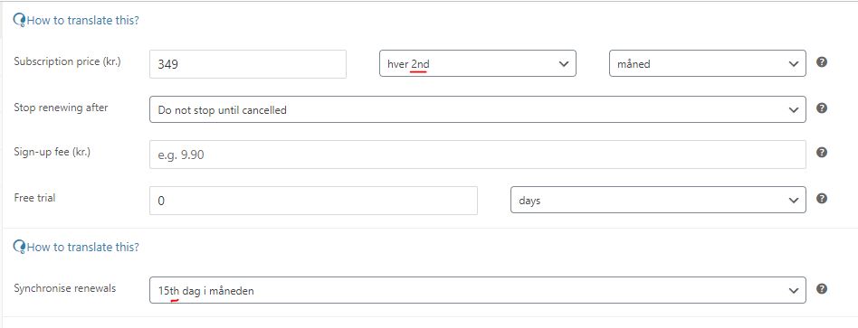

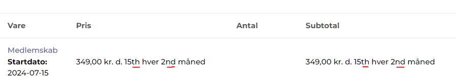

One other question regarding WooCommerce Subscriptions:
How can I translate or change the format of the syncronized date renewal.
In English terms it would be e.g. "xx$ the 15th every 2nd month."
In Danish that would translate to "xx kr. d. 15. hver 2. måned."
So I have to change "15th" and "2nd" to "15." and "2.".
I just can't figure out how to do it. Do you have any ideas? 🙂

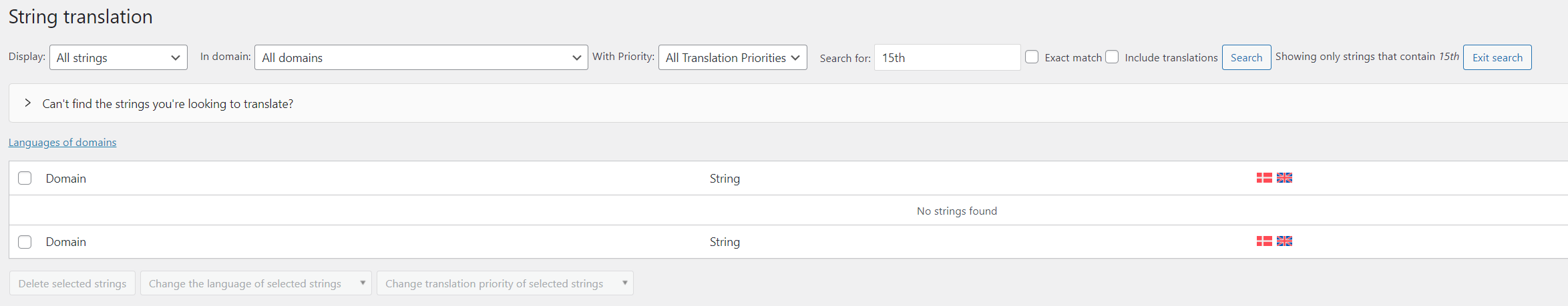

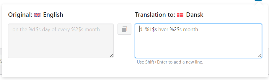

May 17, 2024 at 8:13 am #15637903
alexanderO-11
Please see attached for already translated string. The problem is that "15th" and "2nd" are dynamic values and therefore inserted by these tags: "%1$s" and "%2$s" so it's not possible to translate the "th" and "nd" parts.
I have scanned WooCommerce Subscriptions several times for strings and can't fint "15th and "2nd". Please see attached screenshot where I try to search for "15th" in all text domains. 🙂
May 17, 2024 at 1:59 pm #15639967

May 23, 2024 at 1:08 am #15659966
The strings that you are trying to translate are coming from this function:
\wp-content\plugins\woocommerce-subscriptions\vendor\woocommerce\subscriptions-core\includes\wcs-formatting-functions.php line 291
function wcs_append_numeral_suffix( $number ) {
	// Handle teens: if the tens digit of a number is 1, then write "th" after the number. For example: 11th, 13th, 19th, 112th, 9311th. <em><u>hidden link</u></em>
	if ( strlen( $number ) > 1 && 1 == substr( $number, -2, 1 ) ) {
		// translators: placeholder is a number, this is for the teens
		$number_string = sprintf( __( '%sth', 'woocommerce-subscriptions' ), $number );
	} else { // Append relevant suffix
		switch ( substr( $number, -1 ) ) {
			case 1:
				// translators: placeholder is a number, numbers ending in 1
				$number_string = sprintf( __( '%sst', 'woocommerce-subscriptions' ), $number );
				break;
			case 2:
				// translators: placeholder is a number, numbers ending in 2
				$number_string = sprintf( __( '%snd', 'woocommerce-subscriptions' ), $number );
				break;
			case 3:
				// translators: placeholder is a number, numbers ending in 3
				$number_string = sprintf( __( '%srd', 'woocommerce-subscriptions' ), $number );
				break;
			default:
				// translators: placeholder is a number, numbers ending in 4-9, 0
				break;
	return apply_filters( 'woocommerce_numeral_suffix', $number_string, $number );
This means:
The string as example for 1st would be "%sst".
The string as example for 2nd would be "%snd".
The string as example for 3rd would be "%srd".
The strings as example for 15th would be "%sth".
You need to search those strings and translate them with String Translation.
Please give this a try and let me know the results.
