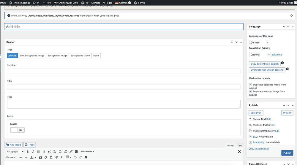

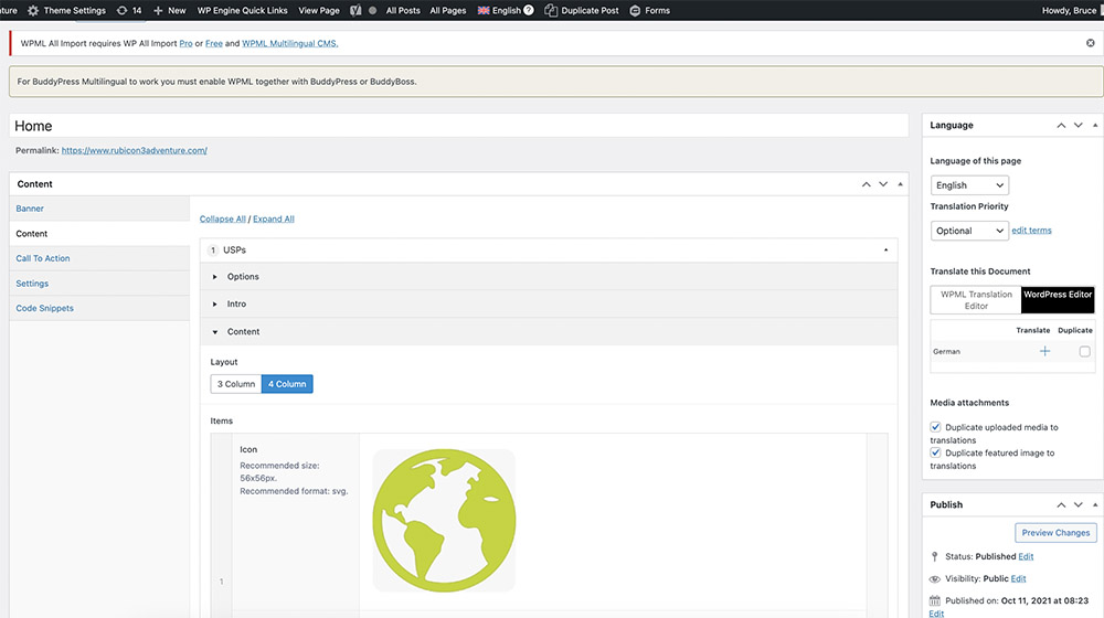

Hi I have sorted the memory issue.
The issue we are facing is that most of the page does not seem to appear in the back end once we switch to German. Please see screenshots. Its as if WPML is not 'seeing' the content?

Have you tried clicking the "+" icon instead of switching to translate the page?
https://wpml.org/documentation/getting-started-guide/#fully-flexible-translating-with-the-plus-icons
How did you create the content for your homepage? Are these custom fields? If yes, I recommend following this article carefully: https://wpml.org/documentation/related-projects/translate-sites-built-with-acf/.
